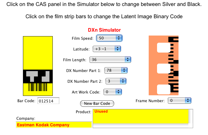

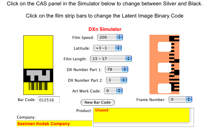

Print them out and paste them on the film cassettes. I just printed one for ISO 50 36 Exp and ISO 200 36 Exp
Follow the links on Post #5 to find where you can purchase the foil.
