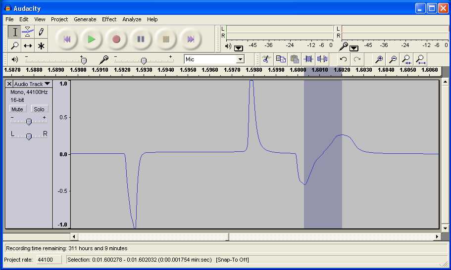

Is shutter bounce a known reality or is it just a bit of mythology?
I can't really see how a leaf shutter could open again before closing.
Steve.
Imagine two cars going at very high speed against each other frontally. When they crash, at least one of those will bounce backward. A physician, which I am not, could maybe say that they bounce when the kinetic energy they have is superior to the one which can be absorbed by the deformation of the other car.
In the case of the shutter it could be a bit like a window which is banged by an air current against the frame. Although the energy is impressed only in one direction, toward the frame, the window will "bounce" on the frame.
Now imagine a spring impressing a motion on the window. The window will reach a certain speed, bang on the frame, and if the spring (in extended position) is not strong enough, the window will bounce back, immediately after the spring will push it again against the frame.
Another example would be a marble ball "bouncing" over a marble floor although marble is not elastic.

Shutter bounce. The 'nose' under the numbers shows a faint double image also, demonstrating that it is not only the number plate showing the effect. It is true that the number plate was not present on the locomotive in 2003, but I suspect it would have fallen off by now if not bolted down tight :smile:
Here is an example of shutter bounce. You can see how this second shutter opening would make the second faint image of the numbers:
Read more about it here Dead Link Removed
