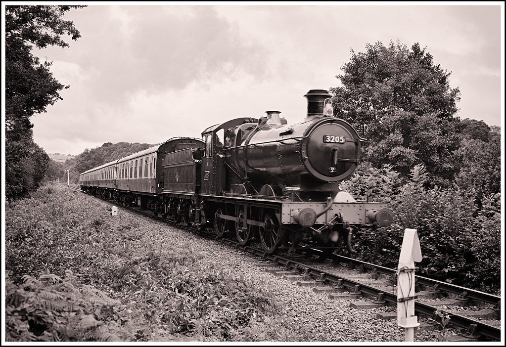

Okay, this is weird. I was processing another of my recent South Devon Railway images and I realised that the front of the locomotive is not as sharp as I would have expected.

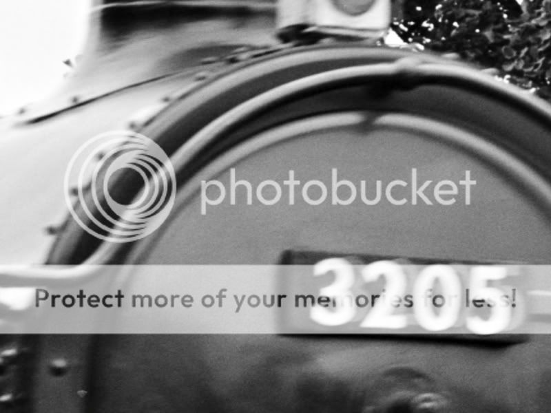

The image was shot on 5x7 film using a 210mm Apo-Symmar lens at 1/250th sec at f11 on HP5+ film, now I would have expected a sharper image than that recorded, but when I started working on the image in Photoshop CS5 I noticed that the number on the front of the engine was a distinct double image, but nowhere else showed a similar double image, this is not a blurred image such as would normally be expected from too slow a shutter speed. The film was processed in Pyrocat HD for 8 ins at 24 degrees C with a TF-3 alkaline fix. The image was scanned on my Epson V750 scanner with the better scanning film holder. I have checked the negative on a lightbox with an 8x lupe and it is definitely a double image on the negative!

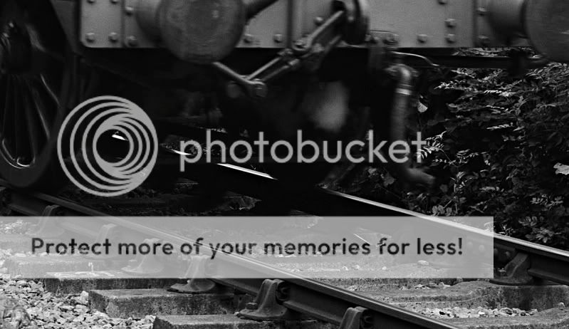

Full Image: focus was on the sleeper 8 up from the trackside marker as can be seen in the third image:
SDR: 3205 GWR Collett 0-6-0 5x7 by Ed Bray, on Flickr
Second image, the locomotive's number at 100% crop
Third image: Focus point on 8th sleeper from tackside marker, sleeper marked 631.
Don't answer that!
It's quite a light locomotive (relatively!) so it is possible that it moved sideways slightly whilst the shutter was open.
Although it hasn't quite reached the fishplate join in the tracks which could jolt it over a bit.

That's a possibility although I would have expected a blur between the 2 sets of numbers. Thanks Steve.
Was the number that was painted on the plate repainted but not in the same registration?

Looking at it again, there is nothing else around the smokebox door with the same amount of movement showing. This leads me to think that perhaps the number plate is not permanently fixed but is just dropped onto a couple of brackets and only that moved.

I'm with jeffreyg on this where the numbers may have been painted twice. The original numbers were off-center and perhaps they simply repainted numbers 3205 to center them on the number plate.
If it's a matter of the number plate moving, then the whole number plate would be doubled, too. Not just the numbers.

I agree there definitely is blur involved here but why are there two distinct sets of numbers? Blurry as they are.

Very curious - some places are sharp and others not. I notice some lack of sharpness in the foliage on the left as well, and I wonder if it might be the same thing. The number plate shows two distinct, sharp images, which pretty mush rules out motion blur. A reflection is one possibility. Another is that the film was not perfectly flat in the holder, and it "popped" during the exposure.

Got it. faint image is what is recorded during the shutter close to full open time. The darker, more neg density, image is what is recorded during the full open part of the exposure which is longer. Leaf shutters have three components, close to open, open, then open to close. Depending on shutter speed, these three components are different percentages of the shutter speed. The dark areas have too little intensity to record during the opening and closing phases.
Changed my mind, the faint image was during the closing phase when there was enough "pre-exposure" to partially excite the silver.
