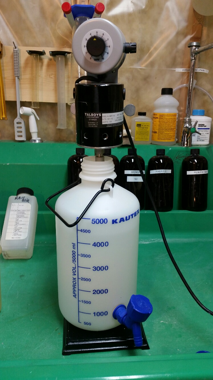

I love powder. Back in the day people had lightning mixers etc. Ignore the bottle, I picked up this propeller mixer, variable speed, I have a couple 4 liter 304 SS "graduated vessel with handle " . Works great, I can rev it up to get everything moving then, slow down as not to entrain air. I buy Kodak rapid fix, everything else is powder . XTOL, Bromophen, Kodak Hypo Clear .
It's very satisfying :cool: This is how "The Dude Abides" :smile:
