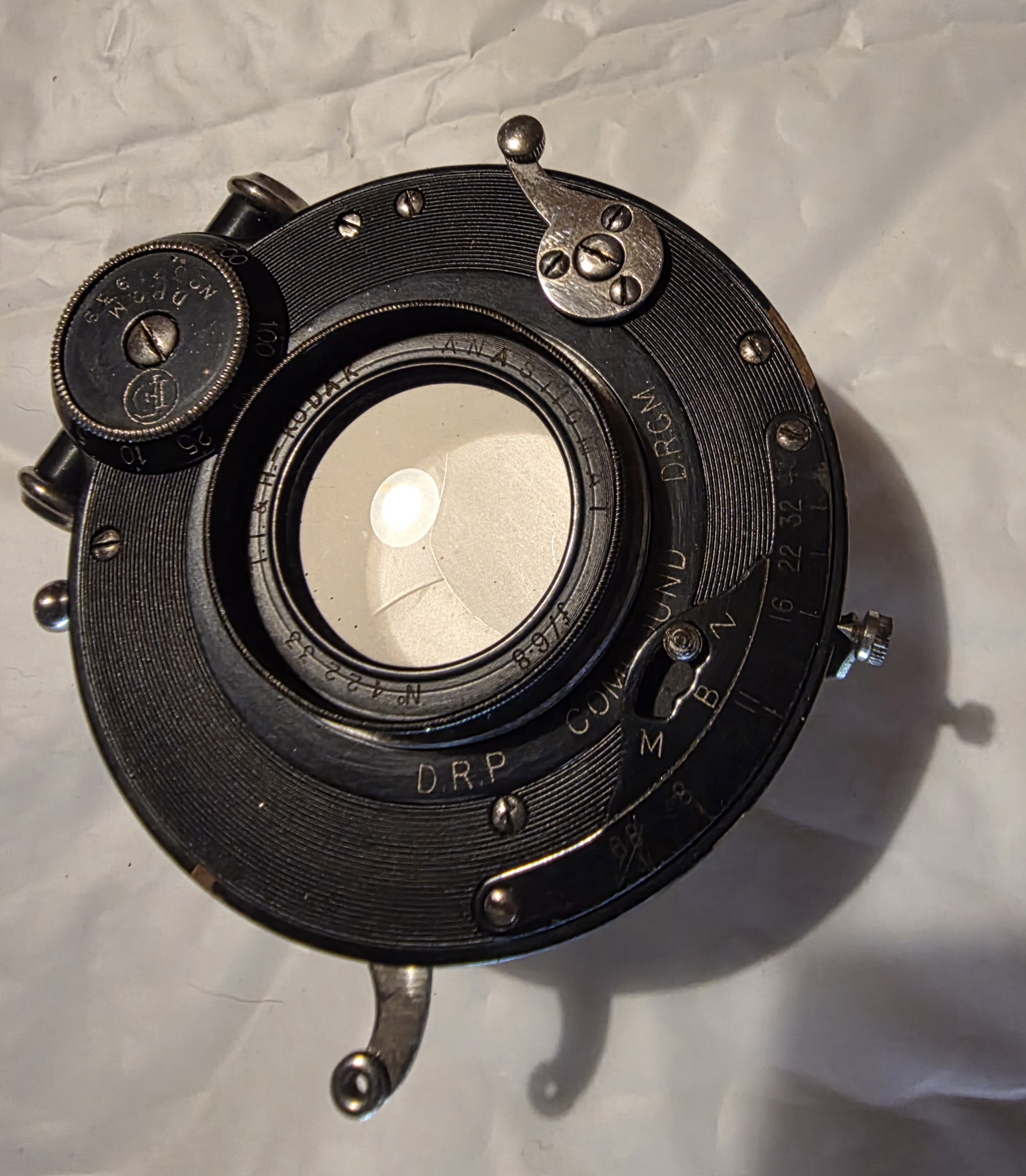

TTH Cooke series III f/6.5 triplet (branded as TTH Kodak Anastigmat) was released shuttered as 6.8.
150mm.
Same guess - most probably due to shutter mounting limitations.
Good performer closed down.
