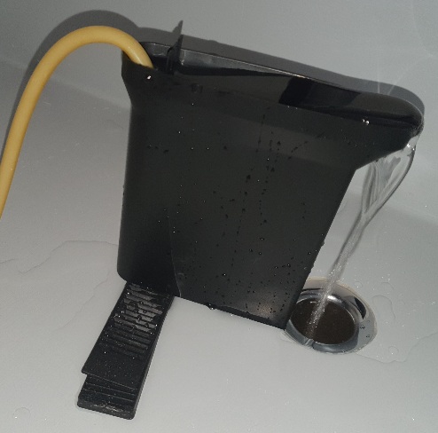

Thanks for all the input. I initially liked the Jobo because I thought it's capacity was what was stated at B&H, but I grossly misunderstood it. My apologies to Mr. Heisz. So the one thing that is going for SP445 is the lower 16 ounce capacity that will develop 4 sheets, I like that part. I really dislike the wash recommendation of fill and dump, fill and dump, fill and dump etc... I worked around that with this, flexible tubing placed all the way to the bottom of the tank.
I can't explain it, it's just an awkward tank to me....however, I'm beginning to realize it is probably the best option for me at this time and I need to quit arguing with it, so to speak.
I don't see any reason an Ilford wash wouldn't work with the SP-445. Fill, 5 inversions, dump; fill, 10 inversions, dump; fill, 20 inversions, dump, and you've washed with only (in this case) three pints of water, plus one for PhotoFlo...
The flow you see there is higher for purposes of the photo. The flow rate for actual washing is much slower. I may use more than you mention but that's how I do it.
