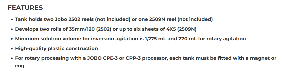

The Multitank2 - 2520 holds 270 ml or 9 ounces.
That's the minimum:

I may have apologised for myself too quickly......the description I read from B&H does not differentiate between volumes from with rotary versus inversion agitation. But glad to see your description as well.

That's the minimum
Thanks Don, I understand it's the minimum now.....B&Hs description makes it sound like that's the maximum. I corrected my earlier statement about a typo.
