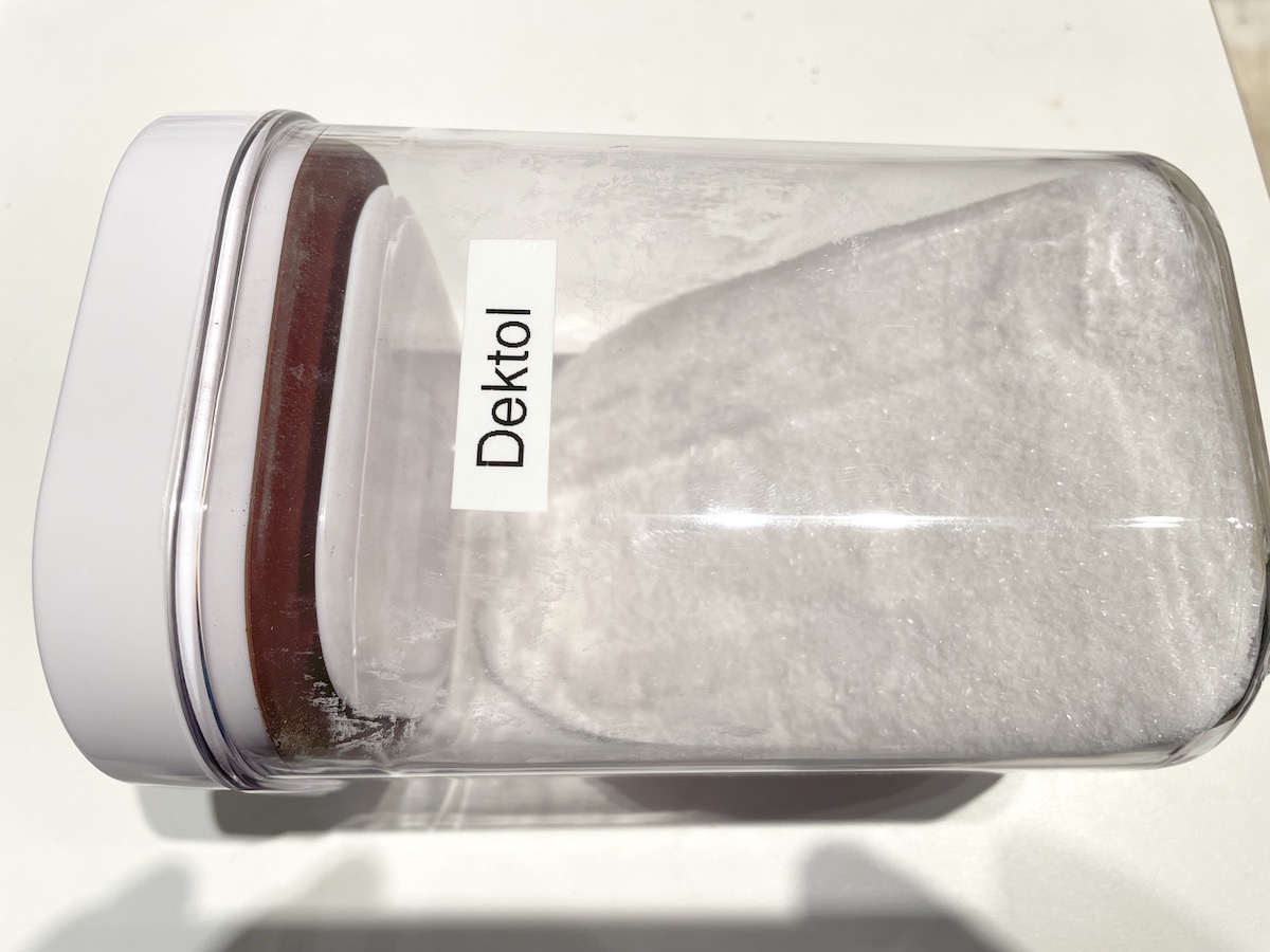

Without reading the prior posts, the idea is to see if the Dektol lasts longer by not mixing it with water all at once and storing the remains of the open package in a vacuum container.
First batch is a fail.
Turns out both the Dektol in my vacuum container and Dektol in an UN OPENED bag turned black. I tried both and they mixed to an dark opaque liquid that stained the prints.
I threw all that out and have a new bag of Dektol that looks different and the crystals are pure white. I put that in my vacuum container now.
I'm not surprised. The only way I will buy Dektol anymore is off eBay or etsy. That old stuff has always been good, like aged wine. The new stuff....after 2 corked batches, never again.
Most people will say that scooping it out of the bag or can for one shot development isn't a good idea, but I've seen posts where they stated that they had no issues. Like most things in life, the best way is to just try it and see what happens.
The New bag of white Dektol came from BH and i was under the impression the 'brown Dektol' issue has been resolved. Interested in other's experiences with this.

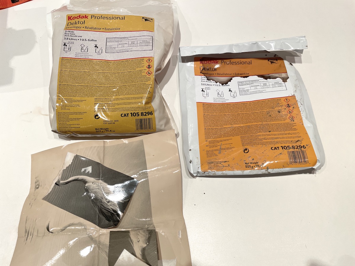

To clarify, the Dektol stored in my vacuum container turned brown, mixed up black and turned the prints brown. So I opened a sealed (but expired) package and it did the exact same!
I realized I should show these, so I dug them out of the garbage.
Right hand is Dektol that expired 2020 and was pure black when I mixed it. It turned the prints brown.
Left hand is new Dektol from B&H. It's crystals are pure white.
The print is fixed by the way. The brown is from the Dektol.
