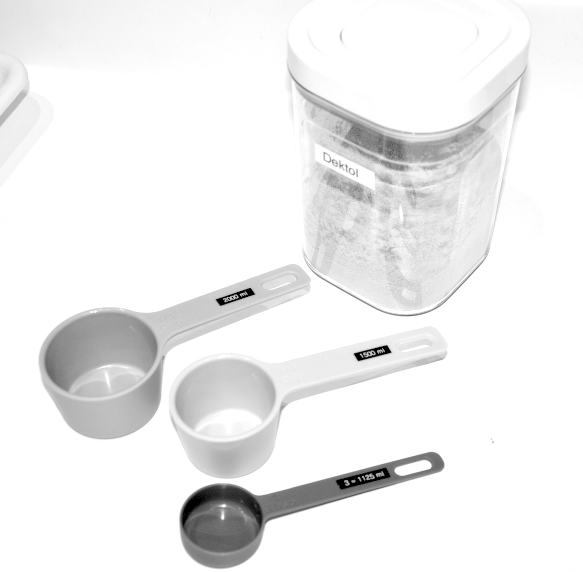

I just calculated my measuring spoons capacities and I'll be trying this out tonight with a printing session.
My most common batch I used to make was 1000ml but there is no easy way to get that with these sophisticated Avoirdupois devices available from the wife's kitchen...
