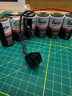

Norman uses EnerSys lead acid batteries. The company is still in business. You can contact them for prices. And, if you can solder and desolder, then you can remove the connector from your old battery pack and connect the six 2 volt 2.5 Ah batteries in serial, connect the old connector and you are good to go. I haven’t needed to yet, but will when the day comes.
