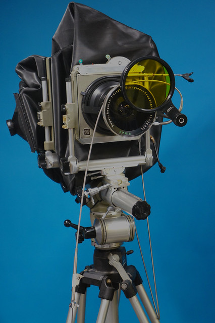

Here's my 90% restored 5x7 Sinar Norma. Notice the Norma Tilt Head, it is an integral part of the Norma overall design. In other words it completes the camera.

5x7 Norma Ready to Go Norma 165 Sup Ang by Nokton48, on Flickr
