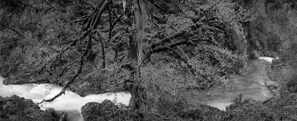

Image made with Noblex 150U. Añisclo Canyon in Ordesa National Park, Pyrenees in Aragón. Ilford XP2 film, one second at f/22.
The actual distance from the far left side of this image to the far right side is about 100 yards. The camera is about two meters from the center tree, which is a very large beech.
