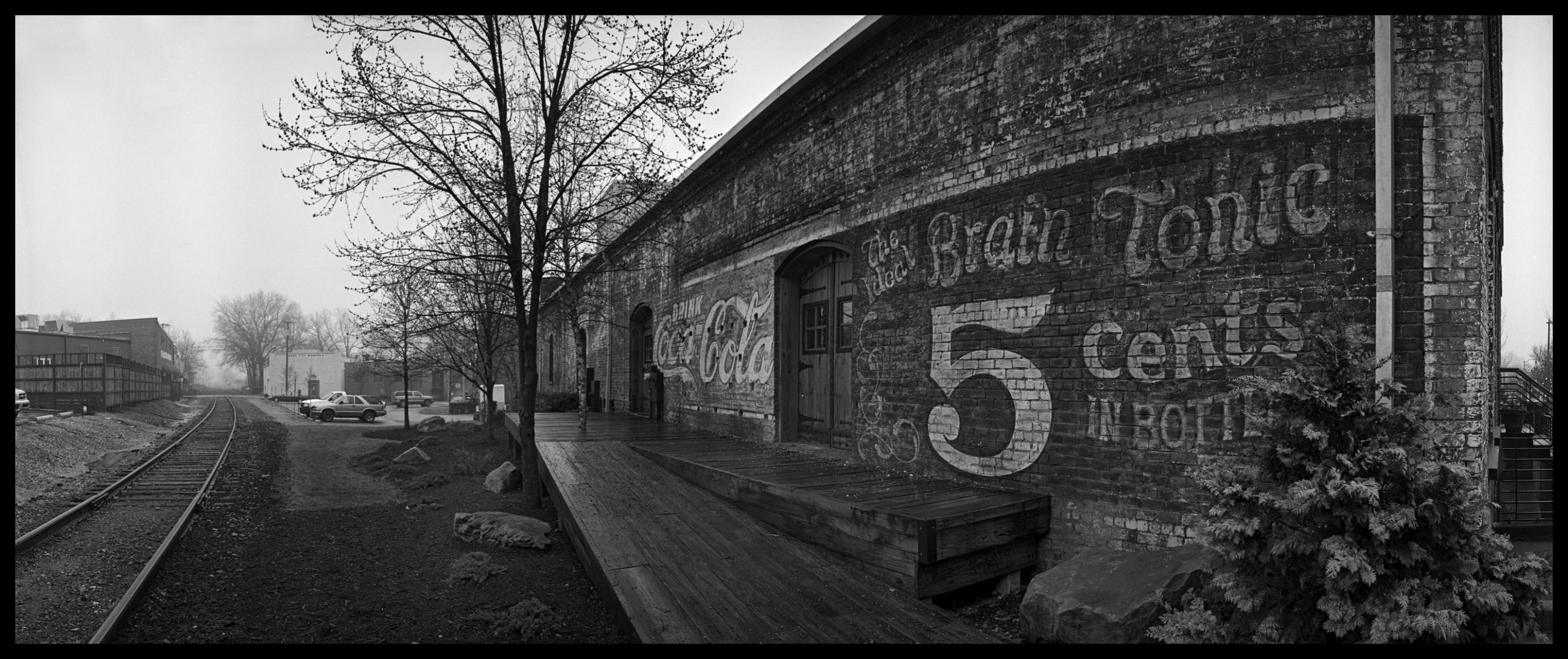

Attached is one of my first negatives made with the Noblex 6/150 U. This is straight from the scanner except for the frame.
Fuji Acros, two seconds at f/11. Developed in Pyrocat-HD 1:1:100, 20 minutes at 70F, with minimal agitation. Subject was low contrast so N+ development was required.
The subject was in downtown Greenville, SC, about five minutes by car from my home.
Sandy King

Looks like you're off to a good start. Nice pano subject!
I agree with David and it looks particularly good when the extreme right wall and the power pole, are in perfect vertical alignment.
Mick.
Hey, that's a sweet photo from your new Noblex! I took a workshop with Macduff Everton a few years ago, and he shared a tip with the class - if you're using a Noblex, you can buy a small bullseye bubble level and secure it to the top front of the camera with silicone caulk, so it's visible when looking through the viewfinder. The level included in the camera viewfinder itself is only for one axis, and you'll need both axes level in order to have completely level horizons.
Thanks for posting that image Sandy, it's interesting to see how the perspective changes which works well in this particular image. Hopefully we'll see some more images shot with it.
Ian

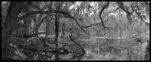

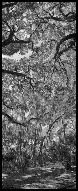

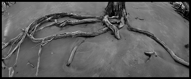

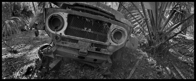

Here are a few snaps from my use of the Noblex on Ossabaw. These are just quick scans with a minimum of adjustment for showing here. No prints from any of these yet.
Negatives on either Efke 25 or Acros 100, both developed in two-bath Pyrocat-MC 1:10. The Efke negatives have a bit more contrast than I would like but scan OK on the Epson V700.
Sandy King

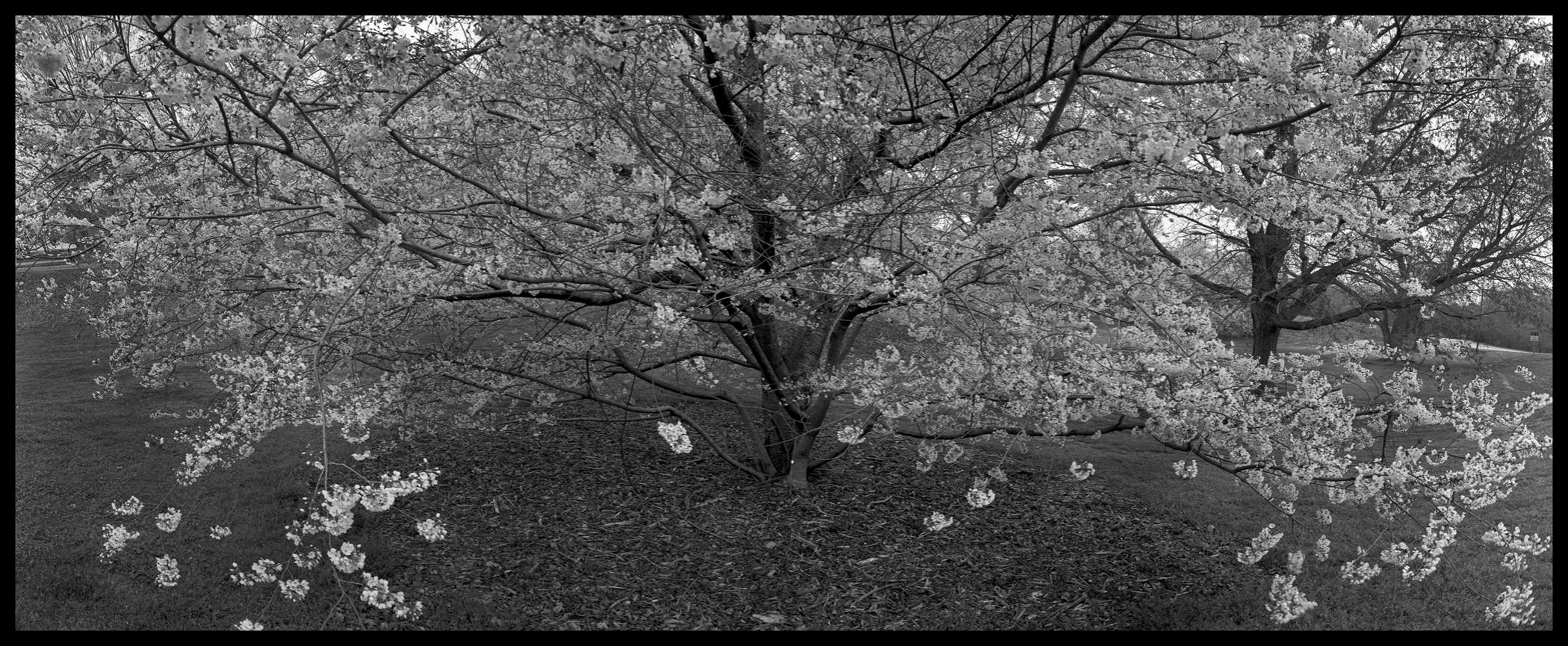

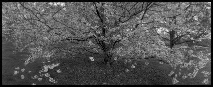

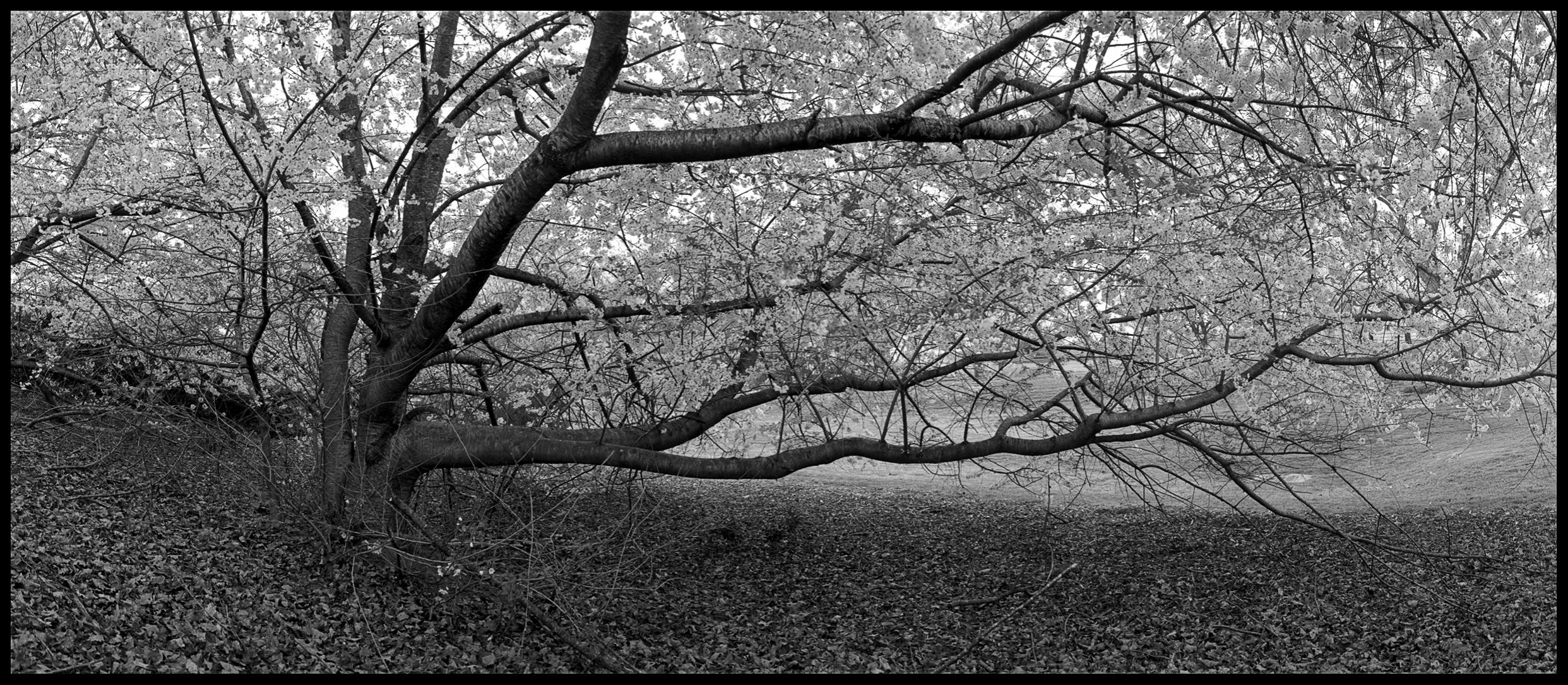

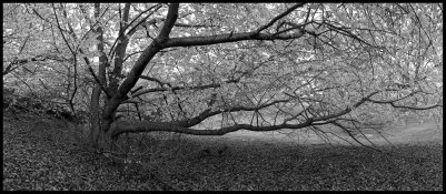

Yoshino cherry tree at Clemson University.
I went over to Clemson on Sunday with Jim Shanesy of Maryland, who was down here with his daughter checking out some colleges and universities in South Carolina. Jim like the trees and the weather conditions (overcast and misty but dead still) but had to get on the road back to Maryland and was not able to do any photography. I sent him a copy of this image and he suggested I post it. This is a quick scan of one of my negatives. I put the border around it and resized for APUG and that is that. Film was Efke R25 developed in Pyrocat-MC 1+1+100, 15 minutes at 70F with minimal agitation (once every three minutes).
I made a few other very nice negatives of the Yoshino trees in the same shoot. The wide aspect of the 6X12cm format seems to favor the elegance of the limbs of this lovely tree. This is one of the trees you see around the Washington tidal basin and they are now at about peak as I understand it.
Sandy King
