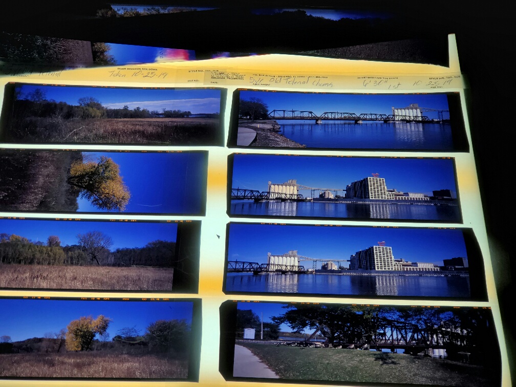

Five year old Tetenal E6. You can't tell from this but it looks pretty good. Slight, very slight magenta shift.
Are those 6x17s? - You've made a good point about the kits, one of the reasons they're expensive is that the bleach can't be used particularly efficiently. I can see the Fuji kits are significantly more expensive in the USA compared to the UK, which is not usually the case with photographic materials.
Tom
Tom
Yep, 6x17 with my humble Fuji G617 fixed 105mm lens. I had split the concentrates in July of 2014. I'm switching to the Fuji stuff, I will probably replenish some solutions and use the 1st developer one shot. I ordered a case of 1st developer and color developer. The starters in the US are crazy, CD starter is sold in a 1 gallon bottle, enough to make 750 liters of working developer.
