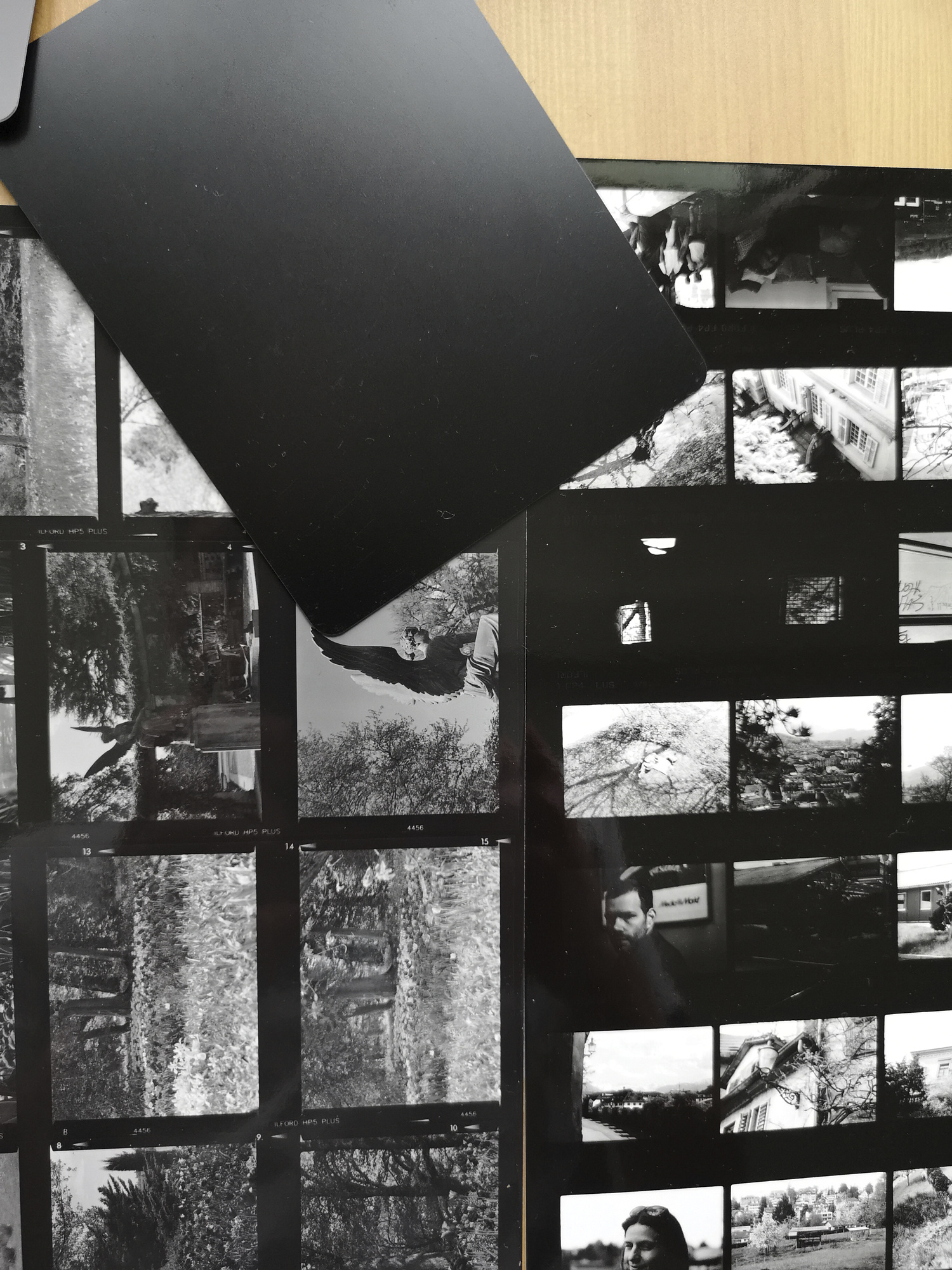

Hi Darkroom Friends,
I am new to apug, this is my first post, i have a few problems in my darkroom printing process, the biggest one is the multigrade rc paper is not going deep black like i have it at the professional lab i can some time do my prints.
my enlarger is a durst m605 with color head, in the pro lab there is a very good condenser enlarger.
i store my chemicals in a 5l botle 2l chemicals 3l air for 3 weeks now, the image appears after 30-45 seconds.
should i really hold the developer in a bottle without air?
The temperature in my lab is about 15 deg celsius.
is the developer the problem ?
thanks for your help
DraganView attachment 200928
doesn't sound unusual to me;I get a Dmax of 2.15 with that paper's pearl surface.glossy may get you 2.2. However ,my processing temp is 20C!
