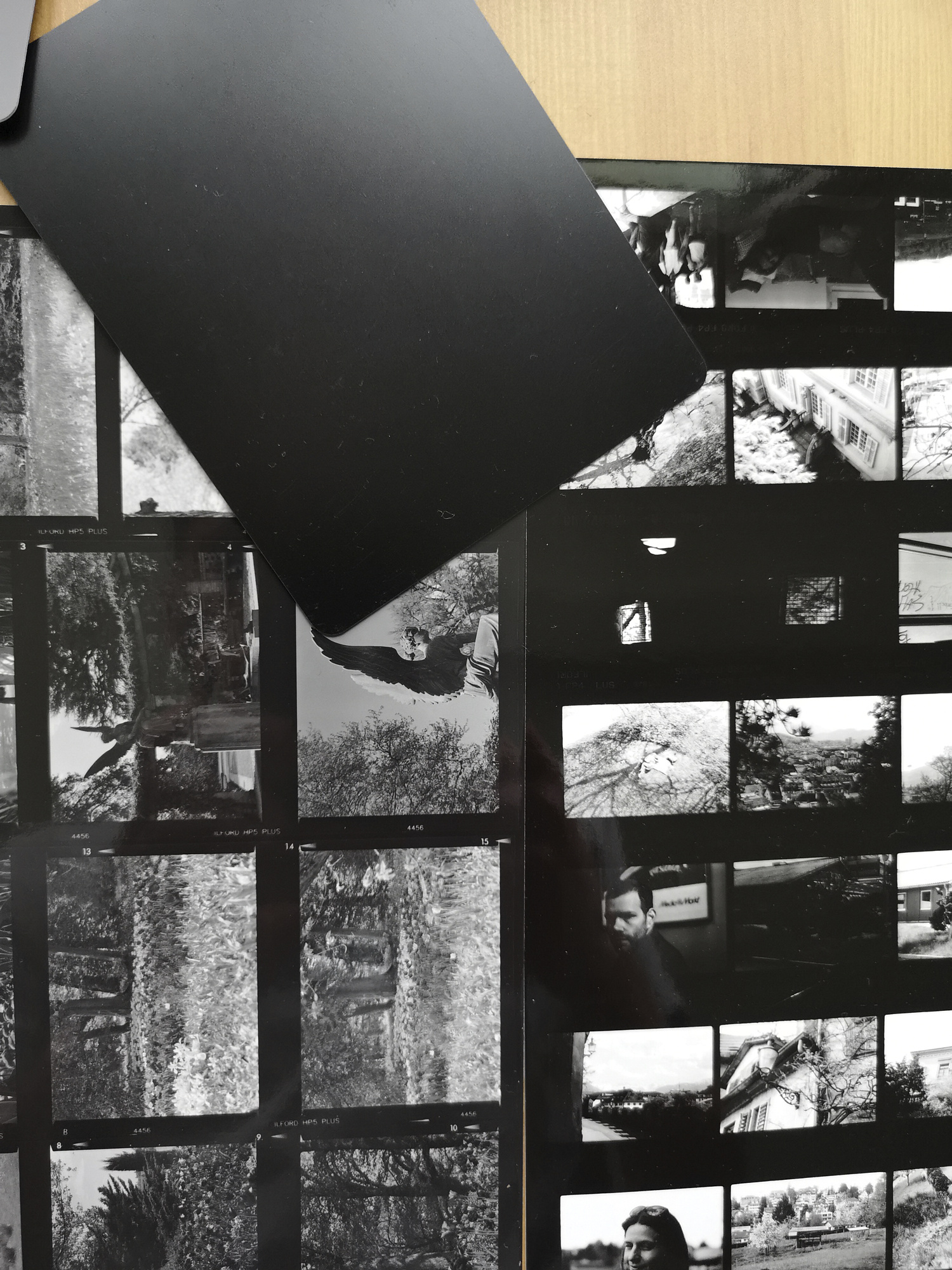

Hi Darkroom Friends,
I am new to apug, this is my first post, i have a few problems in my darkroom printing process, the biggest one is the multigrade rc paper is not going deep black like i have it at the professional lab i can some time do my prints.
my enlarger is a durst m605 with color head, in the pro lab there is a very good condenser enlarger.
i store my chemicals in a 5l botle 2l chemicals 3l air for 3 weeks now, the image appears after 30-45 seconds.
should i really hold the developer in a bottle without air?
The temperature in my lab is about 15 deg celsius.
is the developer the problem ?
thanks for your help

hello dragan:
seems you might be underexposing your paper
usually ( for me at least ) when my exposure is right
and everything looks good, the image appears at about 20seconds.
do you agitate your paper in the deveoper ? is it matte or glossy paper ?
glossy might look blacker ( i don't know if it actually is ) and agitation is important.
do this simple test ...
take a scrap of paper out of your box
put your room lights on and develop your paper
for the 1 minute / the time you are supposed to devleop it for.. see if you get good deep blacks ....
if you do, its your exposure .. increase your exposure and you might be OK :smile:
ALSO not sure what developer you are using, but make sure it isn't too dilute. dilute and develop
your prints for the exact time it says to ...
good luck ! + welcome to photrio !

How long do you develop your prints? If the image emerges after at least 30'', then 3' is the absolute minimum I'd develop, probably more. Apart from that, chances are that your developer is significantly oxidised and needs to be replaced. Generally speaking, try to keep as much air as possible out of the bottle, try using smaller bottles for a start.

hi all,
i am using the same developer as in the pro lab its a eco developer, destilled water, when i made my contact sheet i exposed a test sheet to see where the dark part in between the shots is not going darker, this was my time for the whole sheet, even a paper exposed to daylight is not going to be darker, i am agitating the whole time (is that correct?) for 90 sec in total as in the pro lab with the same developer, the guy in the pro lab is storing the developer also in a big bottle with plenty air in it. i will mix a fresh developer ilford, in 1 litre bottle, and try again. thanks all for help.

90'' development time when it takes 30 to 45'' for blacks to emerge is way too little time. As a rule of thumb, develop for 6 to 7 times the time it takes for the image to emerge, developing more will not hurt either. Yes, you should agitate as you do. The low temperature of your darkroom is basically the culprit and you need to adjust your development time. This however, assumes that you have reasonably fresh paper.

Some ideas off the top of my head:
- normally 90s would seem OK for RC, but at 15C.... try developing longer and use a developer known to work well at 15C
- give enough exposure, i'd say don't go below 5seconds
- is this by any chance Foma RC paper? I found the blacks can look very warm on Fomaspeed giving the impression your photo above shows

Have you done a safelight test?
Unsafe "safelight" would fog the print, making the print blacks blacker... not keep it from reaching d-max.
15°C might be your problem if the developer contains hydroquinone. It becomes inactive below about 15°C. Once that happens, even extending development times won't get it to work again; you'll be developing only with the other agent in the developer (either Metol or phenidone), which won't give you much contrast at all.
I suggest the following: Warm up your developer solution to 20°C. Then develop a strip of paper with the white lights on and see if it gets to maximum black. Extend your development time to 3+ minutes with this test. If it doesn't reach black, your developer is not active enough. Mix new and try the same test. Keep at it till you have active developer. Fix, dry and keep this test strip. Then, before each session, check your developer by developing a new strip of paper with the lights on and compare it to your benchmark strip. If it's not black enough, replace your developer. Keep in mind that working-strength developer is only good for a session or maybe two. Stock solutions last longer. If you're trying to save working solution for more than a few hours, you're wasting time and paper.
I doubt it is your paper, but if the problem persists, even with fresh, warm-enough developer, try another batch of paper. Or, if you suspect your developer stock is bad buy new developer and try with it. Stock solutions go bad after a few months.
Once you're sure your developer is working properly, start over with your tests for maximum black on your proof sheets.

@Andi, the paper is multigrade rc glossy from ilford
@doremus, the developer contains ascorbic acid, dimezone, acid edenic, potassium carbonate, diethylene glycol but no hydroquinone dillution 1+9 on the bottle is written suitable for low temperature and the time for 20 deg celsius is between 60 and 90 sec.
i will try different times on 20 deg celsius and 15 deg with a fresh soup.
will write what the problem was, thanks you all

I agree with Doremus and suspect the temperature of your developer is the issue. Try to get your developer between 20 en 25 C, for instance by using a bigger tray filled with warm water, filled with warm water. Then follow his other suggestions for the simple test. Getting your paper black shouldn't be too much of an issue using white light.

Print developer should be at least 68°. According to your pic, it looks like you're comparison is matt paper vs glossy. Matt paper will never appear as black. Have you ever done a standard printing time test. A test where you get the maximum black with the least amount of exposure? You will have to do the test with an exposed portion of your negative. Take a look at this.
http://www.timlaytonfineart.com/blo...black-and-white-proper-proofs-in-the-darkroom

15 degrees C is on the low side but all I can say is that your contact prints seem to have blacks that are as deep a black as I'd expect them to be. Based on the scene when each negative was taken which of the resulting prints' blacks are not black enough?
