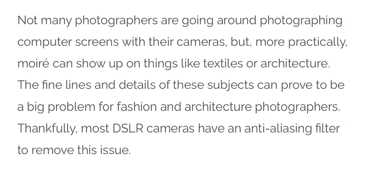

This might help you (or not):

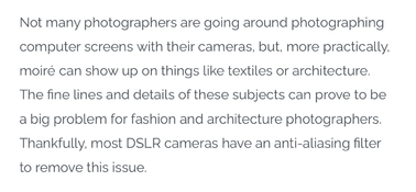

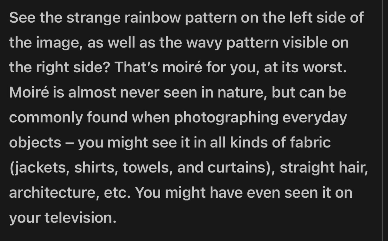

Here are a couple of links where people discuss problems with colour aliasing in the Ricoh GR iii - also 24Mp with a sharp lens.
GR iii no AA filter issue
Simulated AA filter for star trails with GR iii
If you don’t have a problem and can’t see the artefacts you can just be happy:smile:
