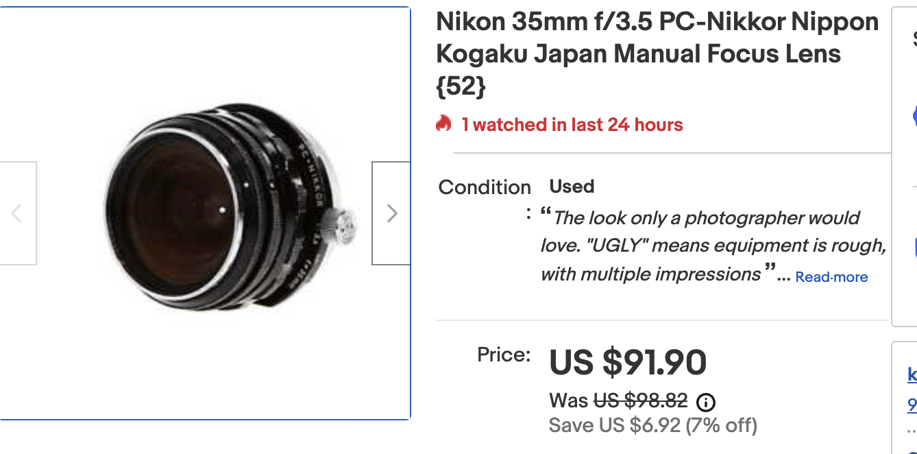

I just got an 18-28mm full-frame, manual-focusing zoom for $15 on EBAY. I already had one, but this was too good to pass up. They were made in Nikon F mount as well. There are other similar zooms too from Vivitar, etc.
https://www.ebay.com/itm/164930494680

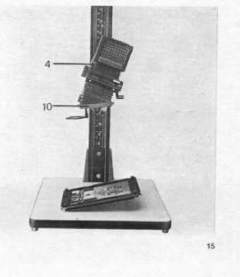

Depending on the type of enlarger you have, you may not need a shift lens to straighten converging parallel lines.

Exactly! If you are shooting slide film then you need a shift lens. Otherwise corrections can be done when making prints from negatives in the darkroom.

A shift lens would help, but it is not likely to help you in your situation. First, you have to have one for your camera mount. And most are only made in 35mm and 28mm. If you are close to the subject, it won't help very much. More importantly, they are very expensive.
And since you don't have a darkroom, forget about the enlarger trick.
Your best options are to move back as much as you can, get the camera as high as you can, get the widest lens you can afford -- AND HOLD IT LEVEL. Then chop off the bottom of the picture.
