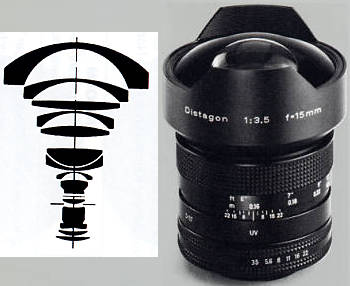

This is my 'Holy Grail' lens for the Rollei system. I have only seen one for sale once at $6000 so I passed...

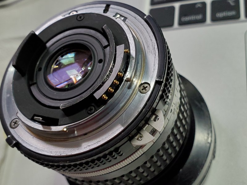

Can the Nikon 15mm f/3.5 NIKKOR AIS Manual Focus Lens be chipped?
Yes
I did its 18mm brother:
Works great on the F6 and F100 now. Matrix on the F4, too. Basically mounts and meters as I expect with no fussing or setup on everything I've tried.
I didn't try it on the N75, though, so no promises it'll mount, but I can't imagine it'd be an issue.

Where did you get it done and what did it cost?
I did it myself.
Got the chips on the ebay. Dandelion for Nikon or something like that will find them. They were $30, looking at the ebay auction I won.
Programming takes a dslr. I did it with a D7100, and isn't hard. It's silly, turn it on holding this and that, wait for this number of flashes, fire the shutter, wait for that number of flashes, etc. Just follow the included instructions carefully and it works fine.
I have that lens on the F4 right now and it meters great, and focus confirmation works properly. Interestingly, they're not supposed to be compatible with the F4, but I'm not complaining. My ebay auction said:
AF Chip "Dandelion" for Nikon Compatibility
There are only three film cameras that Dandelion is not compatible with: F4, F60, F601, F801 and F90x. It works with all other models perfectly. Programming mode is not compatible with F5 and D1X/H models.​
Anyway, it looks like the dandelion will work with your nikons.
I did it myself.
Thank you. I found the chip and the instructions on-line. Lacking a DLSR, could I program it with my F100? It looks like it.
