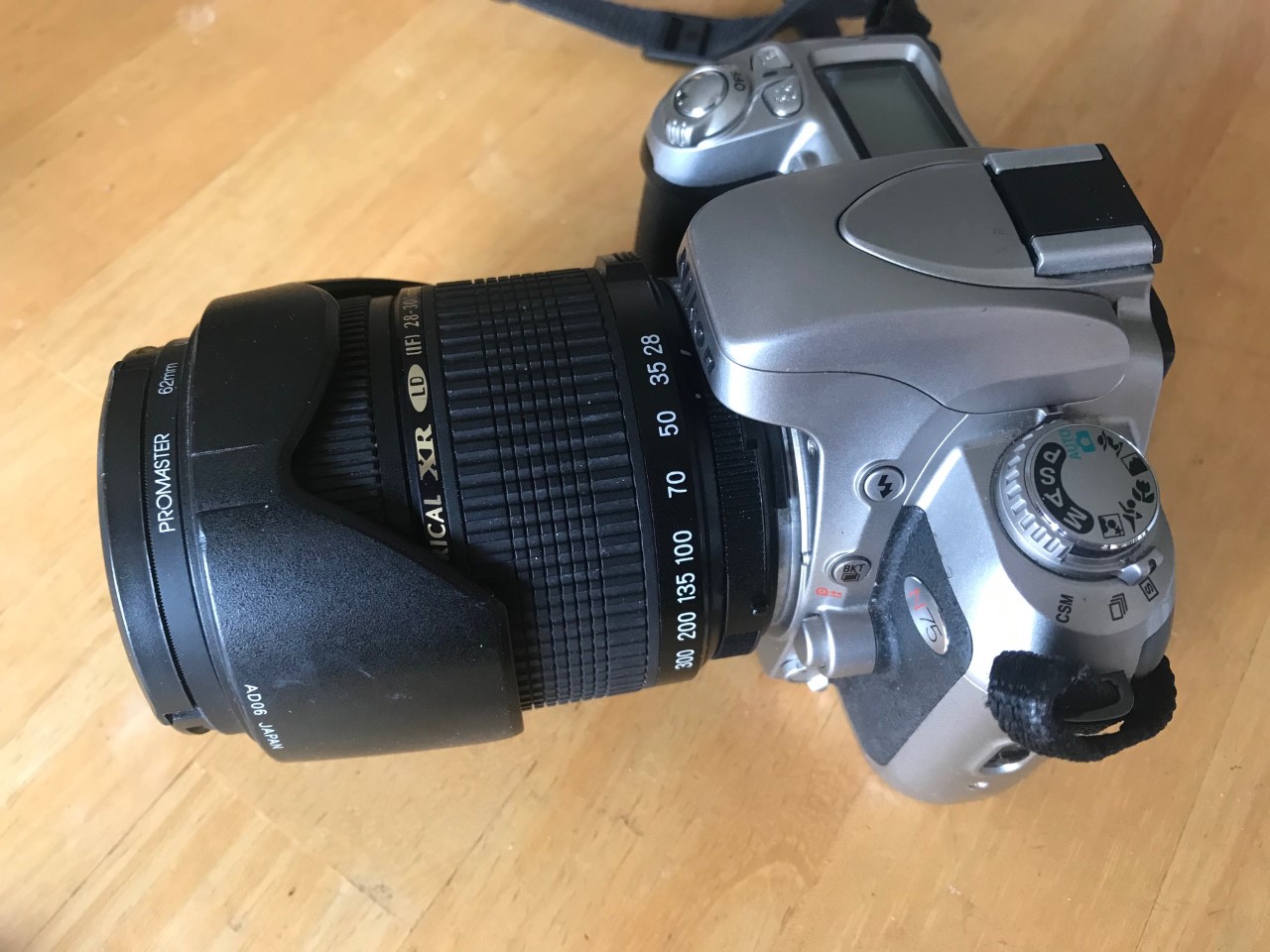

I think I could have picked up a N75 with the 28-80mm for $45, but I’d not heard great things about it so I just got the body. I’ll keep my eyes open for a steal on the 28-80 or similar.
Hold out for the 28m to 300mm AF zoom and have fewer lenses to carry around.

If the 28-80 is good, why not just get a 28-105? That lens seems to get decent reviews and would cover the bases even better I would think.

I have it. It is much bigger and heavier and while excellent on a bigger/heavier body, does not feel good on the N75. 28-80 feels perfect.

I just saw what looks like a mint shape N75 with the 28-80mm lens on ebay for 38.95 so I bought it.
Excellent! There was a reason that is the kit lens on the N75 - works perfectly with it.
FYI I have the latest 24-120. It is very big, very heavy! Would be miserable handling-wise on an N75.
