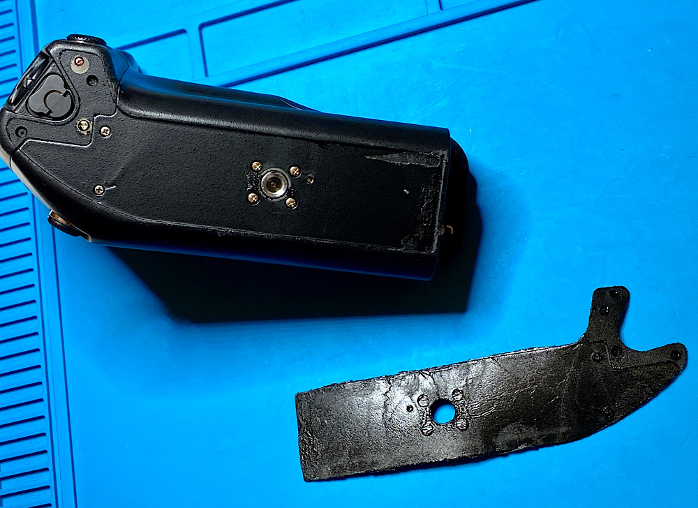

Until I recently tried to take the camera out of the closet and realized that it was stuck on the shelf. The glue had liquefied and was oozing out around the edges of the rubber cover.
Not a great condition, so I set about removing the old adhesive in order to re-attach the rubber cover cleanly.

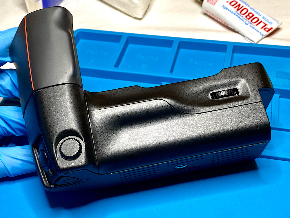

The MB-23 battery grip in mint condition ...
… if it weren't for the glue that no longer stays in place.

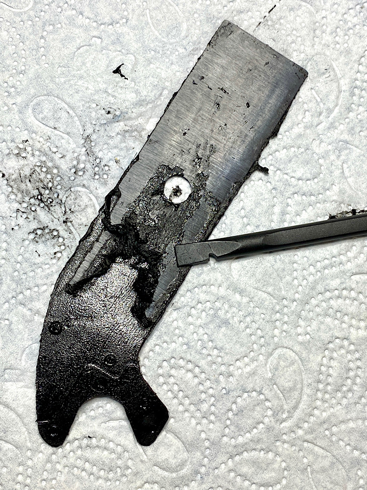

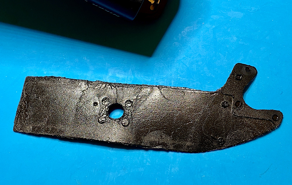

The rubber cover is easily removed.

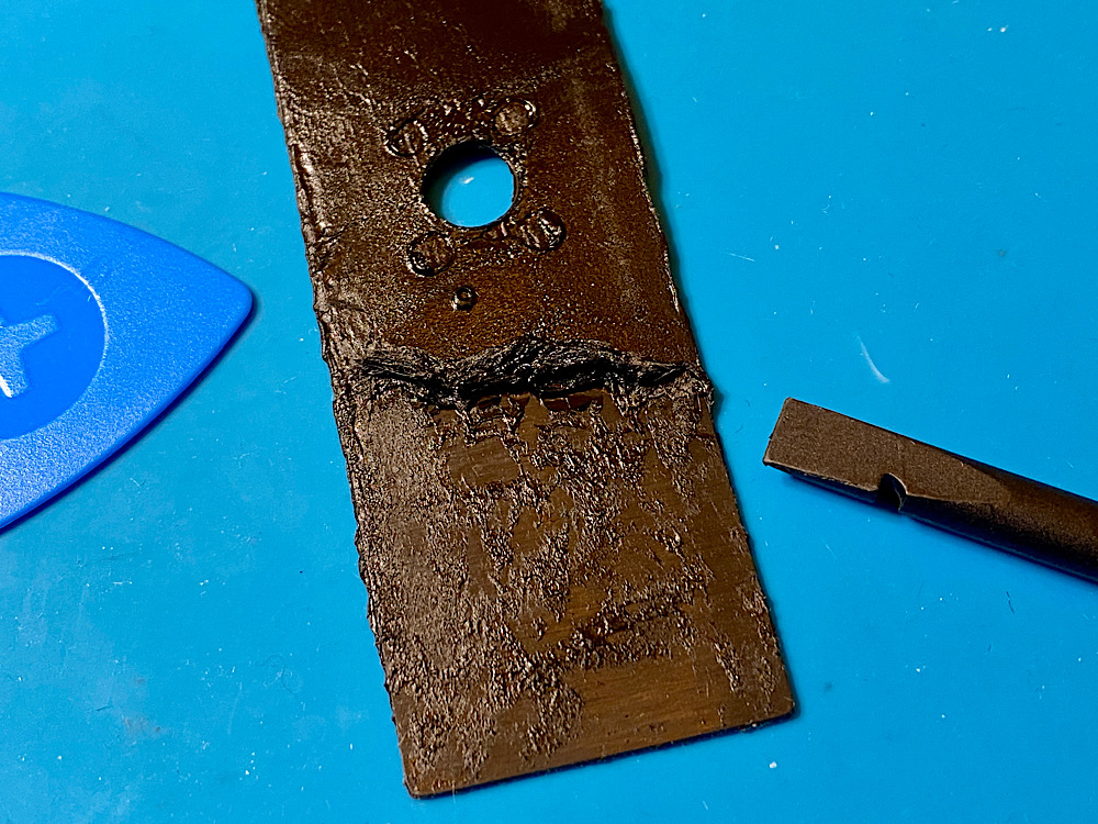

The adhesive can be laboriously scraped off, or rather pushed off, from the rubber cover. But sticky residue remains.

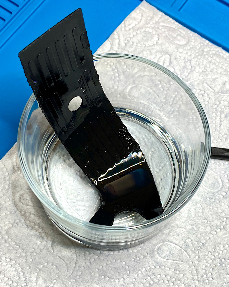

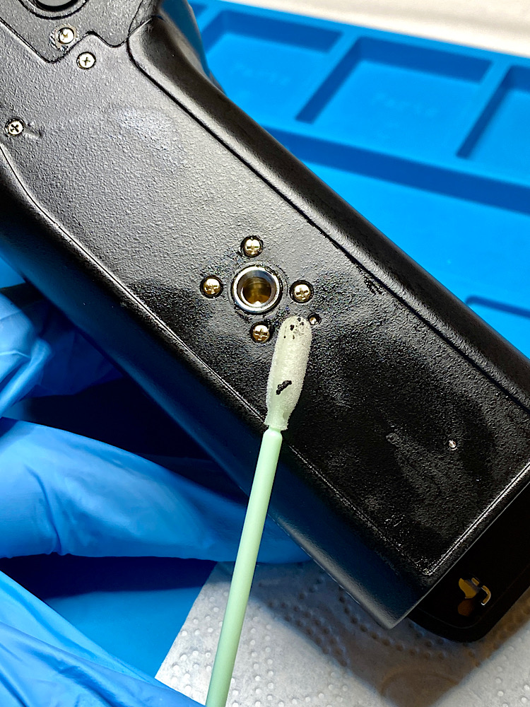

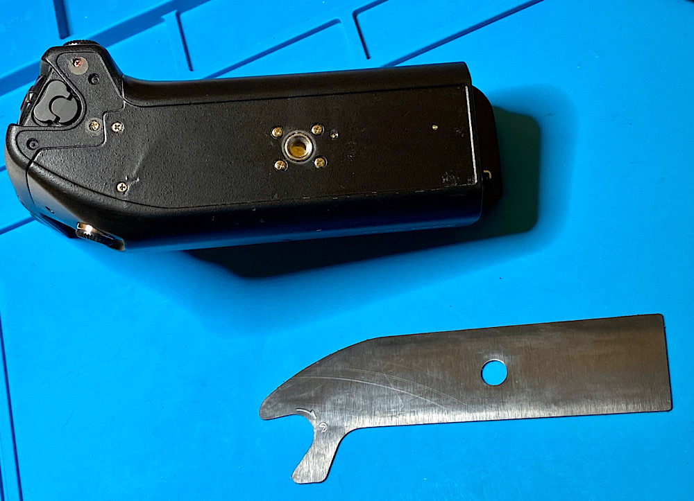

Once again, Zippo lighter fluid helps. It loosens the adhesive, which can now be scraped off almost effortlessly.
Everything is clean, but it takes time until every last sticky residue is removed.
Ventilation is important, as there is some gasoline vapor in the air.

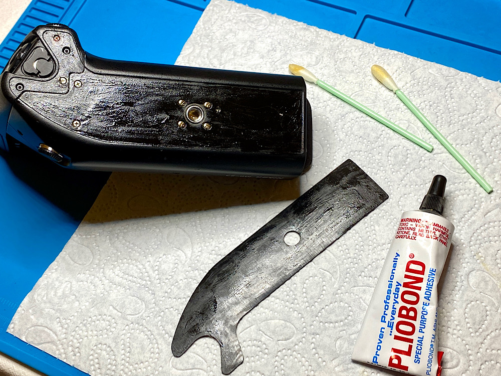

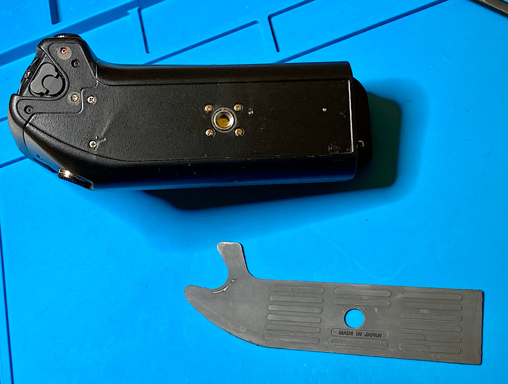

For maximum adhesive strength, Pliobond is applied twice and allowed to dry for a few minutes.

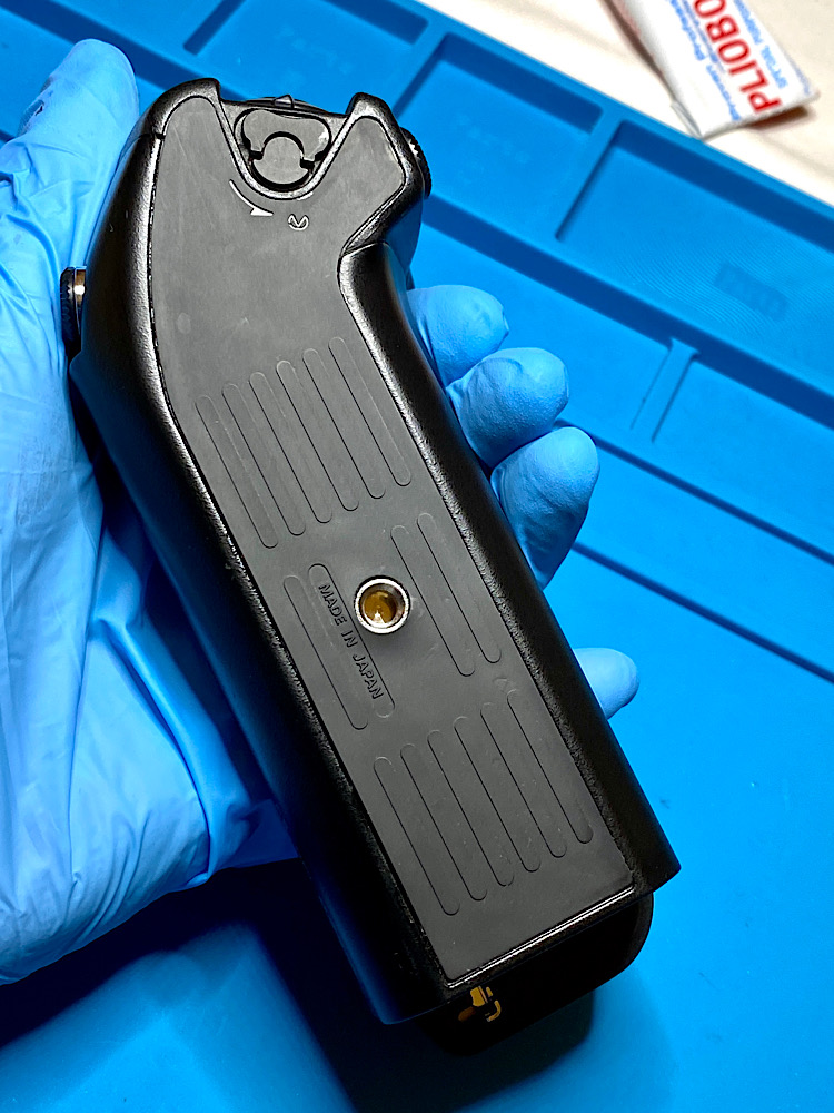

Align, press on and remove Pliobond residue with some Zippo.
Completed 🙃
