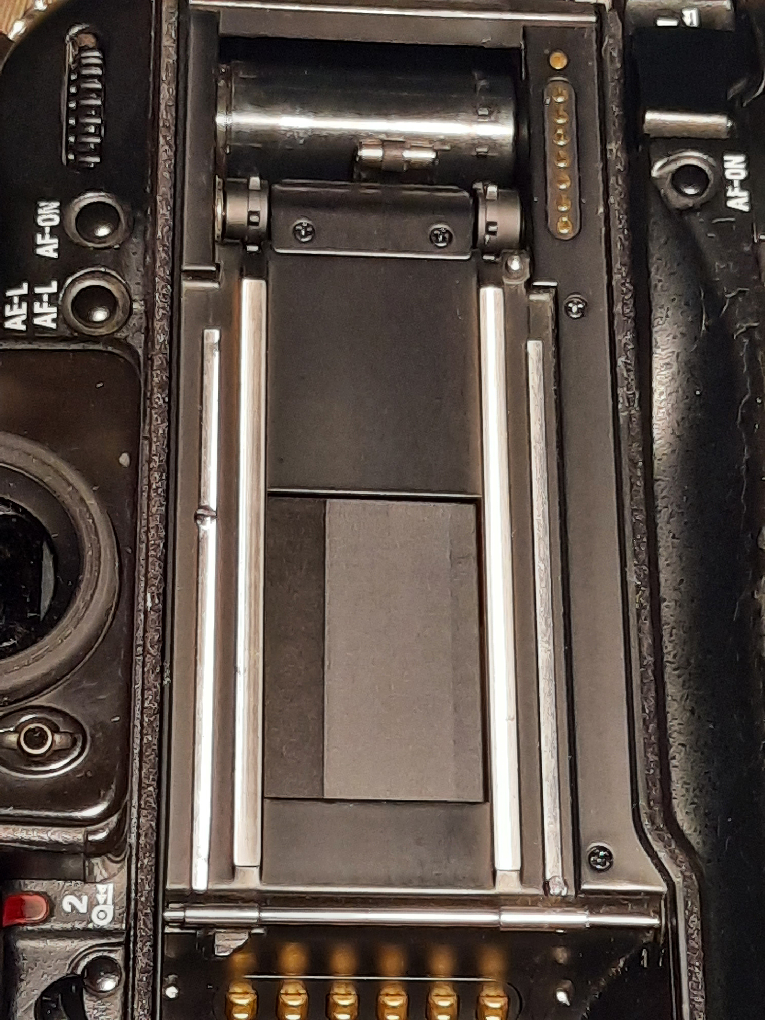

If you look at the picture of the mirror box it looks like one blade of the shutter is frozen in place?

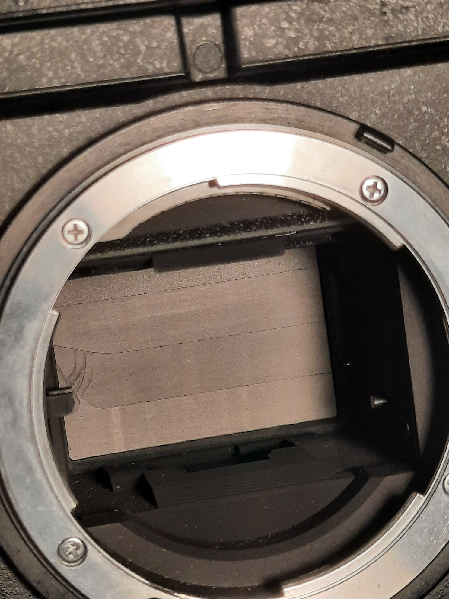

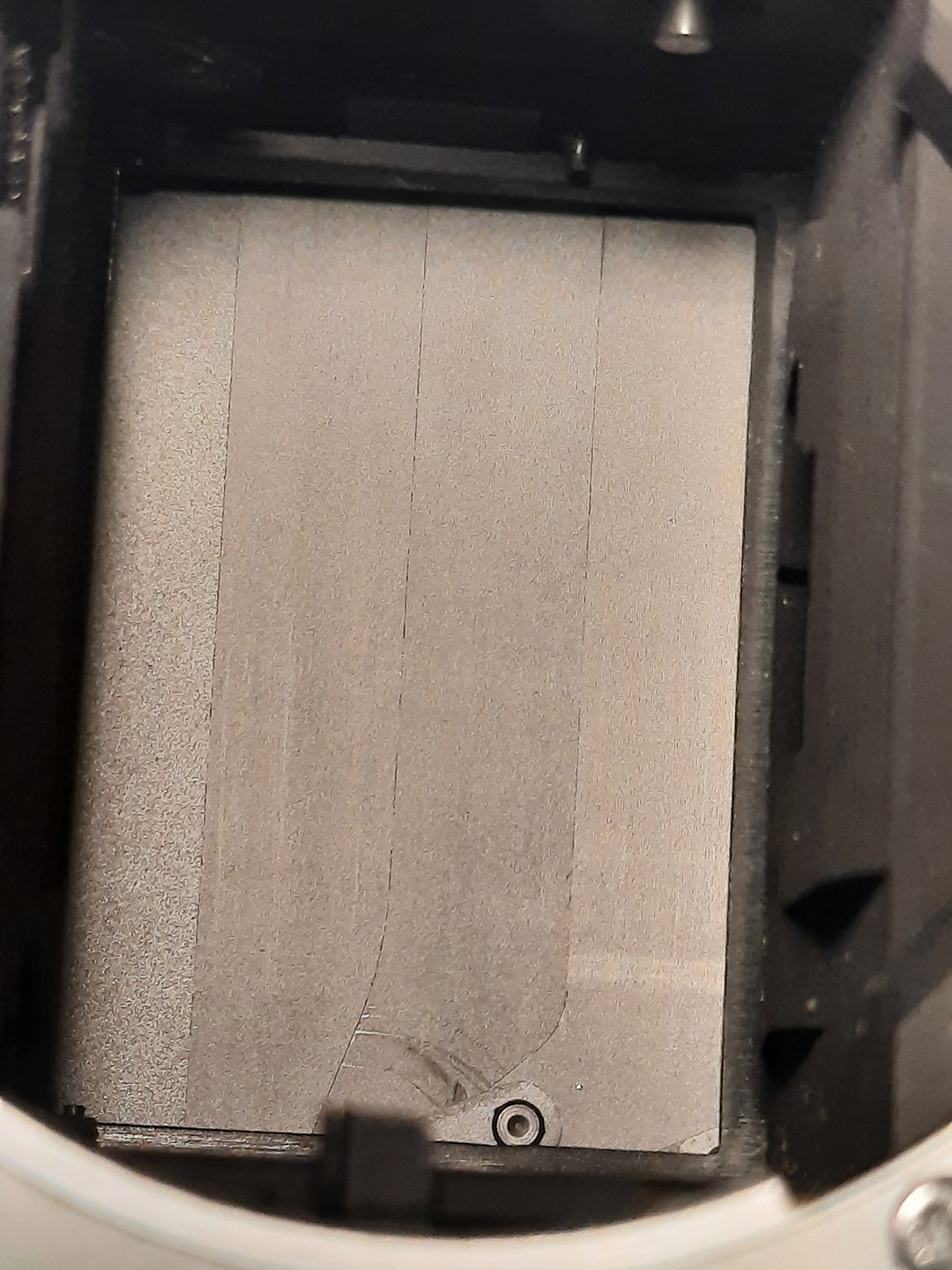

Last pictures and post for the day; won't have time to get batteries until Sunday. I turned the mirror lock-up in the up position, and then back down. Tried the shutter release again and the mirror definitely fluttered a little more, like it wants to go down. Before it was like it was striking something that was obstructing it, but now it's definitely freer. If I was a betting man, I'd say the batteries. Pictures are of the shutter curtain. I've never seen one on a Nikon up close, so I don't now if it's totally closed or partially open. Good night folks!

Yeah try batteries, the shutter looks normal, the streaks where the two little arms travel look quite worn. Either fresh quality alkaline batteries, in the handy 8 pack will make it go or not.

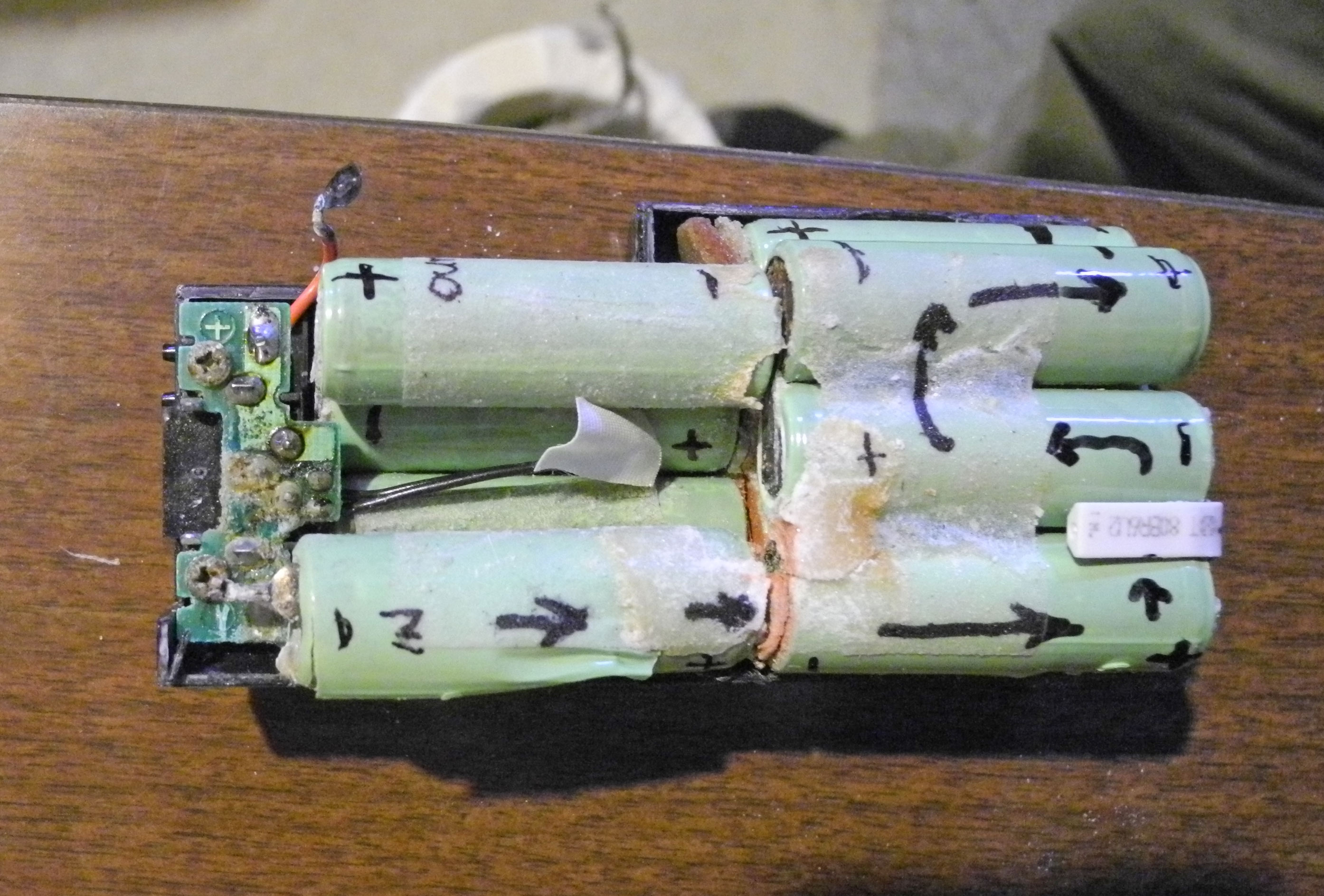

Here's a picture of the inside of a MN-30 battery pack. It's not a pretty sight.
There are 6 cells (two layers of 3 cells) at the locking tab end, and 4 cells at the interior end. Nasty corrosion everywhere.
