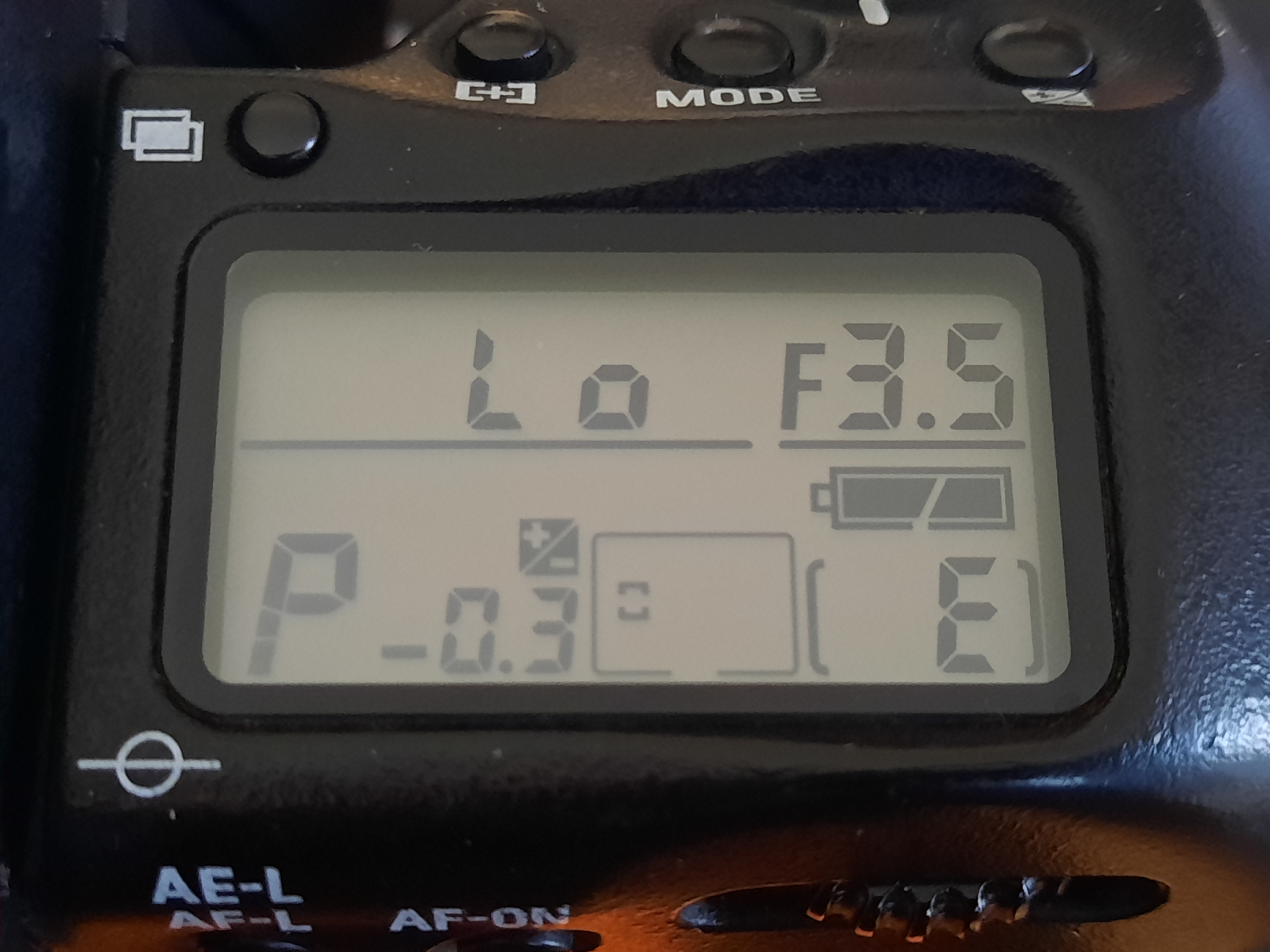

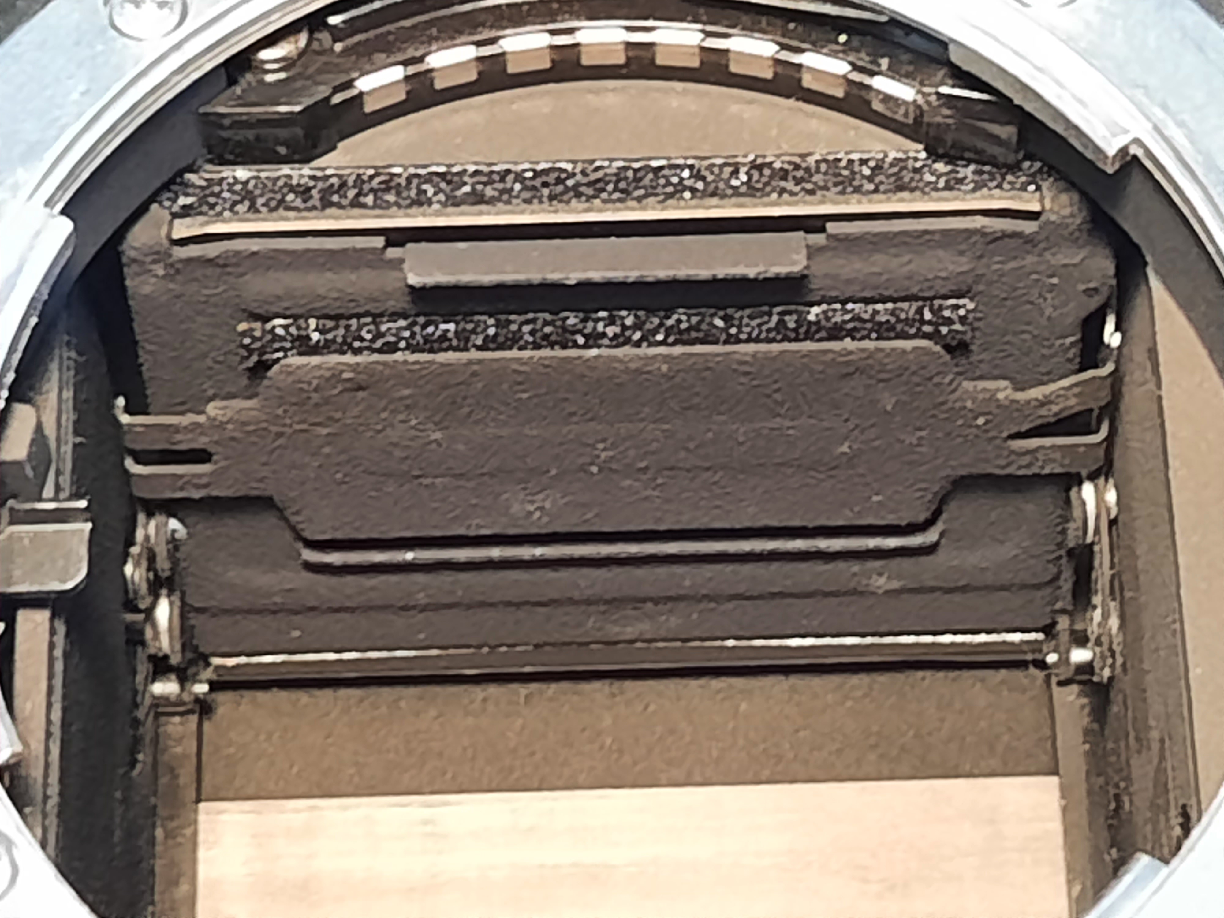

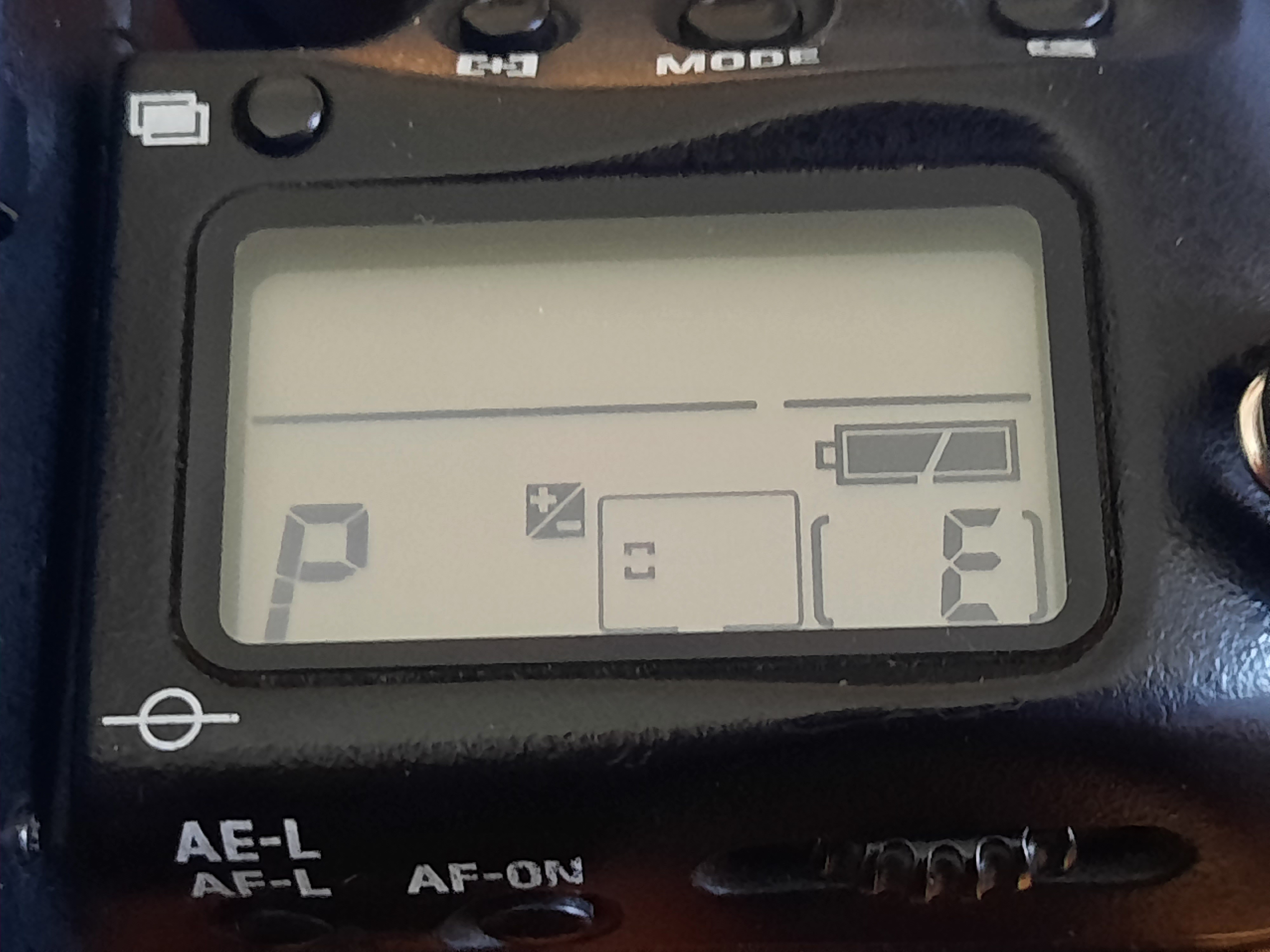

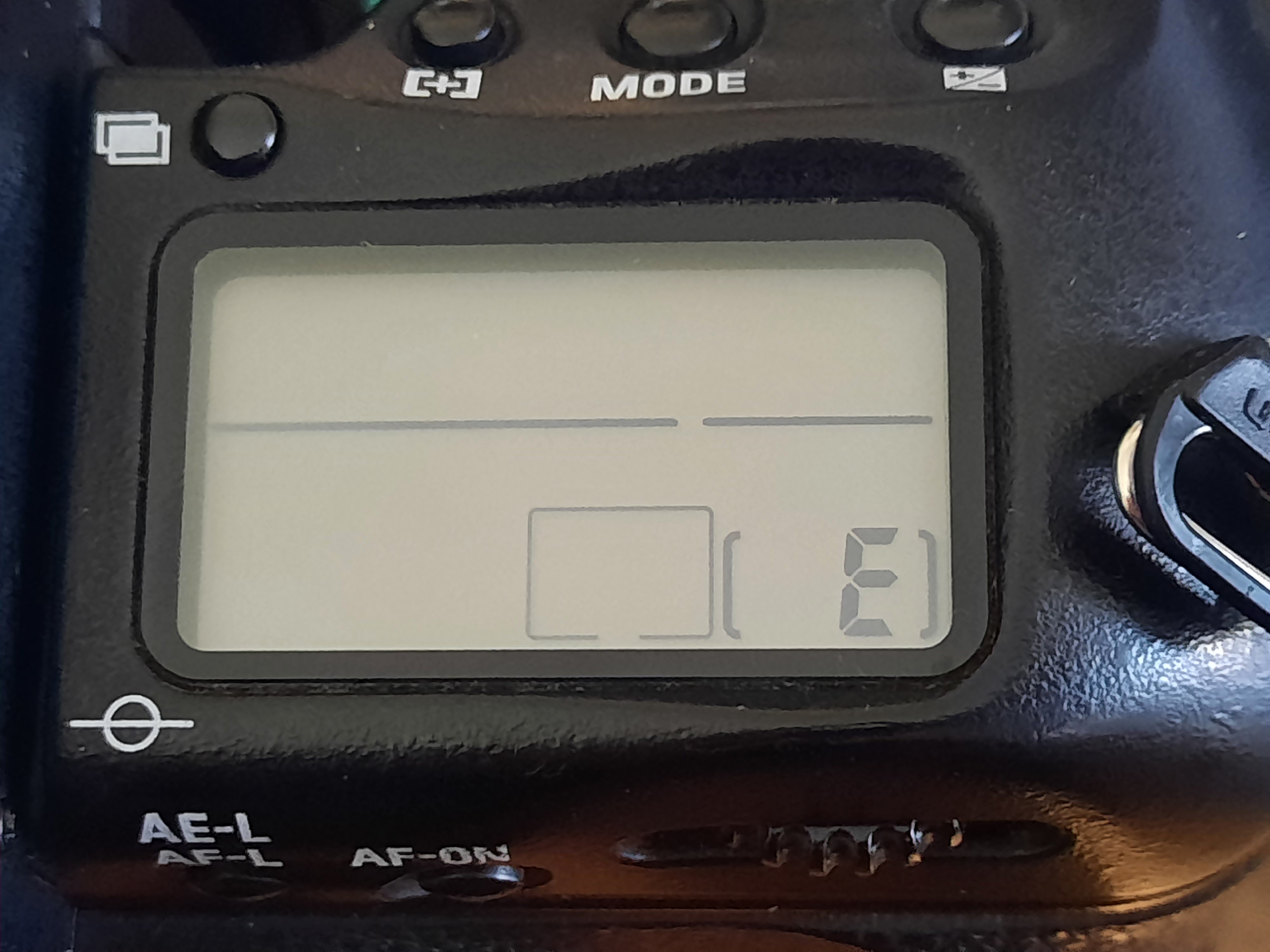

Howdy, if this has been addressed, I didn't find it, so feel free to redirect me. I just got my Nikon F5. My first Nikon, and this week I got my first Nikon lens to go wit it. I charged my batteries and, without film in the camera, I slapped on the lens and tried the autofocus by lightly pressing the shutter release. Worked when I pointed it here, worked when I pointed it there, but then oops! Pressed the shutter release hard enough to trip the shutter. It was late at night, so the room was dark. Now the mirror is stuck in the up position. I have "lo" showing in the shutter speed position (f 3.5), the red blinking arrows pointing at each other in the viewfinder and a yellow downward-pointing triangle in the upper left hand side of the viewfinder (that one is a real stumper). I've switched between both autofocus and manual. Without the lens on the camera, it looks like the mirror wants to return to the down position, but it's not. Any ideas? I thought it was stuck in a long exposure, but I've turned it on and off, pulled out the batteries and put them back in. Mirror still doesn't want to drop down. I've got some time to return the camera if it doesn't work, but wanted to see if there was anything obvious I'm missing. Thanks for your suggestions!
Check batteries.
Check to make sure mirror isn't locked up, intentionally
I have had good luck with the F5
Do you have the MN-30 battery pack? Otherwise Nikon recommends against using rechargeable AA in the F5. You did say you charged the battery.
The mn-30 packs are long gone. I have a couple that were rebuilt, even those won't hold a charge.
Check the lock up lever. And put some good batteries in it. The F5 doesn't like low voltage. I use lithium and have good results. But when they go they simply check out w/little warning so carry spares. And enjoy your F5 I have had mine for years and the only issue I've ever had was cheap batteries.
That was why I asked about the MN-30. Unless the OP has the MN-30 otherwise the NiMH AA's have too low voltage for long battery life in the F5 that is the voltage will get low enough to trigger the F5 low batt warning while they still have plenty of power left. So if the OP put in 8 Alkaline or Lithium AA's would fix the problem. Depending on how the custome settings were set. Normally the F5 would close the shutter after 30 seconds regardless how dark it is but this time can be extended to 30 min. in custom settings.
Okay, I DID use rechargeable AA batteries, that were fully charged when I first tried the camera. I re-recharged them overnight and still no change. Battery indicator indicates a full charge. The mirror lock-up lever is in the down position, and there's a little play in it (I don't want to turn it to the lock up position since the mirror is all the way up). I manually changed the ISO to 250, and have tried to change the shutter speed, but the shutter speed indicator does not change from "lo." If I press the shutter release button all the way down, I hear a little "tick tick tick" which, when I have the lens off, looks like the mirror still trying to drop back down. The shutter really looks like it wants to drop but it's obstructed, though I see nothing obvious. Otherwise, still the same. With light coming though the viewfinder (I assume) the shutter speed indicator has changed from "lo" to "2.5'" but it doesn't stay. I've changed the exposure mode to manual and aperture priority and tried it, but no luck. This weekend I'll get new alkaline AA batteries and try those as well. It could be my rechargeabes will never produce enough charge. I'm including some pix... 1) the mirror locked up; 2) the top screen with batteries in but camera off, 3) the top screen with camera on sometimes displays less information, and 4) the top screen with camera on and all the info displayed. If picture 3 is how the top screen should look when I'm not touching the shutter release, great. If it should always look like picture 4, then maybe another issue. Besides the mirror lock-up, was there something else in the online manual Part X that I missed?

Oh, and just in case I keep turning it off before the exposure is complete, I've decided to leave it on for a while. I might be interrupting it whilee it's trying to complete a long exposure. Who knows? Maybe I've just been too impatient.
Buy some fresh AA alkaline batteries from the store and put them in. The camera sounds like it doesn't have enough juice to finish the shutter cycle. Many rechargeable AAs do not have the same voltage as the regular AAs the camera was designed for. They can work in many devices, except when they don't.
Thanks!
thank you. Now I must say something else is wrong and not the batteries. As long as the battery indicator indicates OK the camera should function normally. I did use AA rechargeable on my F5 and found that I have to recharge them very often but they would work for a short time. Also they wouldn't cause the damage either.
I could see the meter indicating the batteries are fully charged, but still not having enough juice to complete the cycle. I will try the fresh batteries this weekend. I left the camera on for an hour and it didn't complete the exposure, so that idea was a bust. I'd have thought upon removing and replacing the batteries it would have reset the cycle, but what do I know? That's what we have the folks with experience for! Any other ideas are still appreciated!
Thanks
What do you have to lose at this point by trying the mirror lock up lever? As well I would activate the lens stop down button, both of these individually and with a shutter activation, and I would try these sequences with a actual roll of film, going through the loading, shooting and rewind processes. Lets hope you have a 'development reel test roll" and not have to waste a 12.00 roll of Tri-x.
As I see it, anything except a full on ERR message means it should or could function.
But, it could be bricked.

No sacrificial 35mm rolls (unless there's one at the back of my refrigerator). I've been using large format and recently getting back into medium, but it's been years since I've had any 35mm around. Batteries are simplest to test, so I'll start there. The camera might have been waiting to die when it was sold to me, but I don't want to do any more damage to it if I send it back. Fortunately, I have no time pressure and I have 30 days before it needs to be returned. But I'll admit I HAVE been tempted to flip the mirror lock-up lever up and then down again just to see what happens.
Batteries. New batteries. The "lo" isn't referring to light. It's voltage.
EDIT: Nope the "lo" does indeed refer to exposure according to my manual page 150.

You may have a bigger problem, the photo you show has shutter partially open, this is way not normal. I would be tempted to stick my finger in the front and extraordinarily delicately give the mirror a nudge down (worked with an old Hasselblad 🤔)
I've never seen a shutter stuck before but it should be fully opened or fully closed.

Lo indicates light is too low that there is no shutter speed that will result in correct exposure. But that's natural as the meter in the viewfinder receives no light due to the mirror is up.
The mirror lockup level is mechanical but I believe in this case the shutter is also open isn't that right?

I think the lens was open all the way, so even in the low light of my apartment it shouldn't have initially been too long an exposure. I don't have the camera with me, but the shutter curtain was closed while the mirror was up. I can see the readings inside the viewer, so I don't think I closed the viewer curtain by mistake. I did change the exposure mode hoping that in aperture priority, with the lens open all the way, it would complete the exposure. That didn't work. When the mirror tries to drop but doesn't, it sounds like it's making an effort: jerks just a fraction, but stops. So I don't think I have any old foam gunking it up. I'll try shining some light through the viewer because, yes, with the mirror up, the only light would be coming through the viewer or sneaking past the mirror when the lens is off. Worst case, if I end up returning it, at least I'll have learned more in a short time from the trouble-shooting then using a manual.

I would want to know if the shutter is open? May be it doesn't.
