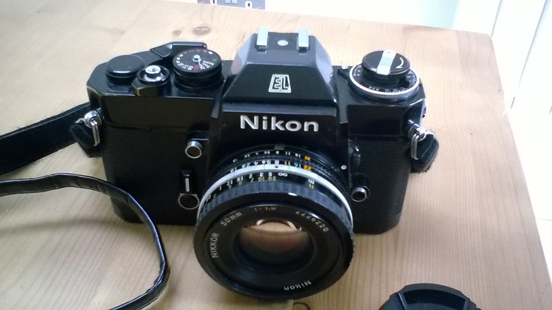

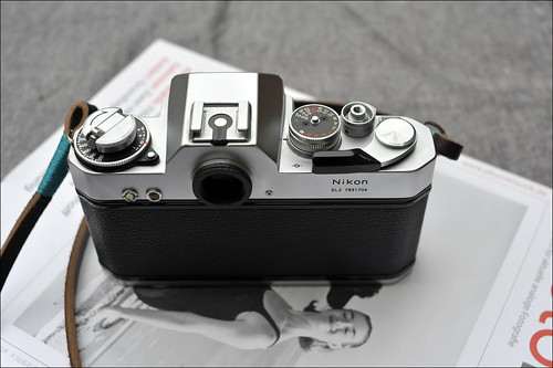

Yes, the Nikon F80 / N80 for the USA market is quite silent, but CMoore has only MF Nikons. As you know the F80 can't meter with AI/S lenses.
The early FM is similar to the EL2. They have an unlocking switch around the shutter release.

C
It was to make it easy for the user.
When the FE came up, it didn't need any more the separate switch to unlock the shutter release when the motor drive was on.
On the FE and later FM and all the others subsequently when you attach the MD-11 or the MD12 the shutter button is released internally via a pin on the base. So, you don't need to turn the advance lever away to unlock it.
That is my understanding.
On the early FM and the EL2 the shutter is locked when the advance lever is flushed. It can then be unlocked and the meter activated by 2 ways: moving the lever to the stand by position or switching on the unlocking ring around the shutter button.
One advice: read the manuals for these cameras. All of this is there.

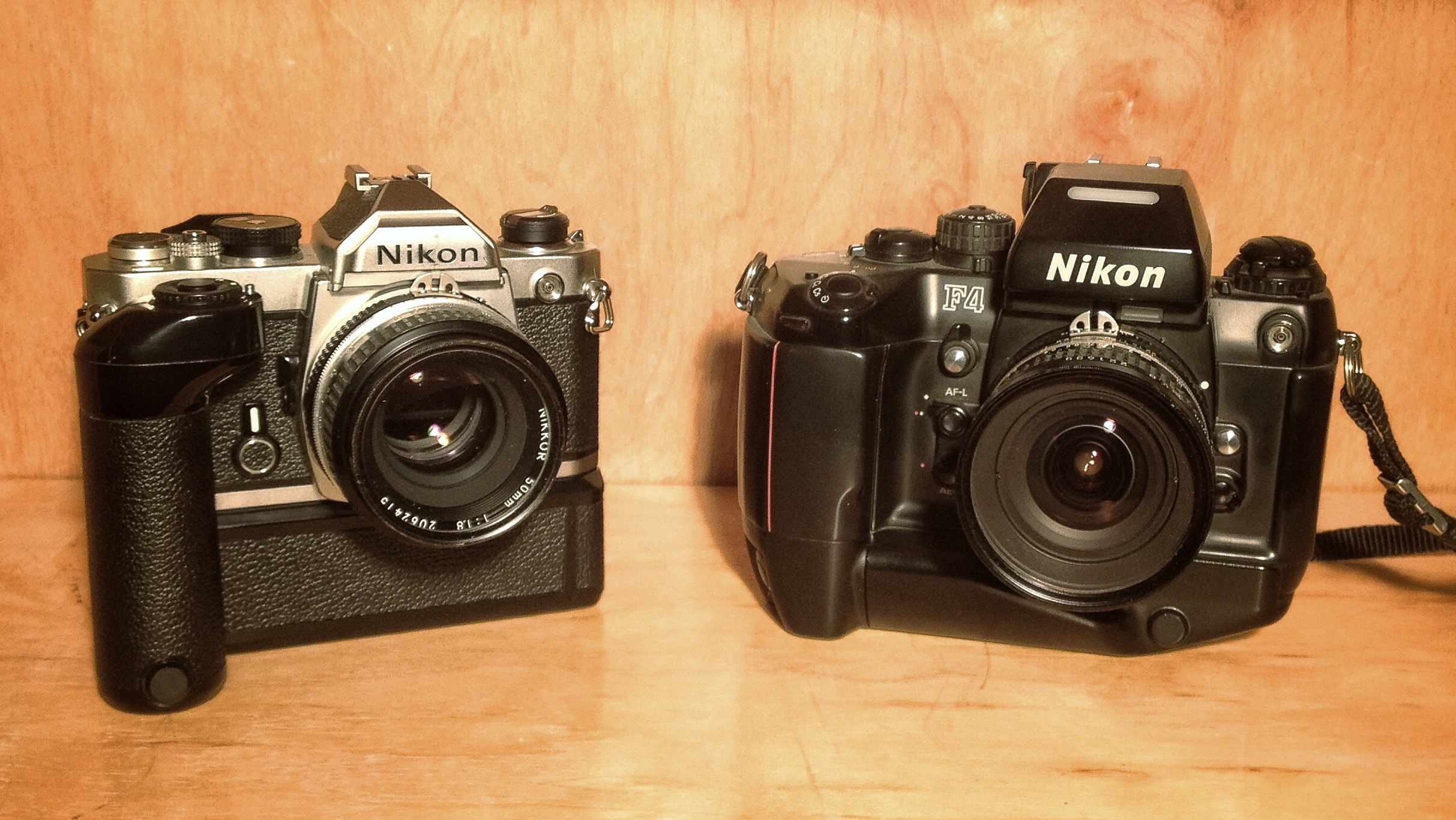

Here's the business end of my FM2n...
Body was $129.50 (turned out to be about $86 after a trade-in), MF-16 back was $10 shipped, and MD-12 was $19.75 shipped.
