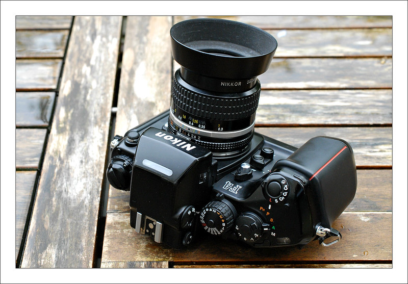

I have had two (stil have one) F4s and they are, by far, The most ergonomical cameras I have used, including F3, F2, Olympus OM4, several Canon, Ricoh, etc. They weigh,but nothing unbearable, and they are very balanced.
Here's mine - F4 with MB20
Nikon F4 - MB-20 - Nikkor 35mm f/2 by Andreas, on Flickr

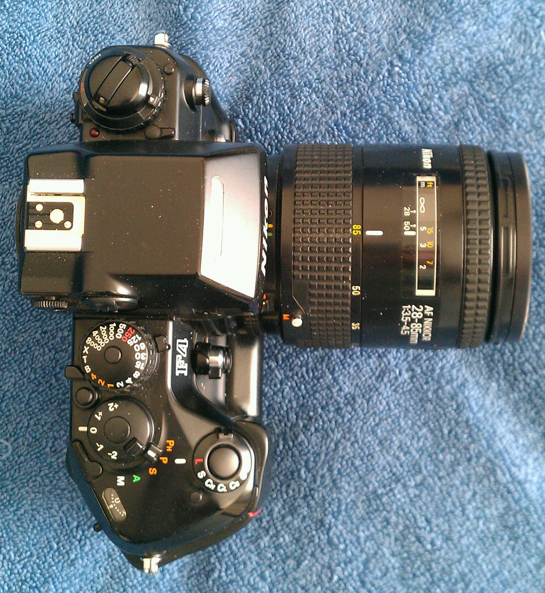

nars- Yeah...that F4 in front, if i could find a "small" one like that i would be happy.
