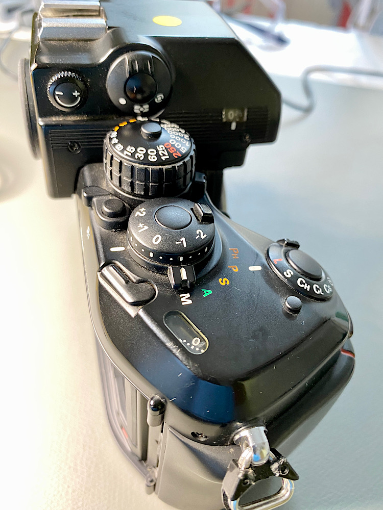

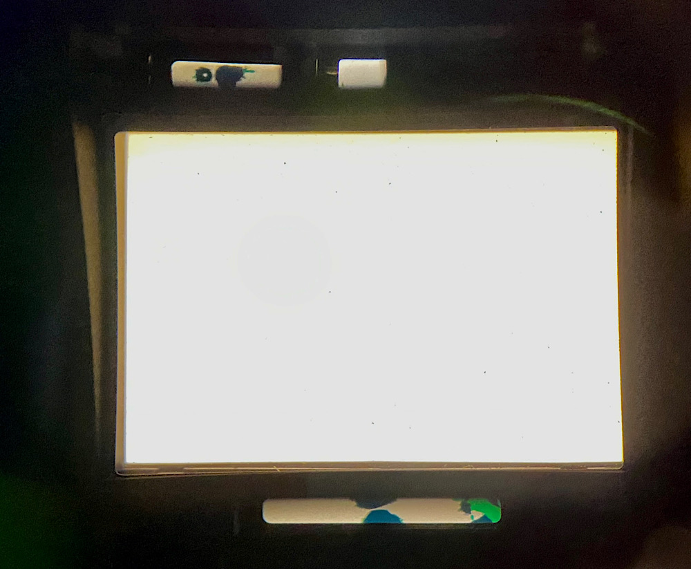

There is a second problem with the otherwise mint F4. The display in the DP-20 viewfinder has leaked and there is an orange line across it. The display that sits in the F4 also has black spots. These are also known problems with the F4 that can only be solved by replacing the displays - if you have a spare part.
I read somewhere that the cause of this is heat, which damages the displays. Since I don't store my cameras above 30 degrees Celsius (= 86 F), this should be out of the question.

That's what I'm feeling at the moment with an F4 that I want to dismantle to fix the problem with the resinous mechanics in the mirror box.
The camera, with its smooth, velvety shimmering surface, doesn't invite you to open it.
I already failed when I tried to unscrew the rewind crank. The screw head is soft, I see brass shimmer, the screwdriver doesn't grip.
In order not to destroy the screw head pointlessly, the project ends here. Because I don't think the numerous other disassembly stages are any easier to master.
And my motivation to continue here is also greatly dampened by the condition of the two LCDs.
There's nothing left to do here.
It's a shame, the F4 is a wonderful camera, but you have to be able to say goodbye.
