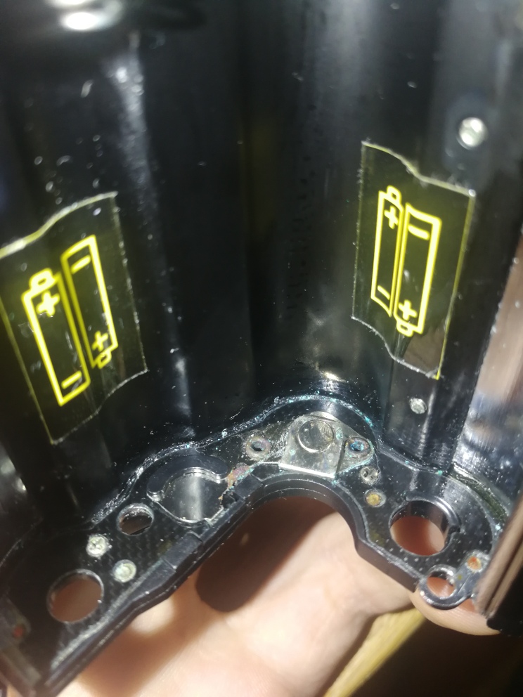

So getting suspicious i opened the battery compartment/pack MB-20 thats included in the F4 and lo and behold there was some small amount of green alkaline corrosion in the upper corner, not were the contact with the camera is but opposite from it. So at some point there must have been a leakage possibly ruining the pack.
Now my question is could a short-circuit or anything like that ruin the entire camera or just the pack itself? the rest of the body etc show no sign of any damage or grime, in fact it looks brand new. But if the pack was not working properly how could the mirror have moved?
I tried cleaning it with vinegar and a q-tip (cotton swab) but without the tiny screwdriver needed to extract the contacts i couldn't get behind one of the battery holders nor underneath the contacts. i will include a picture of how that looks now.
Do you guys think its possible to save the battery compartment or is it a goner? Should i have tried cleaning it or is vinegar a big no no?

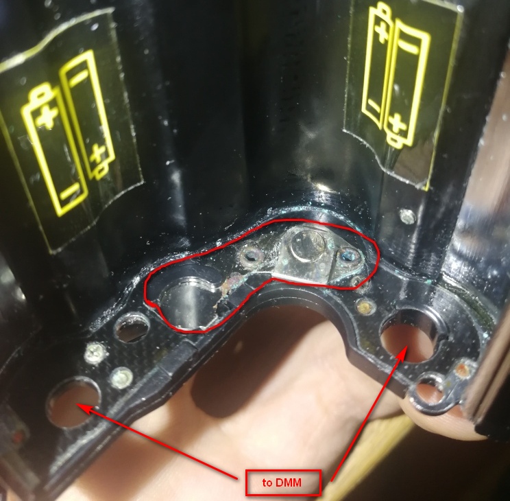

Well wait a few minutes, I am going to dig up my MB-20 to see state of affair :smile:
Well here I am. You have problem on contacts in upper side of holder.
Next step is to measure voltage on battery holder.
Here is a picture.
Put the probes of digital multimeter on that two holes, of course from bottom side on this picture (batteries with foil are in place !).
Range DC, 20V (or around, 10). Our construction with foil MUST show around 6V.
(If you have not DMM go to someone who have it.)
If there is not voltage play with foil and cleaning of contacts until it shows.
Eventually put foil also on the bottom central contacts of holder.
Until you have not voltage at that points we can not say if the problem is within the body itself.

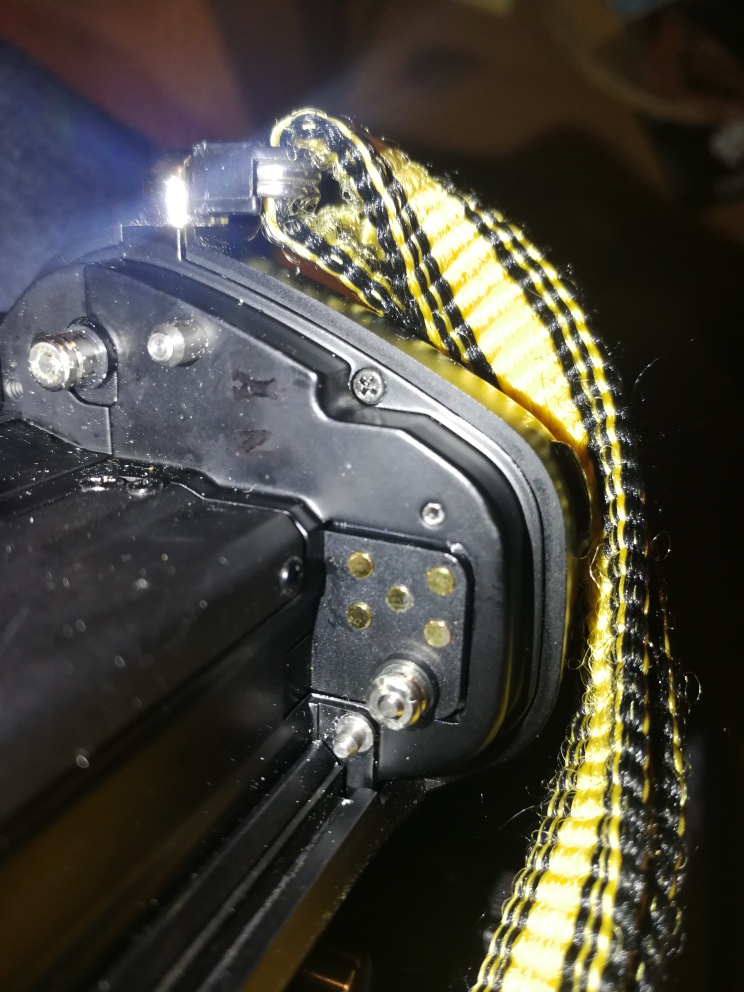

as far as i can see the 5 brass contacts are perfectly shiny and ok, i made a photo but that looks less klear than with the bare eye
Here is a picture:

Contacts on picture above are ok.
MB-20 do not use this brass contacts, only that chromed.

I would fill a small dish with vinegar and soak the corroded end of the battery holder in it for 24 hours or more. It might not help much but you got nothing to loose. You're not going to make the battery holder any worse than it is by doing this...
wouldnt it be better to get the proper screwdriver and soak the contact plate alone? not sure if vinegar attacks the plastic, probably not but i wouldn't want to risk it., i might try that tomorrow if i can borrow one at short notice
