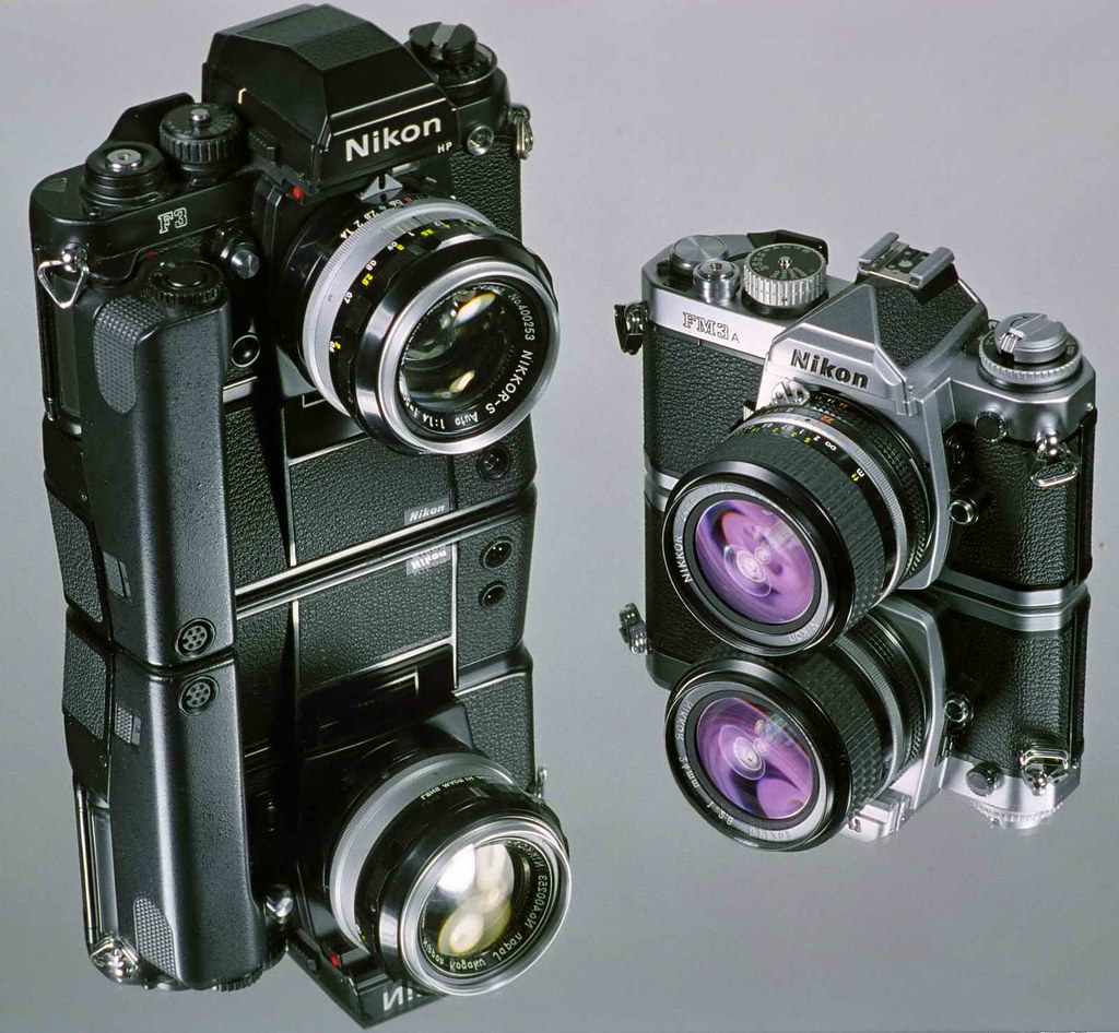

The best Nikon of the 70’s/80’s era was the FE/FE2 - IMO.
Don’t get me wrong, I adore both the F2 and F3 (and F for that matter- I own them all), but the FE series are just better on all counts as a user camera, unless you need a camera for driving in nails.
Well they're really good cameras, but if you were used to the 100% viewfinder of the pro models...they didn't quite cut it.
Happened to me the last time I was in Peru. I was carrying two Nikon FE...the film advance mechanism failed on one...no problem, I still have the other....a few days later, the shutter speed selector mechanism on the other on fell apart. The light meter failed and the camera appeared dead. I still had two weeks left in country! After several hours of carreful futzing with it and creative application of packaging tape, I was able to get it into the 1/90 position and finish the trip.
When we got back to Lima, I found a jewlery store that was able to get the first one un-jammmed but it was the last two days before we flew home.
