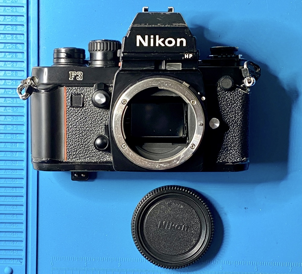

An intensively used F3 Press, as the exterior suggests, sits on my table:
There are no dents, the interior is clean, the titanium foil shutter cloth is without damage.
Dust and dirt have accumulated over time.
Not dramatic with the F3P, as it is a special version for reportage use and is equipped with extra seals.

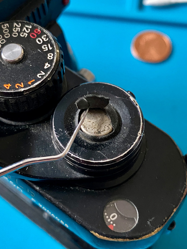

The rubber seal on the trigger has lost its function ...
... but which has no further effect.

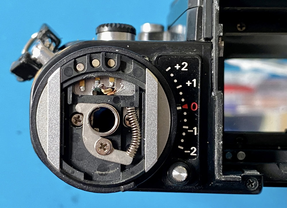

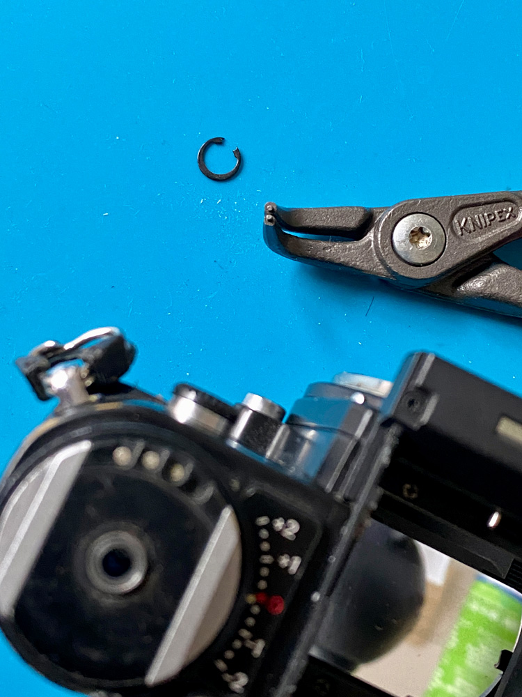

In order to find the cause of the problem, I start removing the hot shoe, which also houses the wheel.
Here are the required steps:

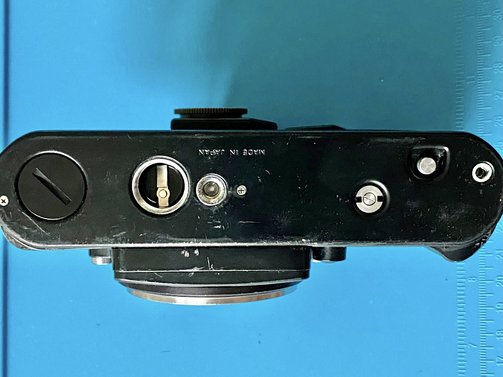

I block the fork with a screwdriver and turn the unit with the rewind crank counterclockwise.
Further disassembly:

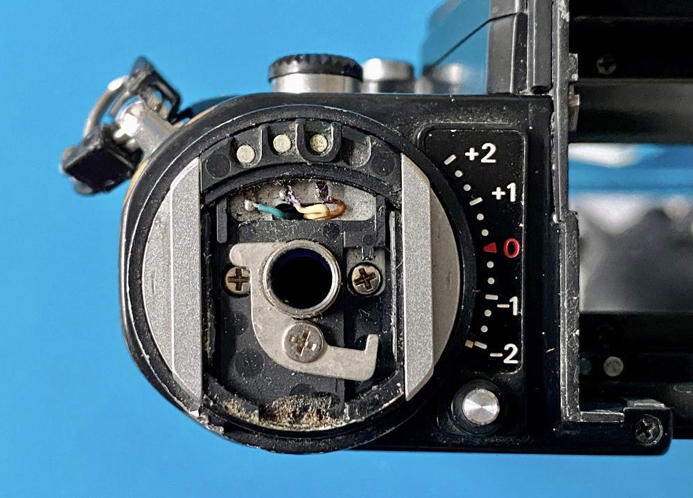

I unsoldered the three cables.
The hot shoe is removed.

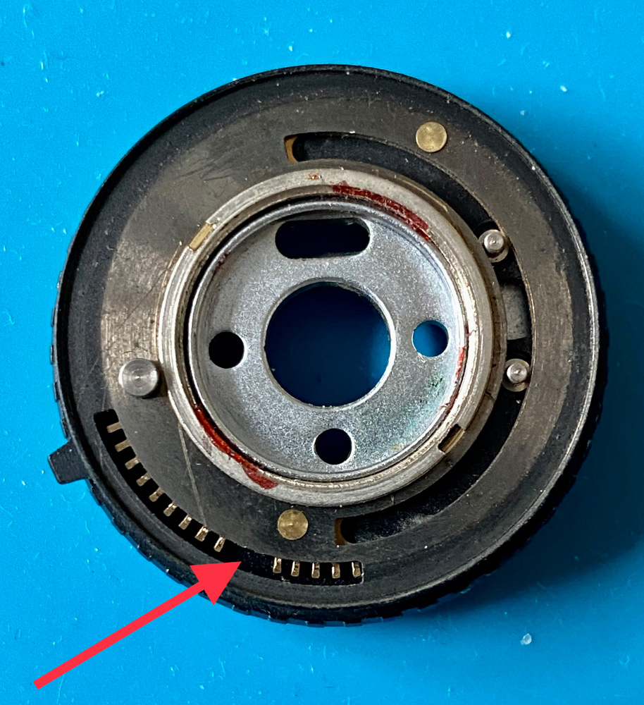

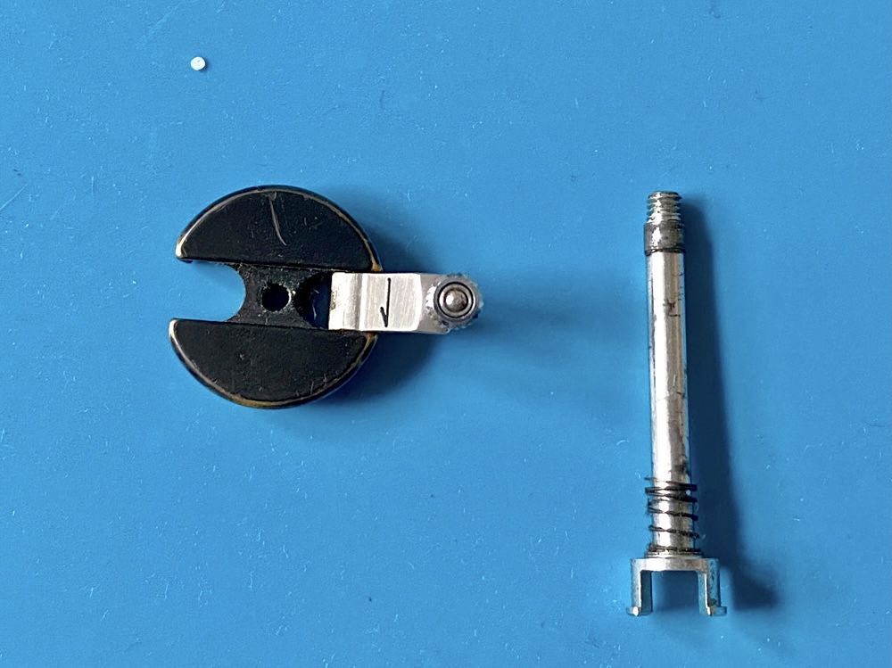

The cause of the problem with the wheel can be quickly seen on the underside:
There are three cogs missing between which the wheel’s pawl engages.
This makes it clear why the fixation for two values did not work.

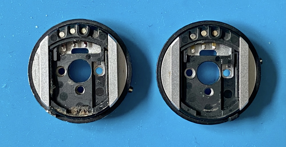

What to do?
Nothing can be repaired here.
Luckily I have a replacement.
Namely a hot shoe that I removed from another F3.
On the left the old one, on the right the "new" one - with all cogs.
After cleaning the area, the new hot shoe goes on the camera.

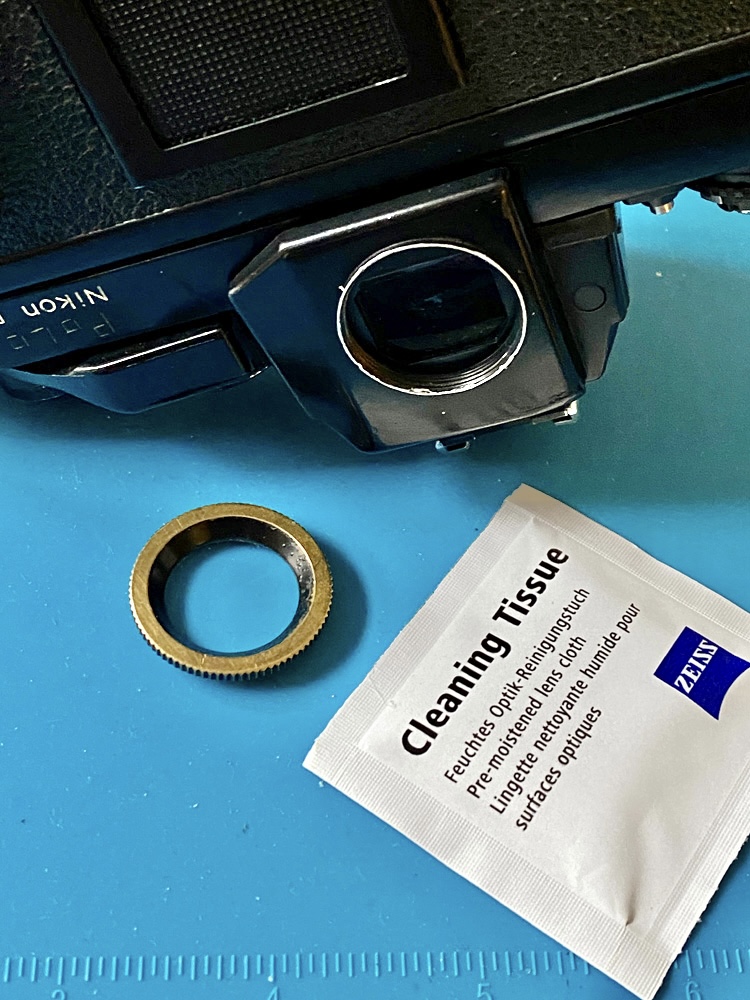

Zeiss takes care of the optical parts.
I found a new rubber mount in my spare parts supply for the beautifully polished eyepiece ring.
This means that glasses wearers can use the viewfinder again without any worries - scratches on the lens are no longer possible.
