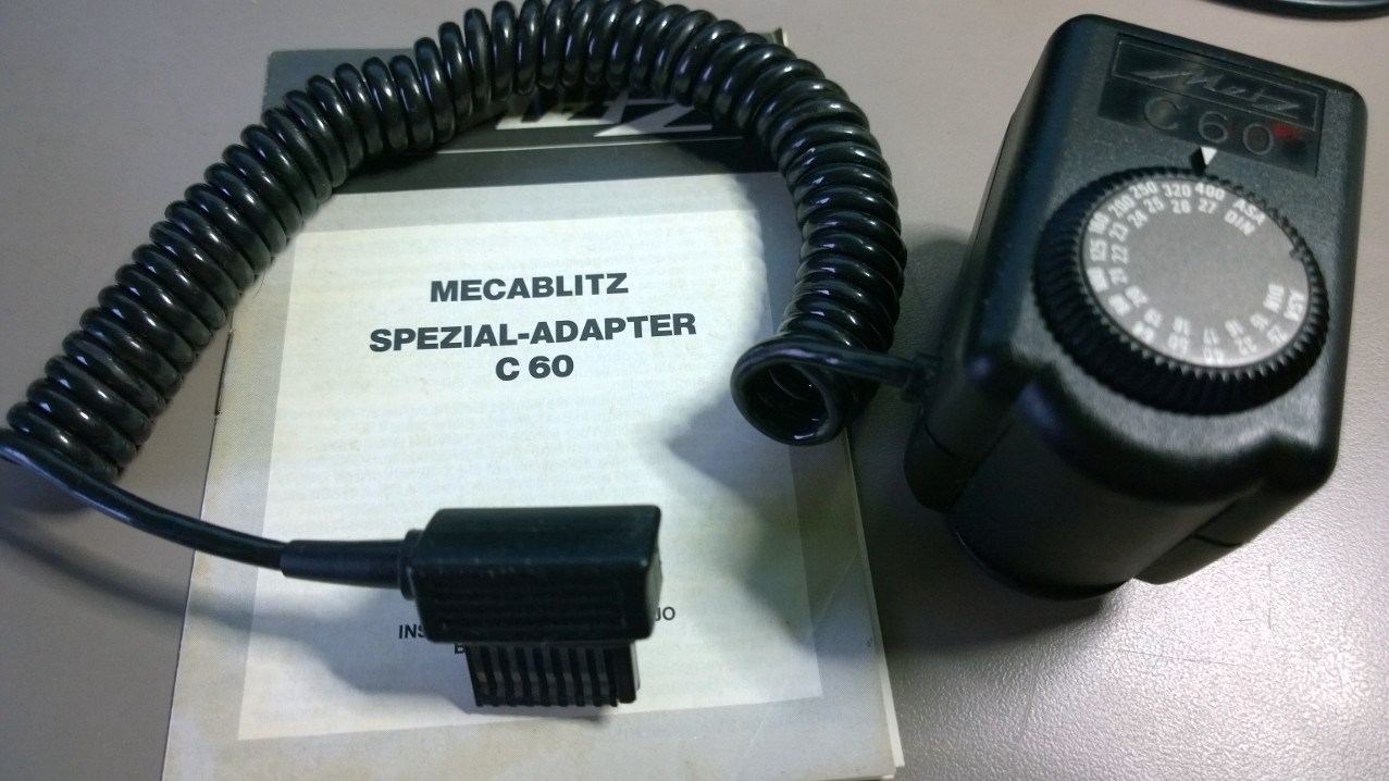

Attached is a picture of the C60 adapter it goes between the flash and the F3 hot shoe. Also part scan of the manual.

The OP asked about the TTL feature of the CT-5 which is has not got, whatever adapter.
The SCA C-60 adapter belongs to the SCA 500 series, it enables communication between the CT-5 flash and F-3 camera on lower lever.
