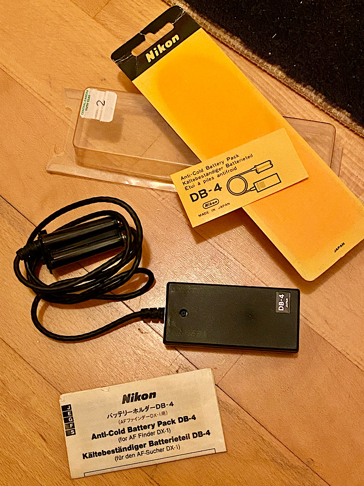

I have the Nikon DB-4 battery pack for the DX-1 viewfinder of the Nikon F3AF, new old stock.
Don't ask me how I found it 😊
A photo dealer in the US who I urged to send me the DB-4 to Vienna. It's so rare that I would have paid almost any price for it 🤪
The DB-4 is responsible for the DX-1 viewfinder of the Nikon F3 AF, which, like the DB-2, supplies the autofocus drive with two AA cells.
