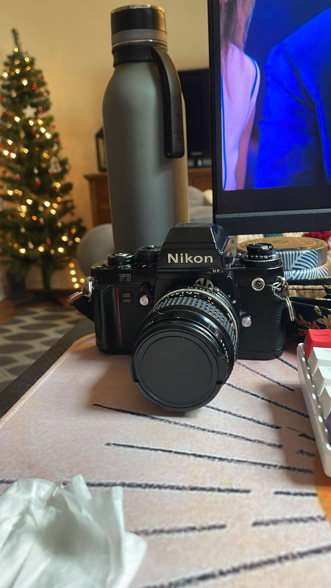

Visiting my husband's family on Christmas took an unexpected turn. It was December 30th and we were 30 minutes away from leaving to catch our train back home. Out of a series of conversations, I randomly mentioned how much I missed analog photography. It had been two years since I practiced reason being, after graduating college in 2021, I didn't feel like I was in a good enough place financially to buy my own camera. It was at that moment that my husband's mom went back in and came back with a beautiful-looking Nikon F3, still in great condition. It belonged to her father, who equally treasured analog photography and had passed away over a decade ago. This became the best Christmas present I could have received.
On our three-hour ride back home, I inspected this camera. While in college, I had actively shot on a Nikon F3 (photography was one of my majors). Other than a few scratches on the body from regular wear and tear, and understandably, dead batteries, the body seems to be in good shape. I compared the usage to my past experience with the other F3.
A few things I noticed:
1. There is no battery display - batteries need to be changed. There is no corrosion or damage in this area as far as the eyes can see.
2. The advance lever is very hard to use (maybe from being idle for years) and the camera shutter is not firing. I tried the backup lever and this advanced my film.
3. Everything else is moving just fine.
I am hoping a simple battery change will bring it back to life and shooting again...
4. 2024 New Year resolution: possibly set up a temporary/at-home dark room.
I welcome advice and more knowledge about this camera. I also downloaded the Camera Manual and have been reading it to brush up on my knowledge. Feel free to let me know if there's anything else I should check for. I will write an update hopefully later today when I buy two new 1.5 V batteries for it.

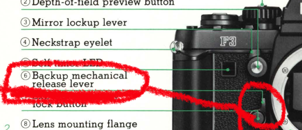

Just to be sure, when you trip the backup mechanical release lever, the film advances? Or do you mean after you manually tripped this, you can now advance the film? If the latter then that's a good sign and putting in a good battery should do the trick.
I used the tiny lever (circles in the attachment) to manually advance the film. I read this online. Is this a good sign?
How do I manually trip it? I thought this was what it meant. Sorry, I’m a bit rusty on the terminologies.
Yes, that's how you manually trip it. The question behind that was, is the advance lever now freed to move? If so, leave it be until you can get batteries into it (I've read that SR44 are preferable to LR44).
Thank you for clarifying! Yes, it is. I have been able to move the advance lever since doing this.
It took a little bit more pressure than usual (probably from sitting idle and dusty for a decade). I’m going to wait for the new batteries before trying to move anything else.
Your terminologies are correct. I just wasn't sure about the sequence but it sounds like you should have a good working - as well as good looking, camera that is capable of giving you analog photography joy!

Battery Update: I have replaced the batteries and was able to turn the camera on and see the LCD Exposure Info. Yay to this.
The advance lever and the shutter are now firing! 🤩 The ring around the power switch seemed to be cracked and I think needs to be replaced. It seems to be on when it is supposed to be off.
However, I do think that I need a new lens since I can't get the focus ring to move. But at least, I know that this can easily be replaced. Thoughts?
I am really happy though at how well it is working so far. When I can afford to eventually. I will get a camera repair person to take a look at it and do a CLA as has been recommended.

That lens looks like it might be the 55mm f/2.8 Micro Nikkor?
If it is, then as it has been sitting literally for years, it will be quite stiff; really stiff.
It is winter where you are, the cold doesn't help those lenses. This lens has very long helices and you need to twist and twist, then twist some more to focus. As a result the lubrication with none usage, does gum up somewhat. Another aspect of the 55mm Micro Nikkor is that the lubrication can and does sometimes go to water, so to speak, and when it does it will often spill onto the aperture blades.
I suggest that you place the lens near something warm, or into a warm spot and let it get warmish; this may help.
It is summertime here and I used my Micro Nikkor last week after it sitting around for a couple of years. It was as stiff as anything, so I placed it in the sunlight for an hour and with an ambient temperature of 30ºC it was all of a sudden back to normal.
Thank you, Nick, for the welcome, and thank you for the very helpful advice on these lenses.
I will put it close to a heater to see if it can help loosen it up. I can move the aperture blade on it. I hope the focus lens will loosen up.
In the meantime, I had another lens (AF Nikkor 35-80mm) that I put on the camera so I could use it.
