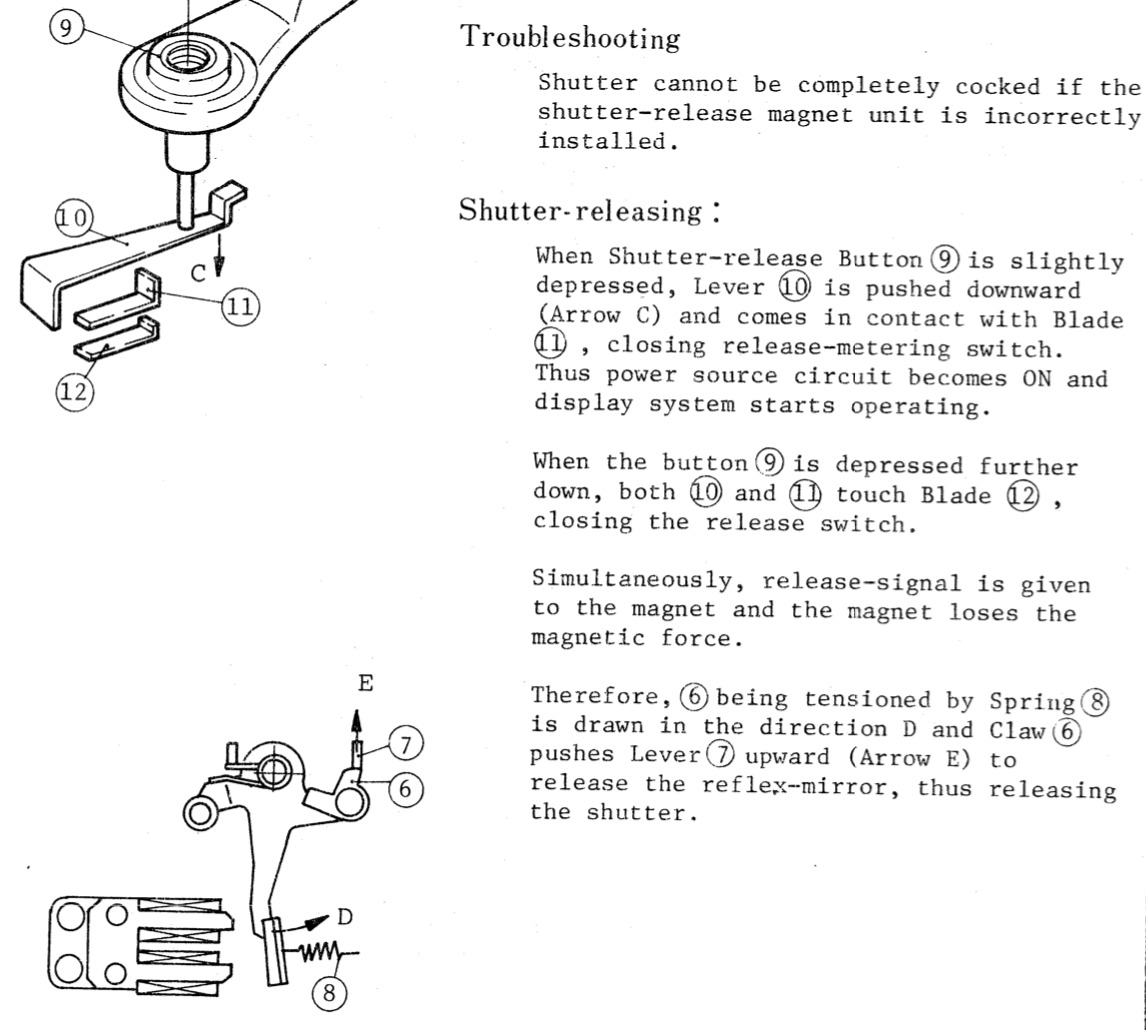

I don't know the answer to what is wrong for sure, but there is a logical answer to this question, which may help guide where to look. The shutter release on cameras with a half-press is often actually two switches (electrical or mechanical). In the case of the F3 the first switch on half-press powers the camera on, and the second switch fires the shutter. In your camera the first switch in the body isn't working, so the camera doesn't power on. But if you power it on by half-pressing the MD-4, then the second switch in the body can close its contact and fire the shutter.
It might seem like pressing the body release all the way should provide power to the camera and allow it to fire, but for whatever reason the F3 isn't wired that way.
Here is a screenshot from the repair manual showing mechanically how the two switches work. (Ignore the "troubleshooting" paragraph as that's related to a different item on the same page.) It is possible that the problem is not in the mechanics, but somewhere in the electrical contacts: for example if part 11 is disconnected from the power circuit, but part 12 is still connected to the release electromagnet, then it's possible that pressing the button all the way would not power up the camera, but would still fire the camera if powered up from the MD-4.

Thank you for the insight. It seems logical and I had thought that the half press was the reason for all the issues (my notes on photo.net, same posting). You have given me all I need now to probably go straight to the issue.

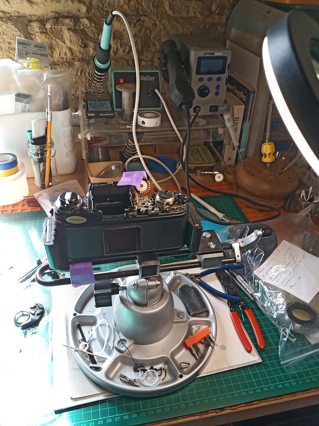

Update. Fixed ;-)
I suspect that the power issue was just dirt on the half press contacts and/or the power sw under the advance lever. I removed the advance lever assembly and the speed dial as per the guides and cleaned the contacts. I also cleaned the power switch contacts. Not easy because they are so small. I used some stiff paper soaked in contact cleaner, holding the contacts closed and moving the paper back and forth. After this using a small probe to push the half press contact down the lcd came alive,,, full press and the shutter fired (I had it set to bulb when I removed the shutter speed dial so that was all I could test at the time).
Due to it being such a quick clean and it looking good I had a general clean up, little lube in one or two spots and reassembled to test further. I didn't take any photos because there was nothing out of the ordinary to see.
Once in a state where it could be advanced and then fired over and over and I could adjust the speeds.
All the speeds from "T", "B",, and slow speeds up to "60" fired fine, seem correct and they all displayed correctly in the lcd display.
Then instead of "125" it showed "80" in the display and remained at 80 all the way up to "2000" and "A".
The last time I owned an F3 (an HP) was in the early 90's. So bare with me.
I'd had the back off (as you need it off or open to get the advance mech. plate back easily where the counter reset pin is). By the way, for anyone doing this for first time I always place a piece of an old business card or an old cut plastic card over the shutter and tape it there while working with the back open or off, trust me,,, your finger will ruin the shutter if you don't do this!!! ;-(.
Then I remembered the F3 defaults to 1/80 until frame 1 for some reason (remembered after a cup tea and readying the manual). So I replaced the back, advance to frame one and bingo,,, all other speeds good. Even the illumination in the LCD works ;-)
I have a working F3 !!!! Very happy.
I might now removed the left side and just give the ASA dial and flash shoe area a good clean as the ASA dial is very stiff and might have dirt it it.
Just need to source an exposure memory button now (in the mech, shutter release) and maybe a better focusing screen as someone has marked it.
So probably just a bit of light oxidisation or debris on the electrical contacts.
And as per the CC flow chart,,, the issue was continuity from TP3 in the base to the two power switches (main and half press).
Hope this helps anyone with same issue.
Cheers all and thank you..
