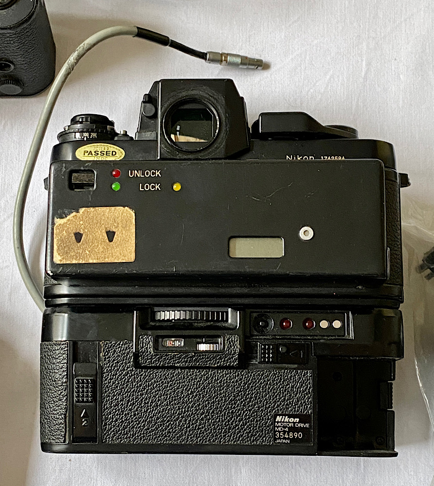

Now I'm going to look at the F3 pin registration, but after a quick test it should be OK.
I'm excited to see if I can find out how it works on the adapted MD-4, the box on the back of the F3 also has electronics with LEDs built in.
Nikon F3 Pin Registration
I can't say much more about this modified Nikon F3 than I have already said in this post.
Post in thread 'Collection of spare parts for Nikon F3 and F3/T including a F3 Pin Registration'
https://www.photrio.com/forum/threa...ing-a-f3-pin-registration.203101/post-2743547

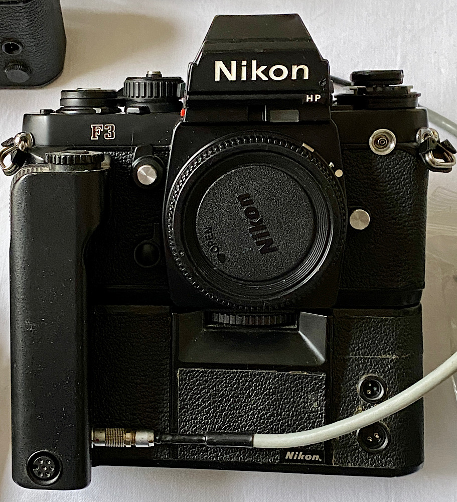

It is an F3HP with a modified film guide and a special back door that is connected to the MD-4 Motor Drive via a cable.
It was probably used for montage of shots.

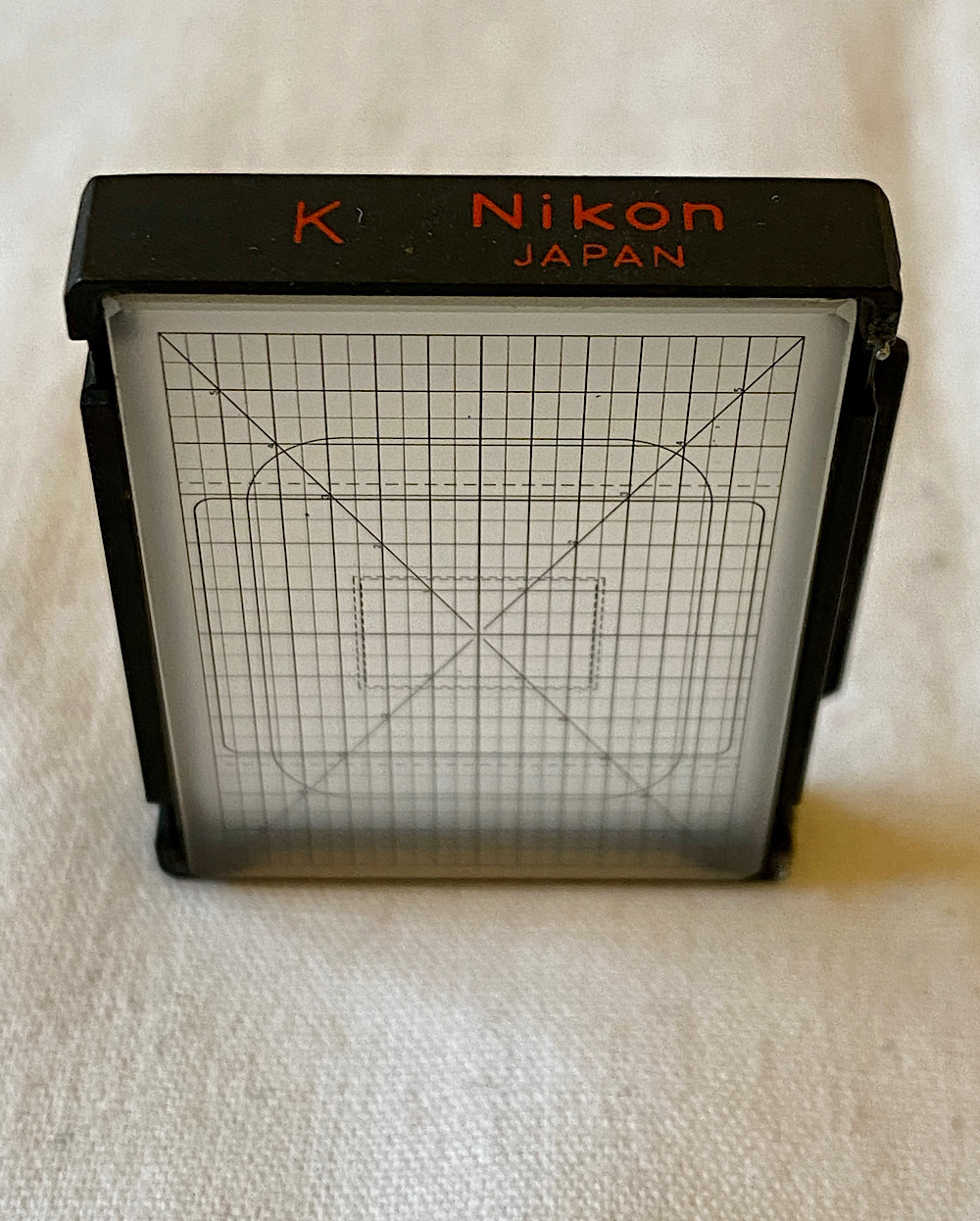

The focusing screen is interesting, as it has markings for the alignment of templates:
The camera works, with a standard back it could be used for normal photography, the focusing screen can be changed.
The F3 pin registration is rare and certainly of interest to collectors.
I might sell it, it doesn't appeal to me.

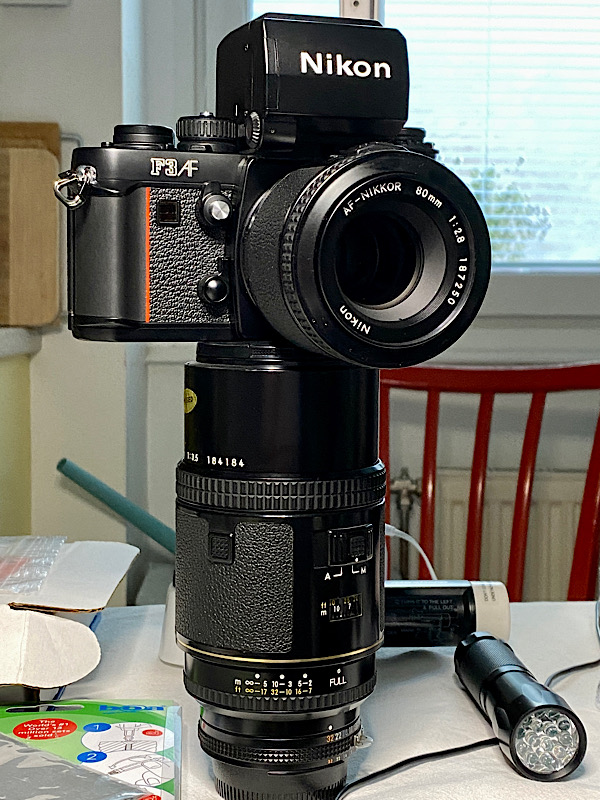

The F3AF and lenses are still beautiful. Is it responsive in Aperture priority mode? ie is the electronic shutter responding rationality? Even if the display is crazy if the shutter is still making good exposures 🤔 😎

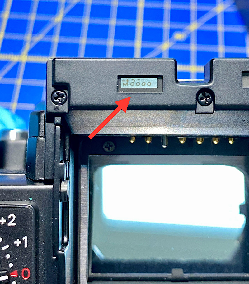

Yeah! Everything works except the display.

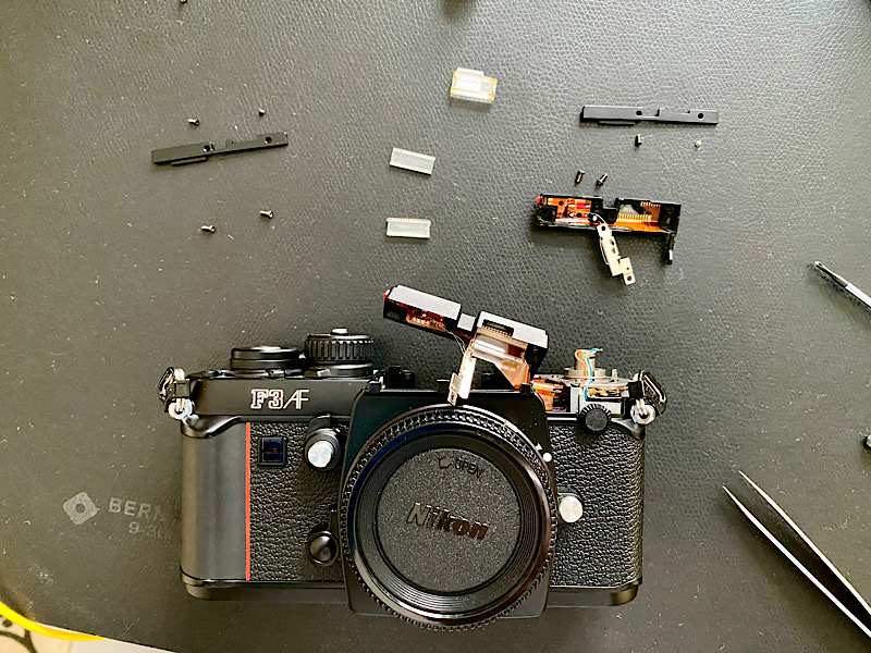

In the viewfinder I see a nasty surprise that remains even after removing the DX-1: The LCD display is faulty.
I'm prepared for this eventuality, I've just added two F3 LCDs to the spare parts inventory.
Replacing the display should solve the problem.

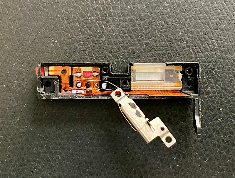

To do this, I remove the replacement LCD from its holder.
Working with magnifying glasses.
The replacement LCD is inserted and secured with its cover plate.
But unfortunately this LCD also shows the faulty digits from before.
So it can only be the circuit.
I find a suitable error pattern in the repair manual and follow the troubleshooting instructions.

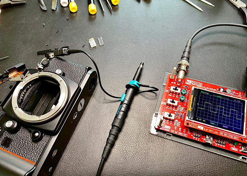

I use the oscilloscope to measure the voltage curve at the LCD contacts in the camera.
The measuring point is the first contact in the top row.
The rectangle curve displayed on the oscilloscope corresponds to the specification.
According to the repair manual, the LCD is still defective - but that is ruled out after the replacement.

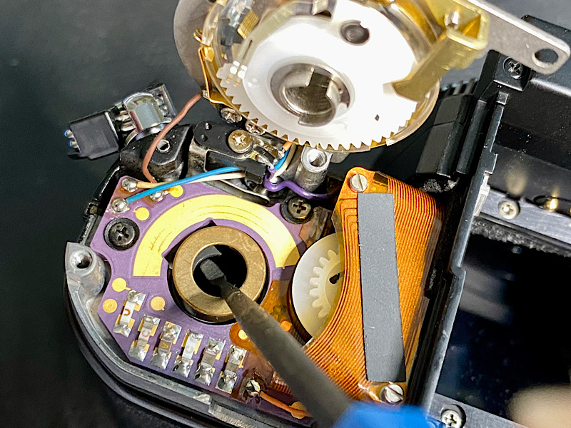

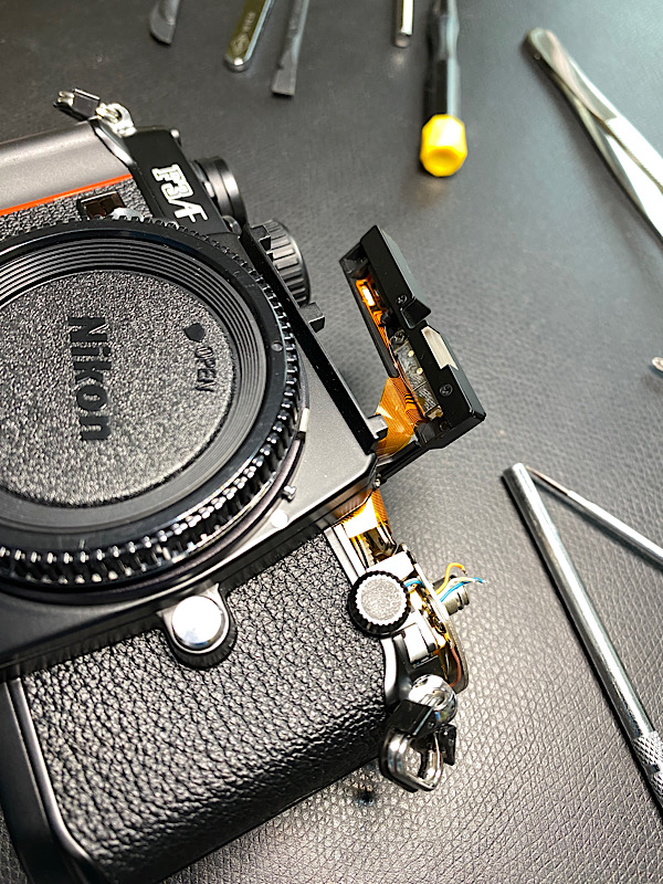

Since I had closed the backdoor after removing the rewind crank and the lock cannot be released, I open the backdoor as an emergency measure :wink:
To do this, I unscrew the FRE (Functional Resistance Element), which records the aperture setting, the ASA value and the exposure compensation, and lift the hook of the lock.

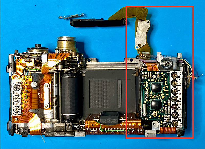

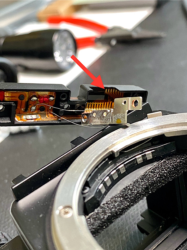

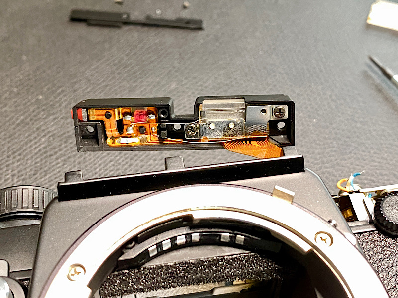

In the Nikon F3 repair manual under Troubleshooting, a similar LCD error pattern to my F3AF is listed with information on where to look on the FPC (flexible print circuit) to check for separation of a solder connection.
The location is on the back of this part of the board.
Here is the exact position on the back.
To get there, the following will be necessary:
  1. dismantling the two top covers including the assembly with the FRE (functional resistance element) on the left side,
  2. dismanling the LCD housing above the mirror box,
  3. removing the front panel,
  4. loosening the FPC in the marked area to be able to see the back.
I don't know if I should do it.
I don't see any problem if the process works as I imagine.
But I had problems with the coupling of the mirror and shutter mechanism on my F3P when I was reinstalling the front panel.
I was also unable to identify tiny spacers that fell out of the case when I opened it. The repair manual was silent on this.
If I'm unlucky, the new F3AF, which works except for the LCD, will be a total write-off after this procedure. And I don't think that anything in the electronics will come loose on its own at this point.

Faulty LCD display: Identifying the area to be checked according to the repair manual
The troubleshooting section in the repair manual states that if the LCD display is faulty (which corresponds to the one in my F3AF), a specific checking land on the left front board should be checked. On its underside.
To get there, the front panel of the F3(AF) must be removed.
I look at the area on a practice F3 that has already been dismantled and is largely identical to the F3AF.
Checking Land #49 should be checked for separation at the solder joints to the next board part.
Loosen the two screws.
The circuit board can now be unfolded.
All circuit board parts of the F3 are connected to each other, so the circuit board is one piece.
Rotate the camera 180 degrees.
Here is the part of the board that needs to be checked (see the illustration in the repair manual above).
The two arrows point to the soldering of Checking Land #49. Once on the lower part of the board and once on the connected upper part.
I doubt that anything has changed on my F3AF by itself.
That's why I'm leaving it at this exploratory tour and won't open up and check my F3AF.
