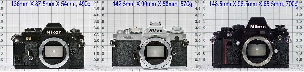

Nikon didn't really embrace the smaller format introduced by the OM series but they did shave weight noticeably. The F and FM series are all within a few grams of each other with exception of some of the special finders.
FG-FM3A-F3 by Les DMess, on Flickr
Selection 71 by Les DMess, on Flickr
As you can see, the FM isn't all that larger or heavier than the OM and only the Pentax MX managed to get dimensions a tad smaller then the OM and have a bigger viewfinder magnification. BTW, how do you prefer your viewfinder magnification - 0.92X on the OM1 vs 0.83X on the FM/FE series? The MX has 0.97X.
