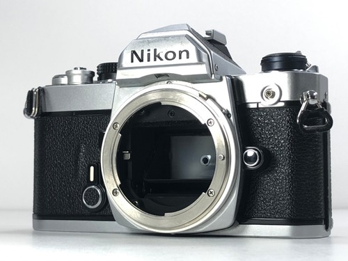

An FM for $99....

The original FM develops one defect over time, a desilvered prism do to foam on the top of it.
I bought my otherwise perfect current one for $68 shipped because of this.

That FM looks kind of beat-up.
Great deal on the F for someone like me, who does his own camera repairs! Dunno what I'd do with a second almost identical one though.
