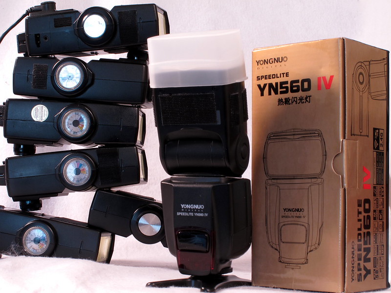

For decades, the Vivitar 283 was my workhorse electronic flash for shooting portraits, action, interior architecture, weddings, still lifes, macro, and candids on my Nikon F2. I used them mounted on the camera and off the camera. I triggered them remotely with optical slaves, radio slaves, and long sync cords. I used them mounted on light stands with umbrellas, soft boxes, and large diffusion panels.
Over the years, I owned and used eight of them. As they aged and stopped working, I repaired or replaced them. When I got down to only three working units, I decided it was time to replace them with something newer.
Since I shoot with a variety of cameras (e.g. small format, medium format, large format, film, digital, Nikon, Canon, Fuji, Pentax, Olympus, Calumet, and a few others), I prefer not to use dedicated flash units. The Yongnuo YN 560 IV, like the Vivitar 283, is a flash that is not dedicated to any specific camera brand. One major advantage the Yongnuo has over the Vivitar is that the optical slave, the radio slave, the zooming flash head, the variable angle flash head, and the variable power output are all built into the Yongnuo. They were separate and expensive add-ons for the Vivitar 283.
One important feature that the Yongnuo 560 does not have is automatic exposure control. Most dedicated flash units have this feature. Even though the Vivitar 283 was not a dedicated flash, it had this feature. This feature in the 283 relied on changing the duration of the flash output to control the exposure. At the full power setting, the flash duration could be longer than 1/1,000th second. At the lowest power setting, the flash duration could be as short as 1/20,000th second.
The Vivitar's automatic exposure control feature was something I rarely used. The main reason I rarely used it was because film, unlike digital, has problems with reciprocity failure at low power/short flash duration settings. Therefore, I primarily shoot only at full power. Instead of relying on automatic exposure control, I routinely used the flash guideline number and/or a handheld flash meter to determine the correct exposure.
By the way, at full power, my Yongnuo puts out 1/2 stop more light than my Vivitar at full power.
I have been so impressed by the construction, performance, and price of my first YN 560 IV that I immediately purchased three more. I look forward to the YN 560 IV becoming my new workhorse for the next few decades.
Yongnuo YN 560 IV

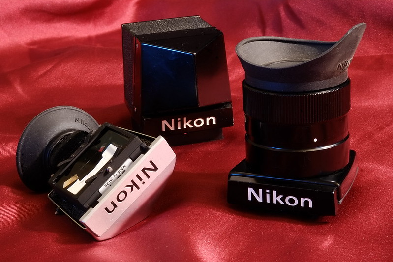

As RLangham stated, even the non-metered prism had a small pin protruding from the left side of the prism (see pin on DE-1 pentaprism in image). I have been using F2 cameras since 1972 and have never once used that pin.
DE-1 prism on left
by Narsuitus, on Flickr
