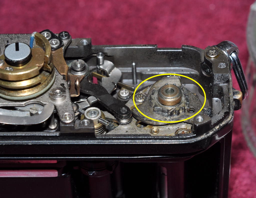

My main camera body was regularly locking up after advancing the film, and the shop is saying it's an issue with the gear on the winder slipping a tooth or two. They're saying it's unrepairable, and are offering a discounted price on a new camera body. They recently (August 2024) performed a full CLA on the camera, and said that there were no issues with it, but this problem showed up less than a year later after only light use. Is this problem really as unrepairable as they say, and is it something the initial CLA should have noticed before it became a problem? I'm stubborn, so the camera's headed to Sover Wong if I can snag a booking when he reopens them.

"Changed out the winding mech plate with ratchet paws, no change. Suspect the ratchet
gear on top of the winding shaft is damaged. Don't have new part to replace it.
We have several F2 bodies without meters that could be CLA'd and sold for about $200 as
a replacement."
If this part is bad, one would need to find a camera body to harvest the part.
Damn. I'll ask to see it when I next head down there. Is it the sort of thing that would have been noticeable before it failed? I really don't want to have to buy a new camera right now.
I have worked on a number of cameras but never an F2 I always considered them the most indestructible 35mm ever made. But as I look at the photo of the gear above encircled in yellow, it looks terrible. Is this a picture of a bad one? It looks like it was a rather fragile under-engineered gear. Inconceivable to me that puny weak looking gear like that would not have been torn up by an MD-2 motor drive in short order. I have a very nice F2 in mint condition. But if it has a pitiful looking gear like that in it, I believe I'll stick with my F as my daily camera. Is the gear in that picture torn up, or did it originally look like that? That looks awful.
What are you seeing that looks awful? It's dirty but the gear/take up ratchet in the photo looks fine to me, and given it's thickness makes me wonder how the OP's could loose a tooth. It does actually look a bit more substantial than that of an F.
It looks like a perfectly fine and functional part for a solidly-made camera that has seen decades of probably fairly intensive use. I don't understand what problem you have with that part as shown. And either way, it doesn't have any relation to OP's question to begin with.
