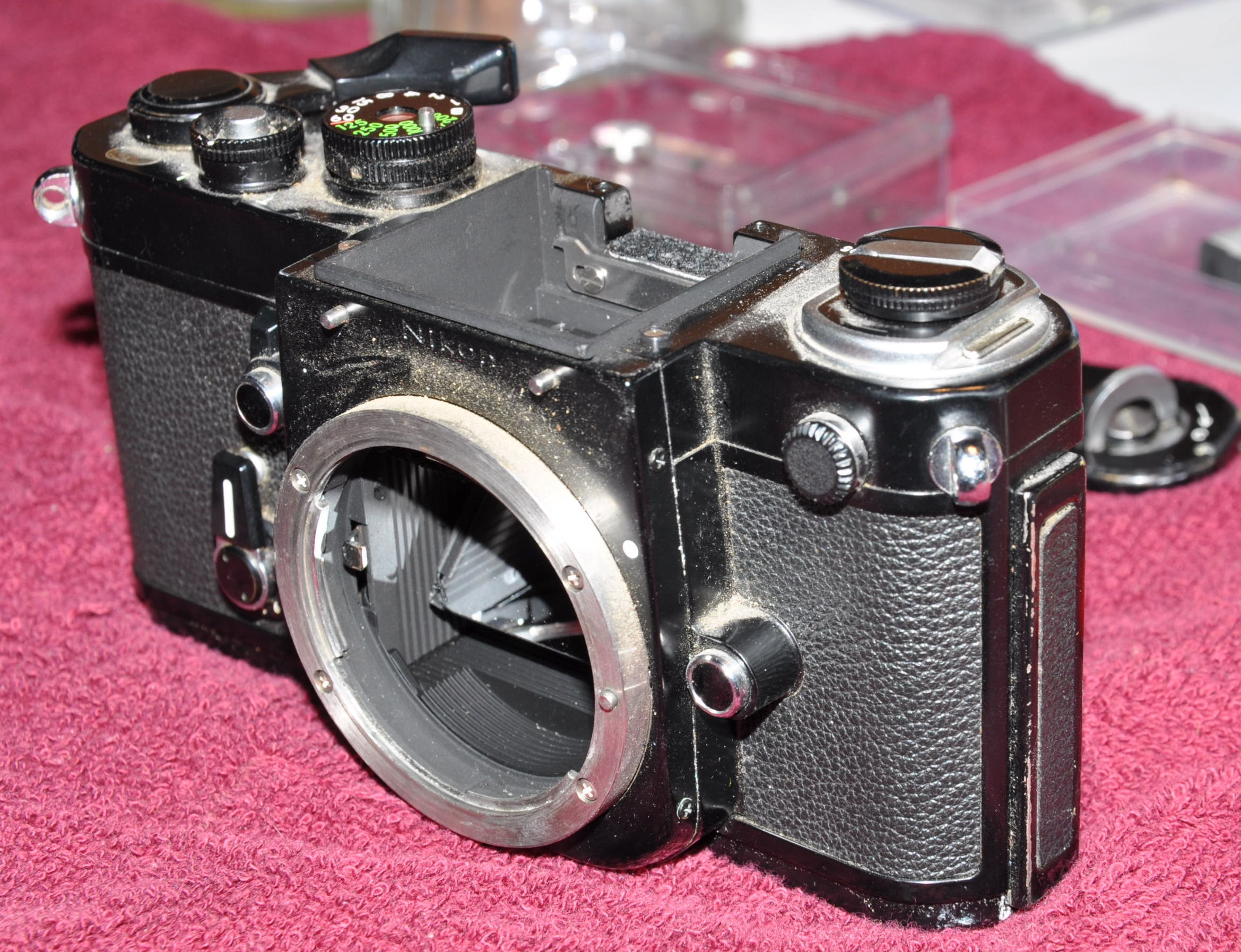

I did not go into detail about the re-painting. What I did was to do the black in lacquer and after it was dry I did the white letters in enamel. That way I could fill in the letters with a little overflow of white and wipe with paint thinner. The paint thinner does not harm the lacquer. After that there was just a little haze and that was removed with some rubbing compound.
Actually, I did not like the gloss finish, so I re-did it in semi-gloss.

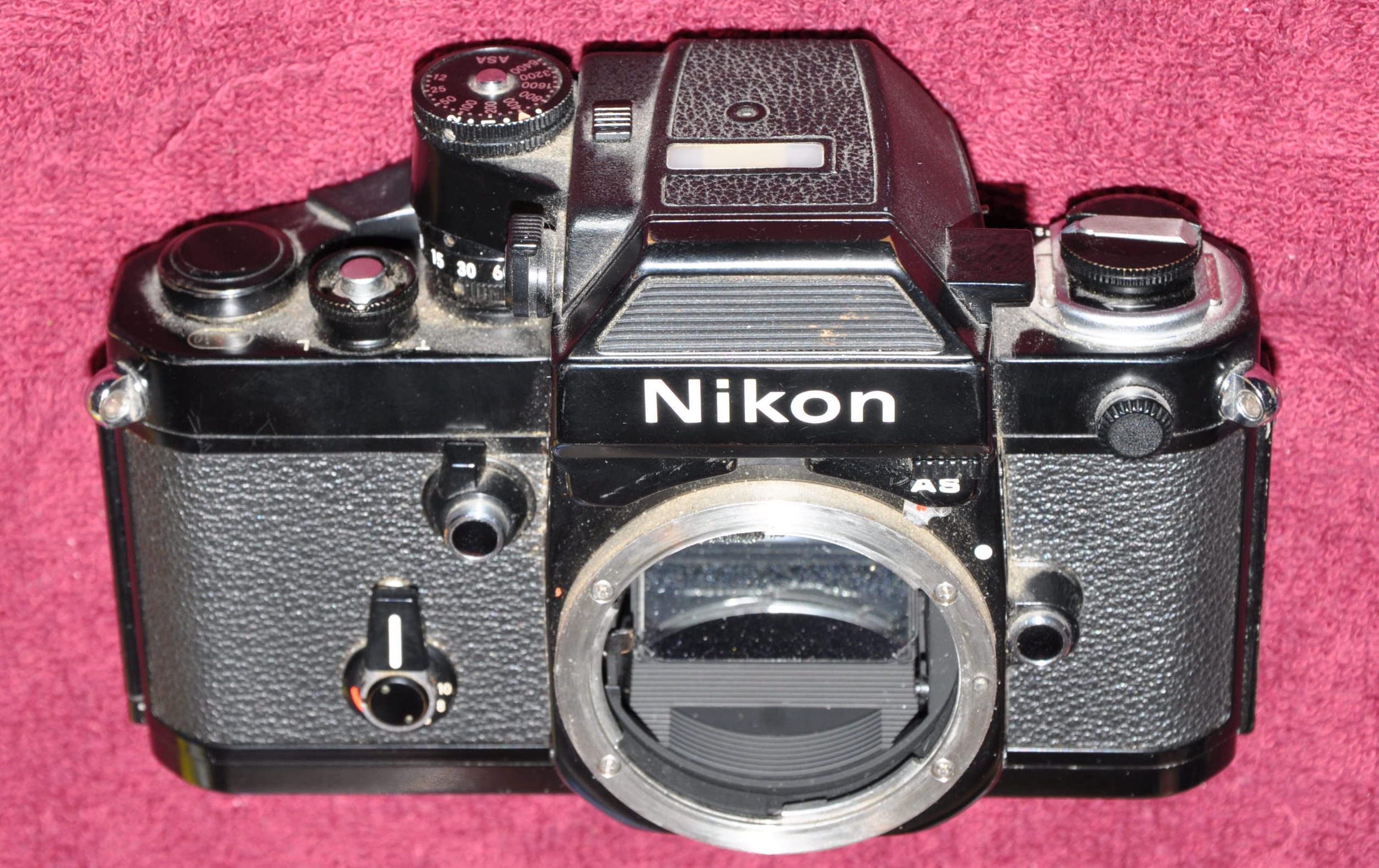

So, to complete the Holy Trinity I got an F2AS. Knowing it was an F2AS, I bid pretty high. I saw it was dirty, but the cap still on the PC outlet, made it look like it was low milage and just dirty.
The camera was listed as 'non-functional' as it had a somewhat severe dent in the back and it would not open (for the seller). Obviously I got it open.
It was not too hard to straighten out the dent. In fact the metal is very soft; it is easy to overdo it.
The dirt was put there to protect the paint job.
Under the dirt, however, It was not like that first one with the pleasent patina from use. This one had some scratches and dents from flagrent abuse. Hardly any film was run through it. Inside the back it is pristine. No rub marks from cassettes in and out, etc.
It did clean up nice in the end. I was expecting it to, as I paid twice as much for this one.
The serial number dates it to 1977.
Everything works as it should. It has never been opened from what I can tell, based on the lacqer still on the adjustment screws for the shutter.
I did not need to even open the DP-12 as it was still in calibration. Same with the curtain speeds. No tweaking needed.

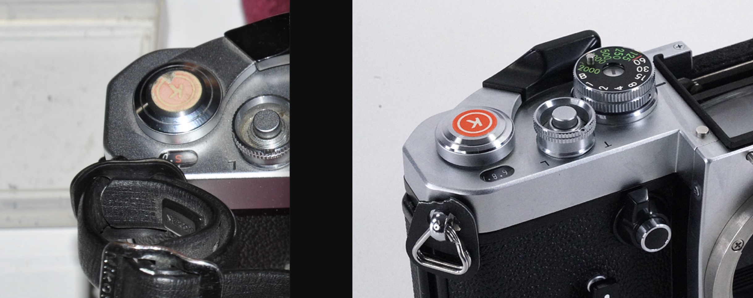

I found out the meaning of the sticker on the wind lever. Apperantly this indicated the focus screen originally sold with the camera. In this case "K."
