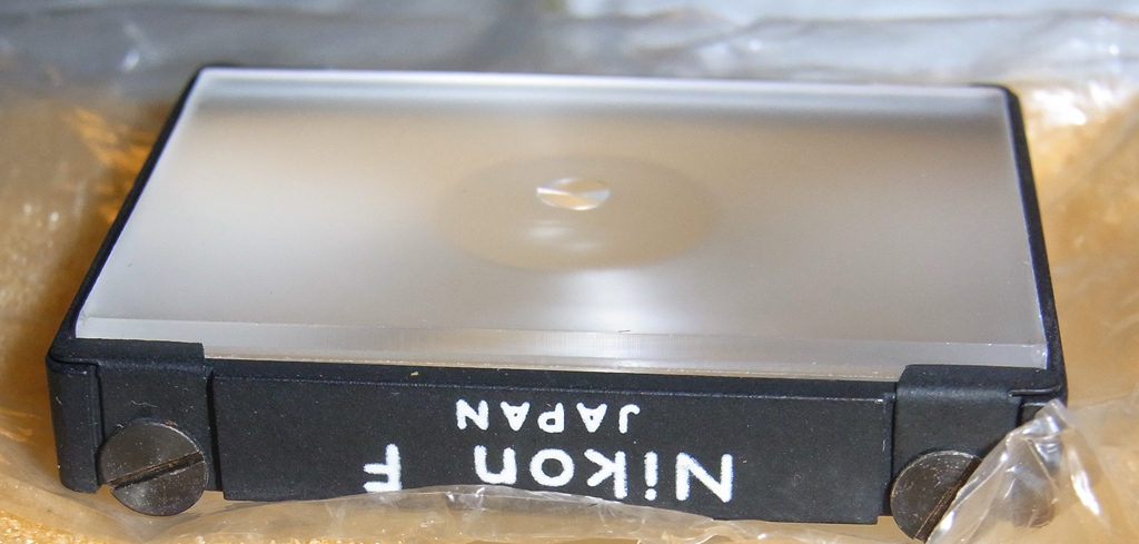

You should test if the actual focus at the film plane is off.
There are shims between the frame that the screen sits on and the body. Remove the screen, will see some screws that hold the frame in place. There were two metal shims on the Nikon F that I "accidentally" discovered after cleaning the foam from the mirror bumper. I dented one- managed to get back into shape. Not hard.

Yes, that's correct. I believe your groundglass is too far from the mirror. Being further away, if you set the lens to infinity (and an object at infinity is in focus at the film plane, which you've confirmed), then a much closer object will appear in focus on your too-far-away groundglass.

The glass of the focus screen sits in a frame: does it show any signs of having moved?
Foc Screens are readily available, and fairly cheap.

Like I said earlier. Somebody had disassembled the focusing screen and it's curved glass and reinserted the screen upside down.

Or maybe the wrong screen?

The curved portion of the glass should be on the top of the screen, the "Nikon F" label and screen type indicate the top of the screen.
The frame is ~5mm thick. If it were upside down, the focus would be much farther off. The bottom of the flat screen extends "ABOUT" 0.5mm past the frame. If the bottom was "hung-up" on the metal of the frame, the error would be about what you are observing.

Brian, thanks for the photos,that’s exactly how mine looks. I’ll get a screen ordered today and do a swap.
