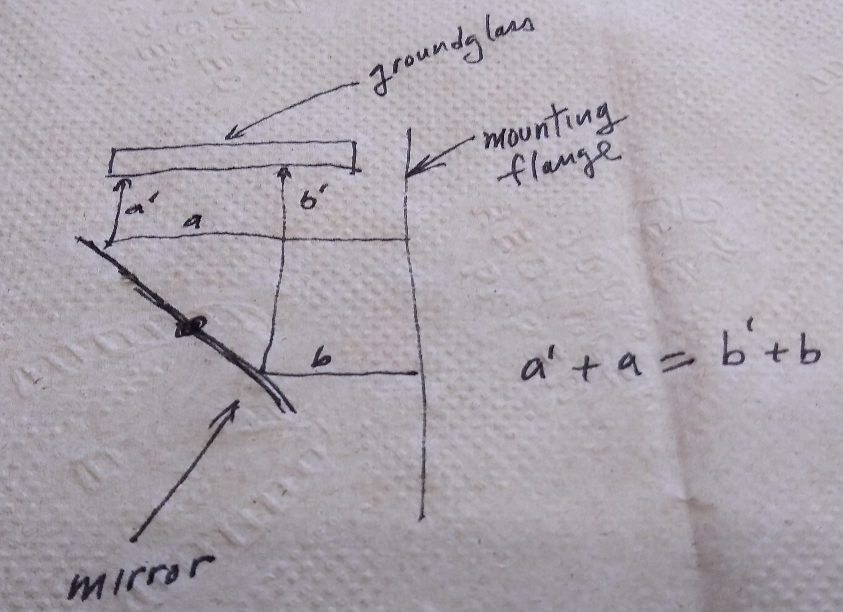

not to derail, but I have a question about mirror position: if the mirror is out of position, would the focus error manifest more at the upper part of the image than at the lower? Assuming the pivot point of the mirror is fixed of course.
I would think the same.
No

Draw the lines - you'll see distance is the same regardless of upper or lower part of mirror.

The question of mirror position: if the mirror was at the wrong angle (meaning the pivot point at one end is fixed), then what happens is the image moves relative to the focusing screen. The center of the image is displaced and the image rotates, so the top and bottom of the image focus at different places. If the entire mirror rather than pivoting moved forward/back or up/down, the image would be displaced away from the focusing screen, causing a focus shift. But it's hard for me to imagine that this is the root cause of the problem unless someone was really monkeying with the insides of the camera. The Nikon F is a very robust camera if not horribly abused. I've had one for over 30 years and have never even dreamed of adjusting the mirror. If I have good fortune, hopefully I'll have it for another 20-30 without touching the mirror, and after that, I probably won't be able to lift it.

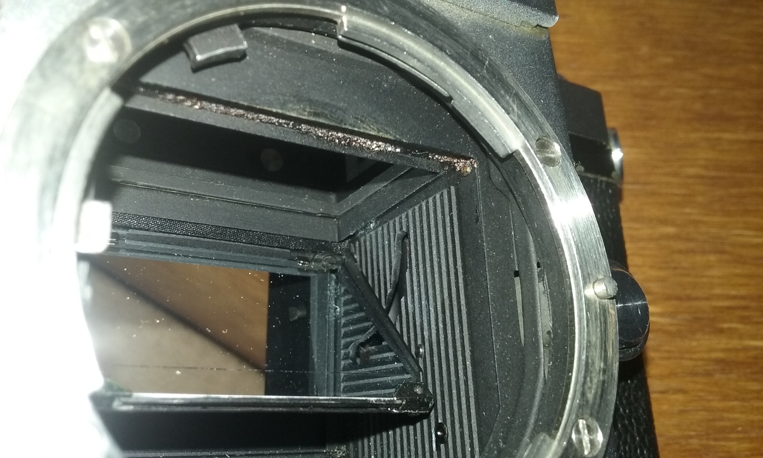

1566664157021830228648.jpg 1566664330147-246355255.jpg 1566664368115-1946556712.jpg 15666643989971425191838.jpg
A few shots of the mirror, maybe somebody will see the problem.

I just looked at my 641xxxx Nikon F: your mirror looks just like it does, small cut-outs at the lower edges..
With the lens at infinity, the actual focus through the viewfinder is too close, but the actual focus on film is good: that means the path to the focus screen is too great and needs to be reduced. There are shims under the focus screen- removing these might be enough. Otherwise, polishing down the viewfinder frame might be enough.
This is an early Nikon F. If you want a working one, you could put this one up for trade for another F body.

I tried removing the shim, no noticeable change. I took out the ~2mm thick spacer that sits on top of the shim. That moved the focus just a little bit too far the other way. I could make a custom thickness spacer, but that’s not really fixing the problem.

What is that horizontal line across the bottom of the mirror? It looks like a scribe mark.

I see the problem: your picture #3 shows the cause of the error. The frame that holds the screen is at an angle to the grooves of the light baffles of the mirror box. The frame should run evenly across the tops of the lines.
Uploaded shot of my Nikon F. The metal of this frame is very thin and easy to bend - I know first hand, after screwing it up being too rough cleaning the old foam of the mirror bumper out. I had to take it out and bend back into the correct shape, then insert into the mirror box. Whoops.

This is a shot of the mirror box from my Black Nikon F that was professionally CLA'd some 20 years ago... I did not screw this one up!
I also checked the focus on the camera that I screwed-up then repaired: the focus through the viewfinder agrees with the distance scale.

I finally got back to this project and I’ve found the problem, it’s the mirror. As the shutter is wound the mirror moves moves up about 2 mm and suddenly all is right in the world. I still can’t believe that in all the time I was messing with this that the shutter was always released. I guess just from years of habit, cock shutter, shoot. Don’t leave the shutter cocked.
