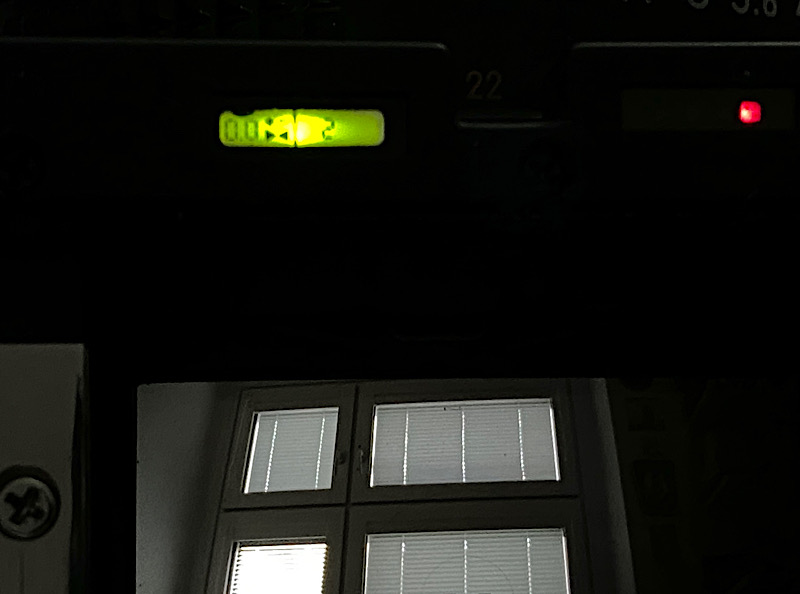

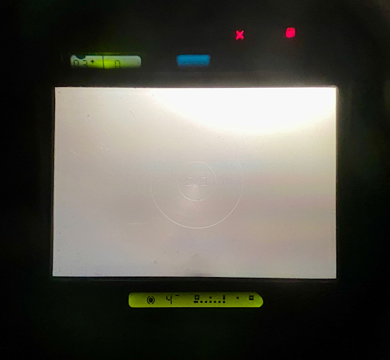

However, the LED displays have slipped up a bit:
The top left LCD is OK, I just couldn't get it all in the picture.

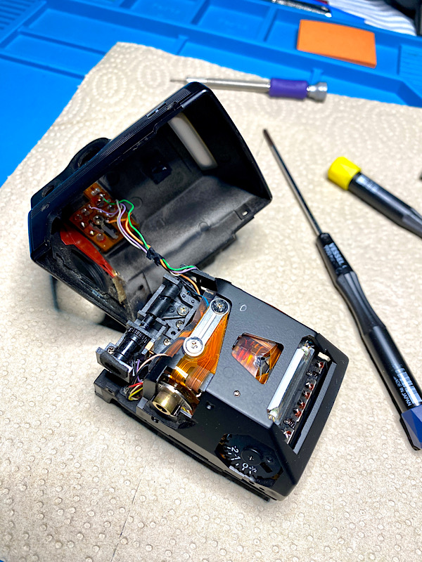

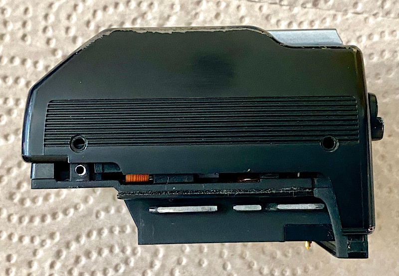

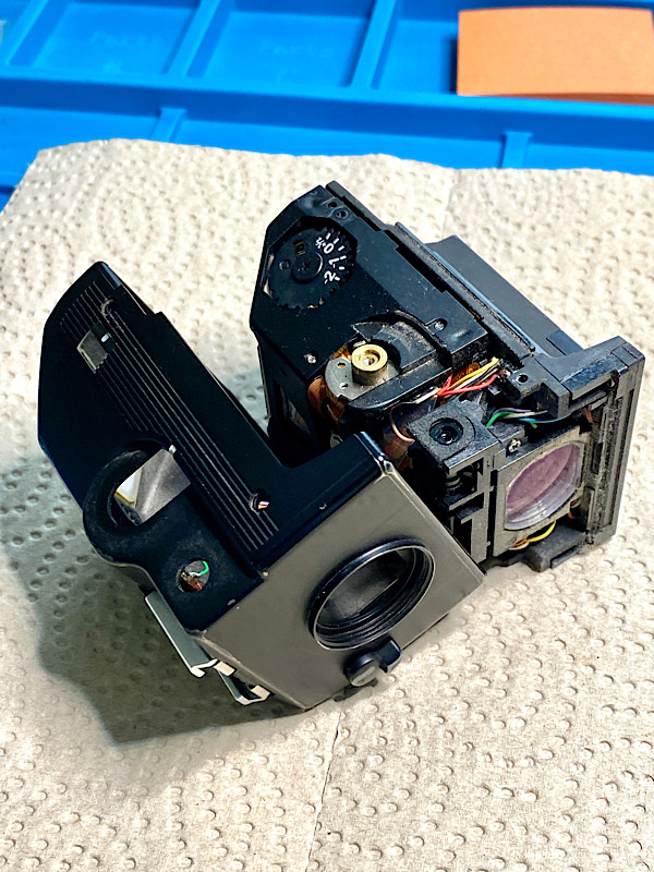

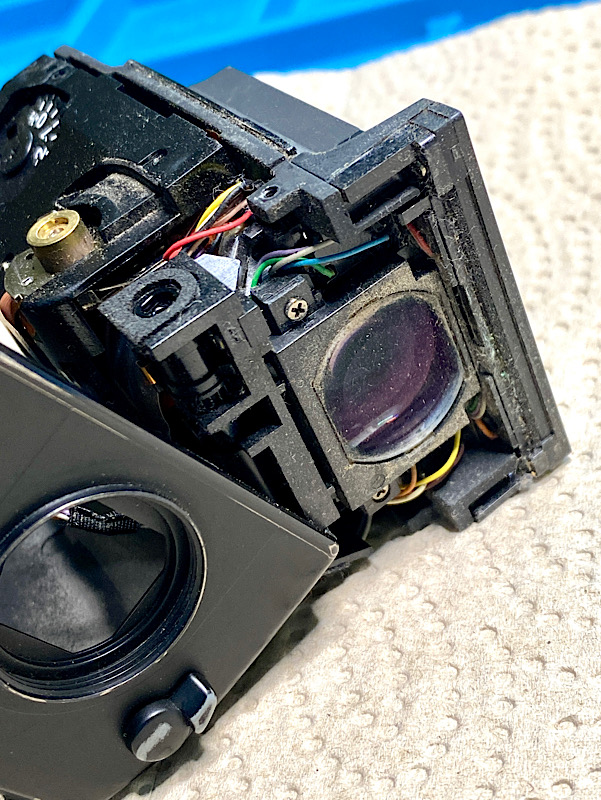

Removing the outer cover and loosening the inner cover.
The DP-20 has two covers that protect its interior. For details on disassembly see
This should be cleaned later.

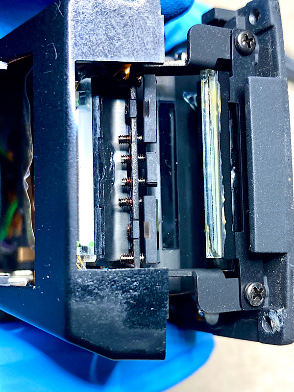

This is where the three deflection mirrors for the upper viewfinder displays are located.
From top to bottom:
  • LCD with exposure compensation and frame rate display,
  • ADR (Aperture direct readout) for reflecting the aperture number on the lens, and
  • the LEDs for AF, exposure compensation warning and flash readiness.
All of these displays are located in the F4 housing and are reflected in the DP-20.

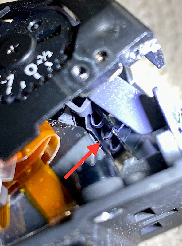

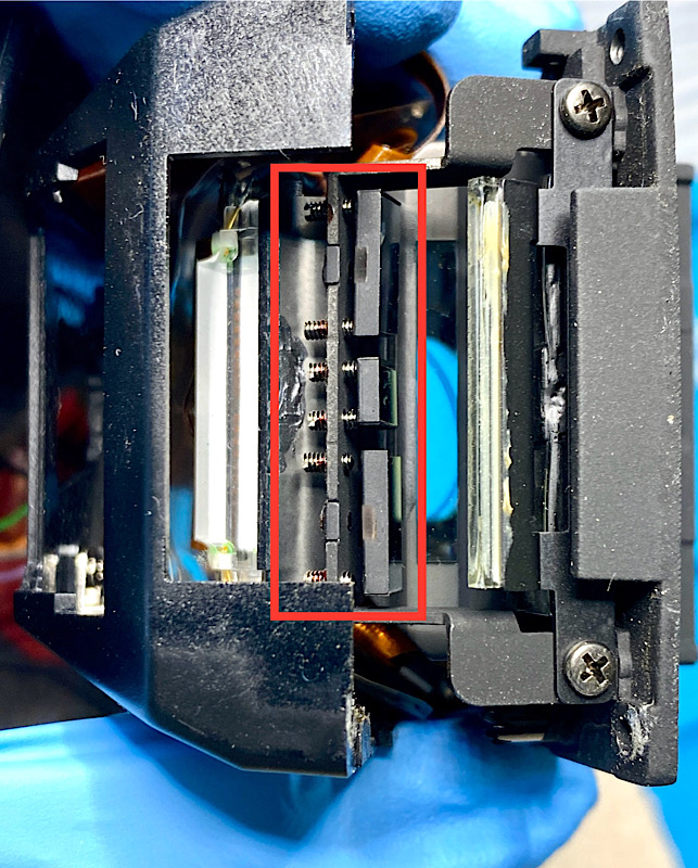

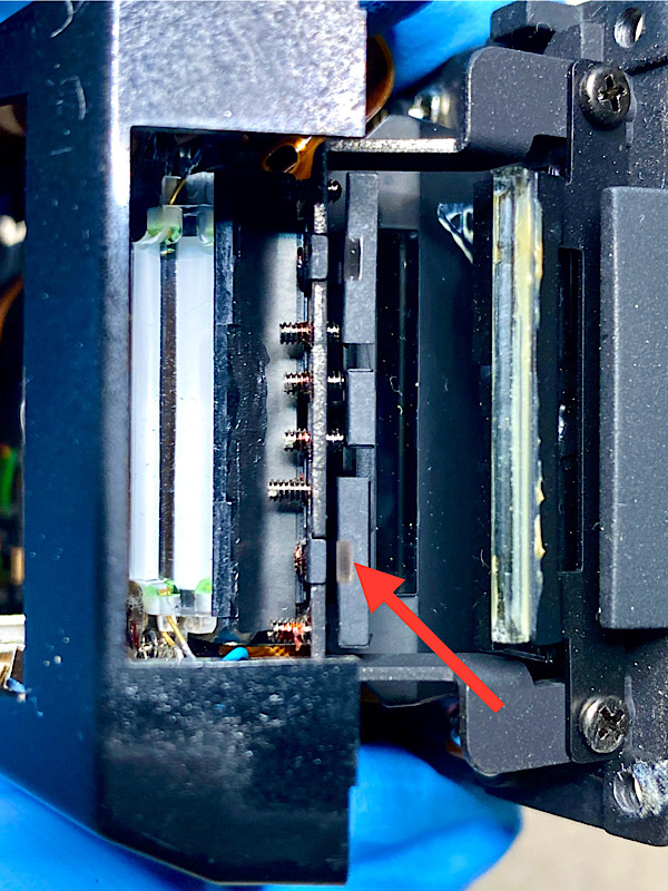

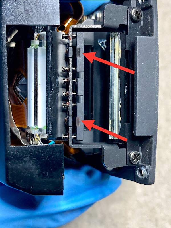

The mirrors are mounted on metal springs.

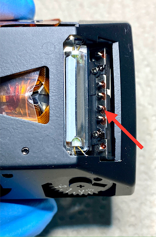

The metal springs press the mirrors against these adjusting screws.
Here you can see that the upper and lower mirrors are not in contact with the adjusting screws.
The misalignment was caused by the fall.

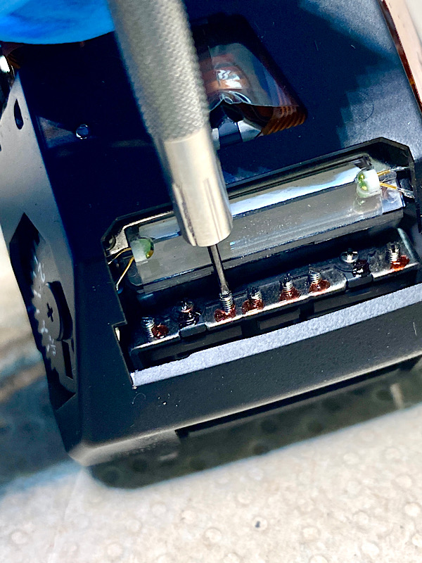

I unscrew the two adjusting screws for the lower mirror …
… and move the mirror on its metal spring towards the adjusting screws.
To do this, I take the blade of a flathead screwdriver and carefully press on the metal spring.
Now I can adjust the mirror against spring pressure using the screws.

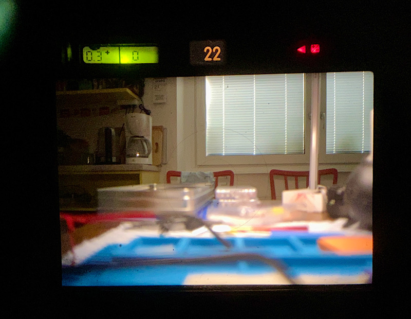

First attempt.
The red LEDs are now too low.
The LCD on the left needs to be corrected downwards.

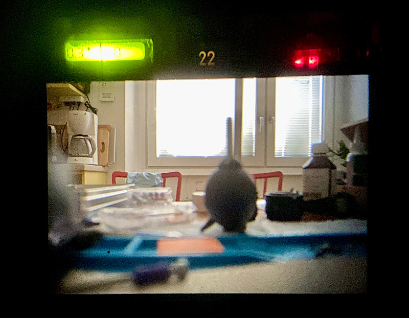

The reference is the ADR display in the middle. Its mirror was not misaligned by the impact because it is still pressed against its adjusting screws.
After I have adjusted the mirror for the LCD by bending its spring, I adjust it and the mirror for the LEDs using the screws.
After a few attempts, the positions are correct.

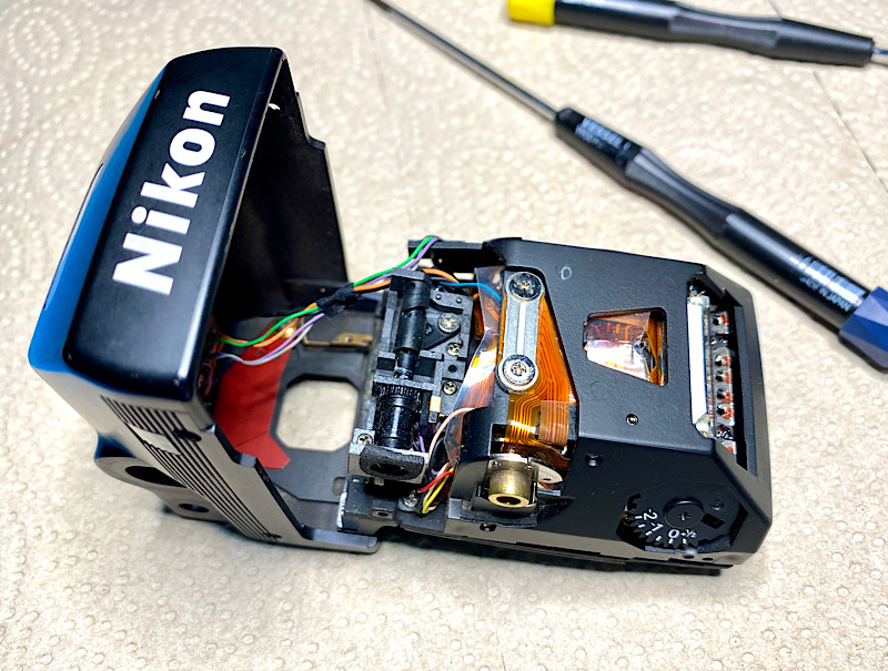

The outer cover is always in the way because it is connected to the viewfinder by wires.
In this position it is not in the way when doing this work.

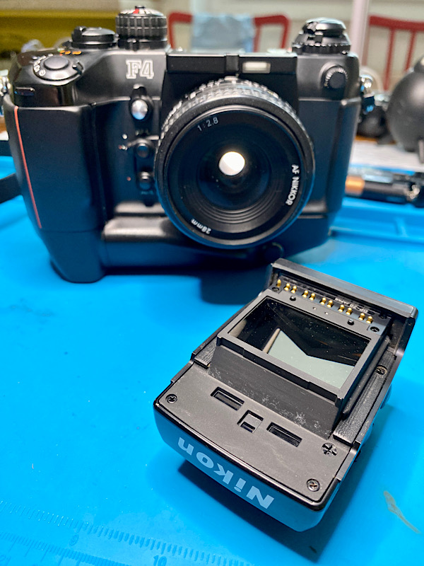

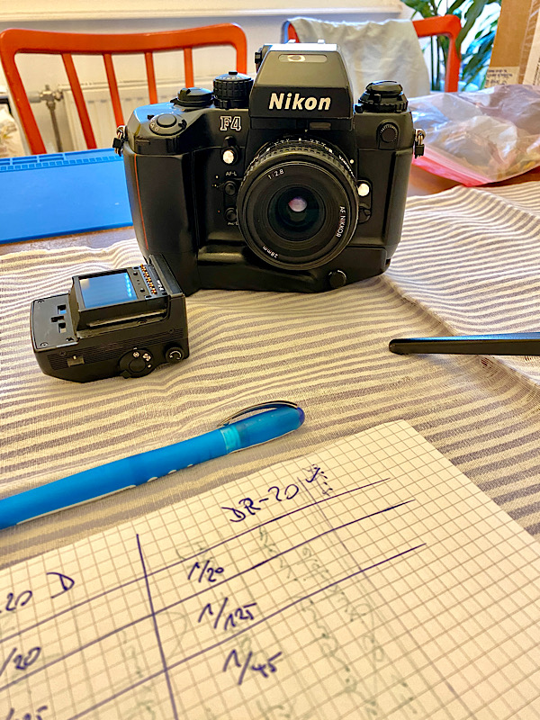

In order to be able to check the adjustment of the mirrors, the DP-20 must be set to the F4.
To do this, simply put the outer cover on without screws.

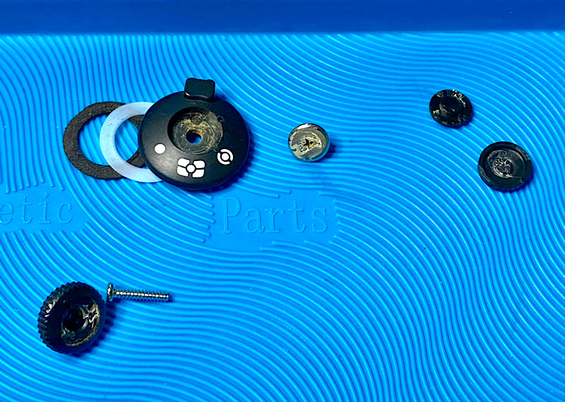

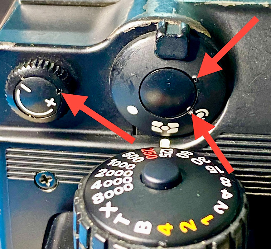

The buttons for diopter correction and measuring mode and their cover caps ready for installation.
The DP-20 is tested on the F4, everything works 👍
Actually, this DP-20 is too good to be used as a spare parts warehouse (LCD) because it works. The abrasion on its cover gives it charm.
I think it's impossible to pry the two soft plastic caps off the buttons made of the same material without leaving marks.
They are attached with some Pliobond.
But since I don't have any spare parts, unlike Nikon Service, that shouldn't bother me any further.

The LCD (seen in the viewfinder of the F4 on the bottom) has a bleed on the right that wasn't visible a few months ago. This may have happened because of the impact.

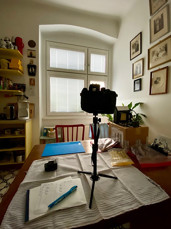

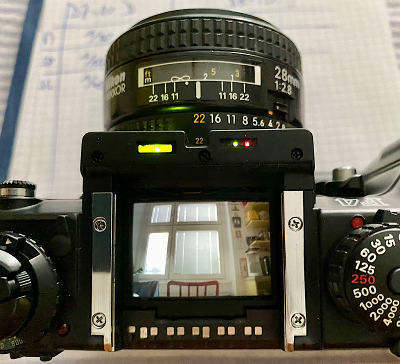

Quick test
I compared the DP-20 that fell to the ground with a second DP-20.
The F4 is on a tripod aimed at a bright part of the darkened window.
Aperture priority mode, ASA number and aperture constant.
Identical shutter speeds are displayed for both DP-20s in the exposure modes Matrix, Spot and Selective.
This means the test has been passed 👍

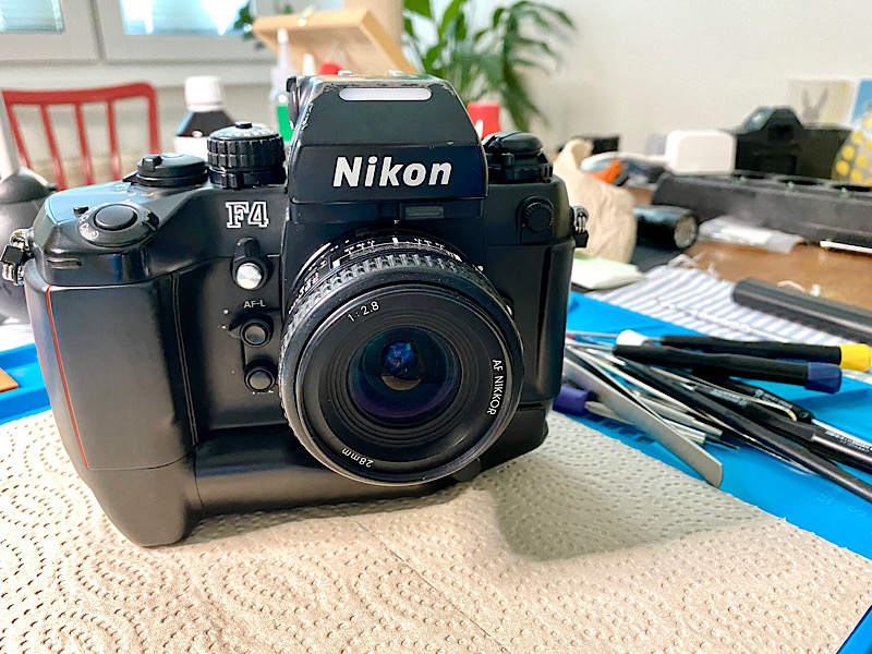

By the way, this is the F4 that I opened in April this year and cleaned and oiled the aperture control (the common problem of a lame aperture on the F4):
The aperture still works perfectly.
AF and exposure metering (spot metering) also work without the viewfinder attached.
In manual exposure mode, the upper LCD shows the exposure adjustment +/- on the left and the set shutter speed on the right.
