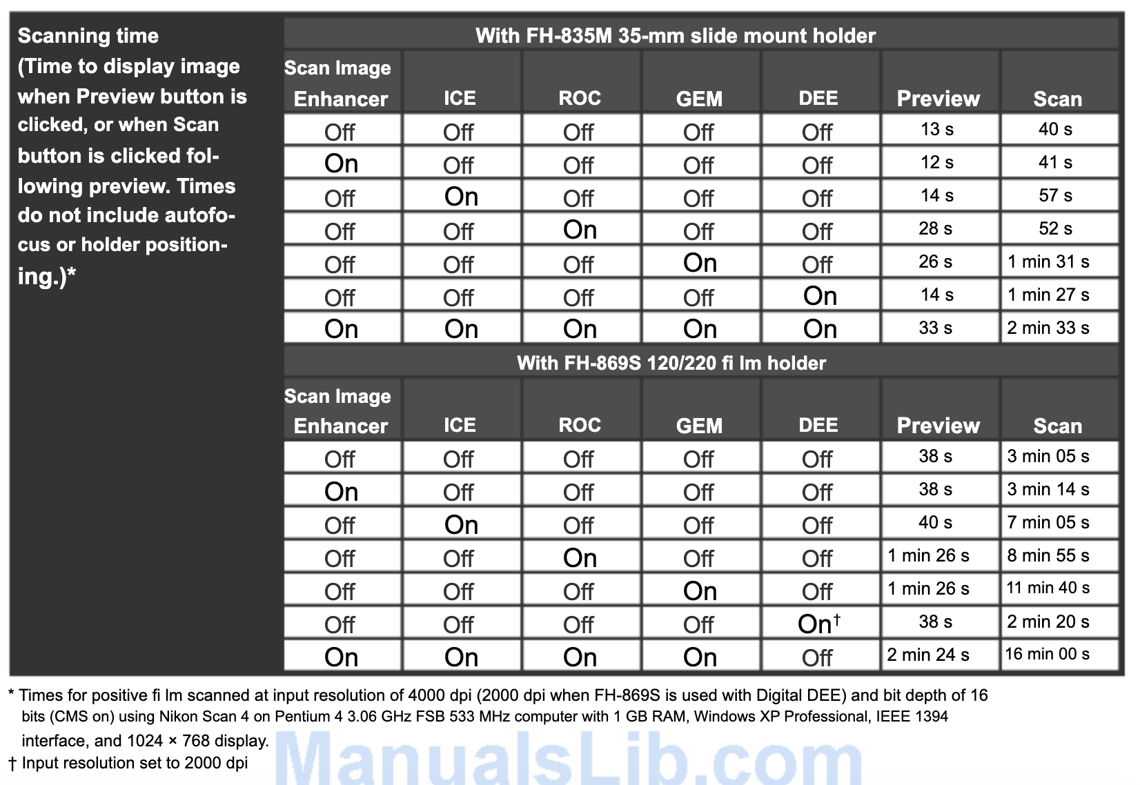

I didn't go into specifics as I was looking for a broad range of timings. I found a document (attached) that showed all scan times with each setting on and off for 4000dpi so was hoping that someone could point me in the direction of a similar thing :smile:
I would love to know timings for 35mm & 120mm at the lowest resolution with all settings off and all settings on, so i can get a better understanding of how long each film is going to take to fully scan. I will be using this for a new film lab so timings for this can determine what sort of turnaround we can offer :smile:

Another source of information:
https://www.photrio.com/forum/attachments/screenshot-2019-12-08-at-16-23-36-png.236015/
Scan 1 slide 4000 dpi with auto focus and auto exposure 1:05 min
Scan 5 slides 4000 dpi with auto focus and auto exposure 5:40 min
Scan 1 slide with 4000 dpi with ICE, auto focus and auto exposure 1:30 min
Scan 5 slides with 4000 dpi with ICE, auto focus and auto exposure 7:40 min
