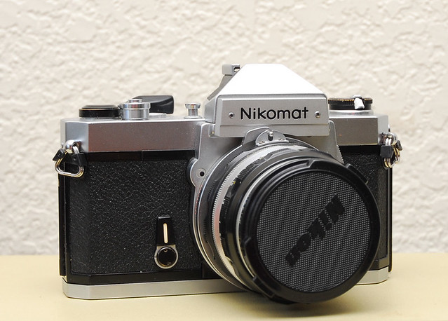

Flashman2000
Y'all have utterly confused me with the talk of batteries.
We're speaking strictly of the Nikkormat FTn which took the PX 625 mercury batteries, which were discontinued in the late 70's because they contained mercury. The PX 625 currently available at Radio Shack is an alkaline battery, and it worthless for this purpose. The voltage is wrong, and they continue to lose voltage throughout their life, causing underexposure when new, and over exposure as they die. The mercury battery held 1.35 volts throughout their life.
So, we're discussing replacements here to try to arrive at something that will hold even voltage throughout their life. A silver batter like the 357 starts out at 1.55 volts when new, dies down to around 1.4-1.5V shortly thereafter, then begins dying about halfway to 2/3 of its life like an alkaline. Alkalines are the worst. If you will research APUG, you will find where E von Hoegh has concocted a scheme to leave some holes covered on the 675 zinc-air battery to make it last longer. His is a good choice, although they give only 1.2 volts throughout their life, meaning the meter causes some over-exposure. But at least it is consistent throughout battery life.

Ok, I get it.
I just need the simplest solution. With the frequency that I'd actually use this camera, I just as soon buy a new battery every few years, since thats probably as much as I'd use it.
I typically reach for my gripped FM when I want to shoot manual 35mm.
$18.75 for eight 675s which expire with time once activated. So you use about $14 in batteries in a year (assuming you can get 2 mo. life out of them). After 4 years, CRIS MR-9 is more cost effective.

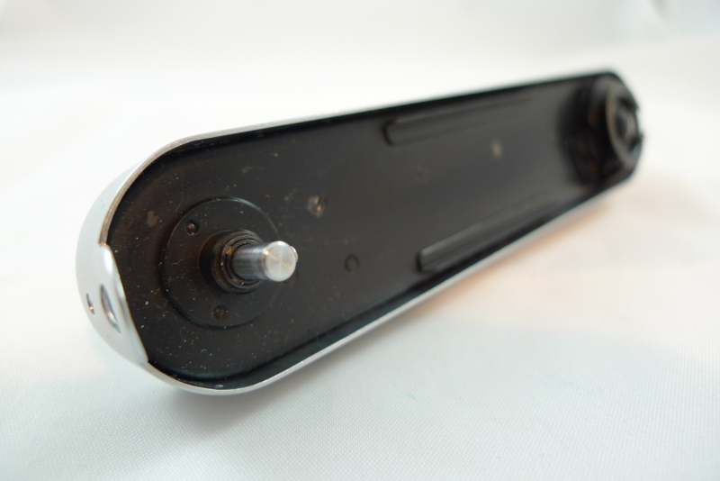

Best to pull the baseplate and install a shottkey diode in the red wire. Then, you don't have to buy the MR9 or hearing aid batteries. Just use a 357/PX76 with an o-ring. That's what I will be doing to the FTn, if I wind up keeping it after all. If not, then, I'll let the new owner decide what they want to do with it.
