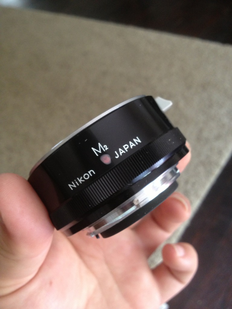

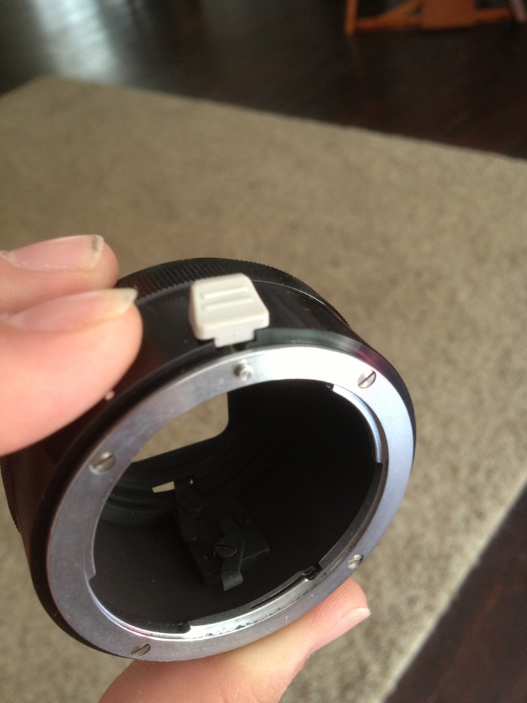

Is this a 2x teleconverter? I found it in the lens bubble for the 55mm micro.
If it came with the Micro Nikkor, it's undoubtedly an extension tube.
It is an extension tube. Which I'll probably never use on a regular basis, but may be fun to play with from time to time.
From my brief research, I think the M2 was made and sold specifically for the 55mm micro.

Without the tube, the 55/3.5 will focus from infinity to 1/2 lifesize. With the tube, it will focus from 1/2 lifesize to 1/1 lifesize, scales are marked on the lens' barrel for both (with and without the tube).

But no meter coupling right? So I'd have to use a hand held meter if I'm using the tube?

If you want. But you can use the built-in meter in stop down mode by holding down the depth of field preview button while metering. In this case move the meter coupling prong all the way counter-clockwise, I believe.. It's been so long I can't quite remember.
