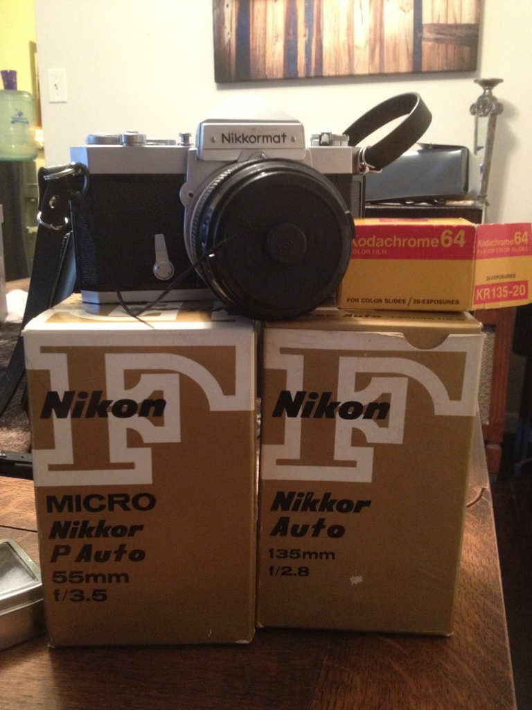

Someone have me this kit. A Nikkormat 35mm with a 55 3.5 and a 135 2.8. Everything has original boxes, and original plastic lens bubbles. There's also a roll if 1981 Kidachrome.
Aside from the film, what's all this worth? I've heard of Nikkormat but not used them. Are they Nikon knockoffs or what?

Actually Nikkormats were the prosumer camera of their day for Nikon, aimed at those who want to shoot with Nikkor glass but couldn't afford a Nikon F. They are sturdy cameras, as for current market value, I would look at KEH and Ebay to come up with a market value, I'll be honest, they are not expensive.

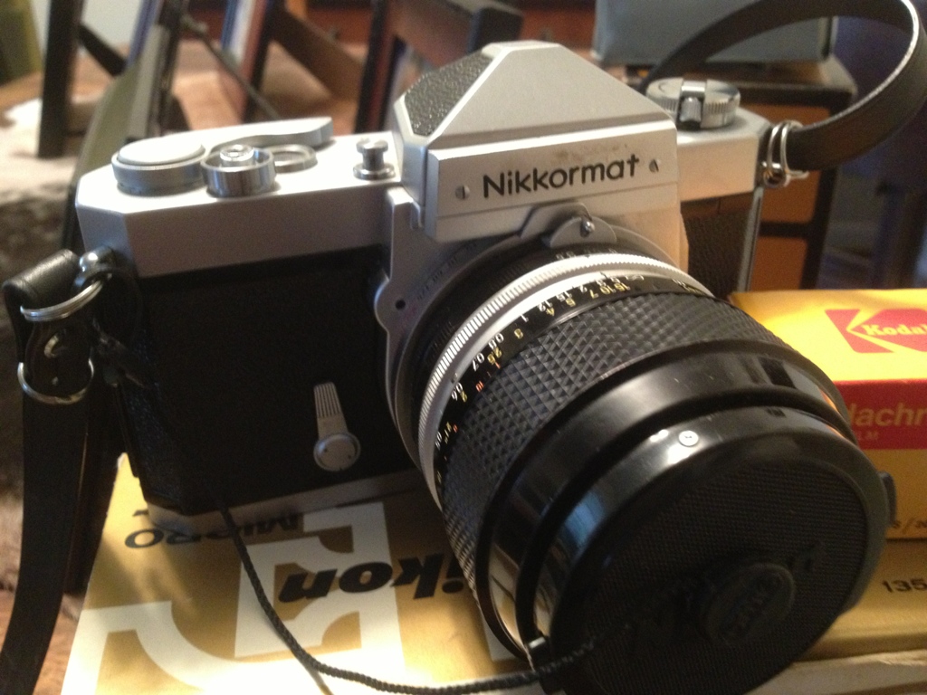

There were a few versions over time. Yours looks to be a FT or FTn as I see the pre-AI ring. The (later) FT2s use currently available 357 batteries. The older ones use the now extinct 1.35v 625 battery (as Tom1956 mentioned). A #9 o-ring works well around the 357 battery. Or use that same o-ring around a 675 zinc air battery for a constant 1.4v until the battery dies.

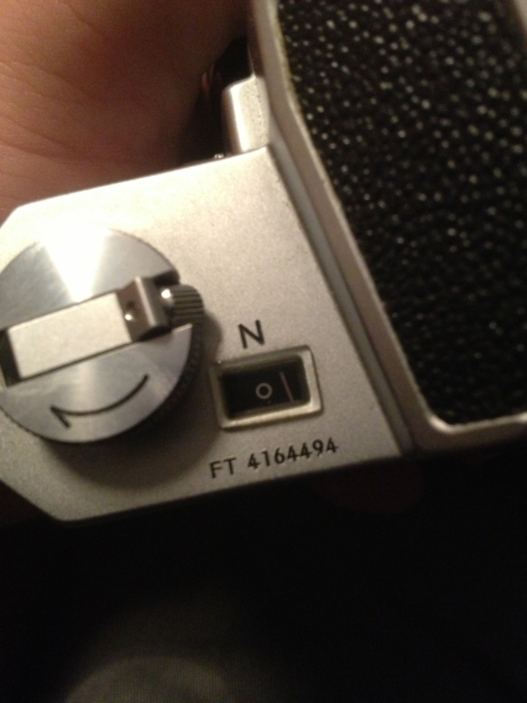

Would this be an FT or an FTN?

Those instructions are for the FT. With your FTN you need only set the lens to f/5.6 before mounting and do the "Nikon twist" after mounting, which is to turn the f-stop ring to the smallest opening, then to the largest. After a while, it becomes second nature.
