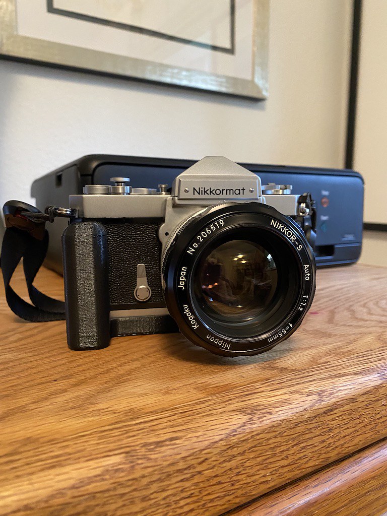

@madNbad since you're posting all these great pre-AI lenses, do you have the unique old 5.8cm ƒ1.4?

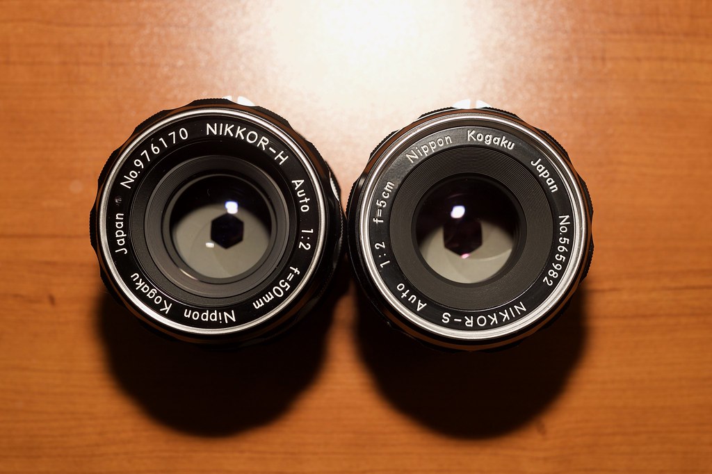

No. I never really liked the 1.4 and was drawn to the 2.0. I had a slightly older 50 S 2.0 that had the long aperture ring but wasn’t a tick mark. I also had a 105 with the long aperture ring, the bubble case and original box. The Nikons were fun, sold them all and am happy with a pair of Leica’s.

My 50/2 Nikkor-S is my only tick mark lens. It came to me with a Nikkorex F. I haven't used it yet. Any 50/2 Nikkor from the HC forward is very good. The HC is often found with dried up lubricant. I don't see any difference in performance between the 'K', the AI and the later 50/1.8 manual focus lenses. Of the 50/1.8s, my favorite is the first version. It has nice build quality.

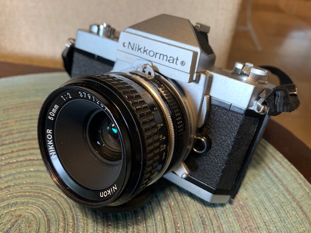

The Nikkor ai 50mm f2 lens arrived from Cowboy Cameras in Dallas. It looks to be in perfect condition. Very light easy focus. But, you know...it feels a lot like my Nikkor AF 50mm f1.8D albeit with a better-placed focus ring. I'm looking forward to using it on the FTn.

A photo of the lens on the camera would be great 😃
I love this stuff
Ok. First I had to figure out how to mount it correctly.)) It would be interesting to know when it was made, but it looks brand new.
Now you are well on your way to enjoying one of the very best 50mm lenses ever built.
I too had and used a Nikkormat FT2 with this lens which I bought new in 1975.
I now have 2 of these lenses which I use over any other 50mm.
High praise indeed! I'm eager to try it out. Now I have to get off my butt and install new seals in the FTn.
The secret to getting the best performance from this lens is to use a hood.
Hmmm. I'll have to check to see if the one on the 24mm lens will fit. I don't think I have another one. The lens seems recessed quite a ways and I thought that would be sufficient.
This one won't do. A standard 52mm collapsible rubber hood is sufficient.
This is the last version of the 50/2 lens Nikon made, so with the latest coatings it'll probably have the best performance of any version from the series, which is saying a lot.
You'll probably be OK without a hood, unless you do a lot of shooting into the sun, but it's not known to easily flare. Hoods are always a good idea, though, as they can also protect the front of the lens from banging into things.
