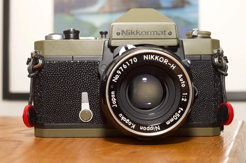

Here's a mid run silver nose 50 H 2.0 on a FT2 frankenmat. It was cobbled together out of three broken ones and painted OD green. It was fun but the meter tab wasn't smooth and the meter was jumpy:
