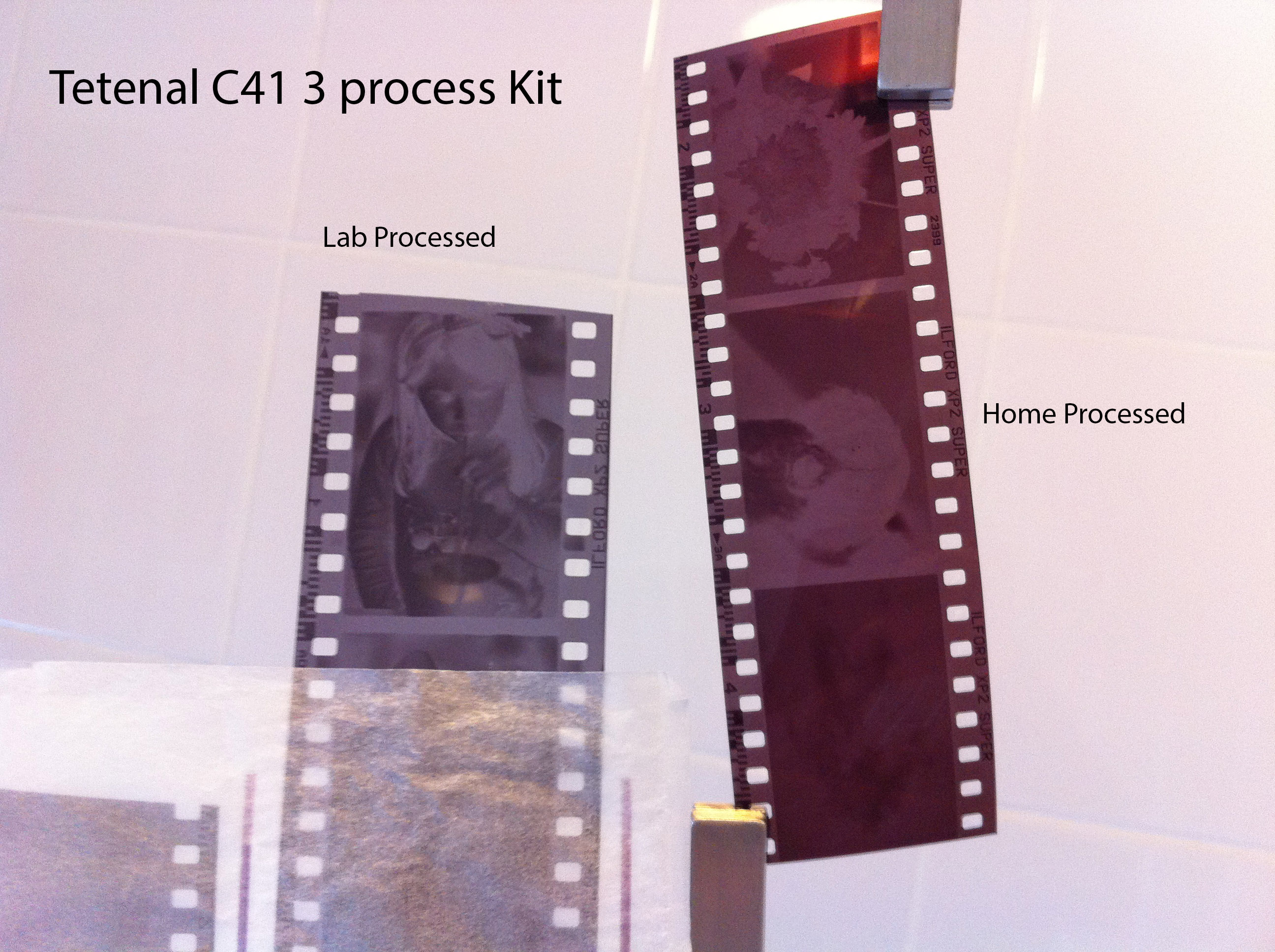

Hello all, I have just joined and this is my first post, typically it's a disaster and I need help please.
I am new to film (technically I shot film at college in 1990) but since then haven't done anything until recently. Been very digital until the theft of my entire digital equipment so I decided go cheap and get a film camera.
So I just bought a Canon FTB for £5 and bought a Canon FD 1.2l 85mm with it for £200. Bargain I thought. The battery in it is a hearing aid battery and I have been compensating for it by attempting to over expose as I shoot. I have been using Ilford XP2 as it's still available in the shops where I live and is 400asa. I checked the meter with my iPhone and wifes camera and it seem accurate enough. So I went out shooting.

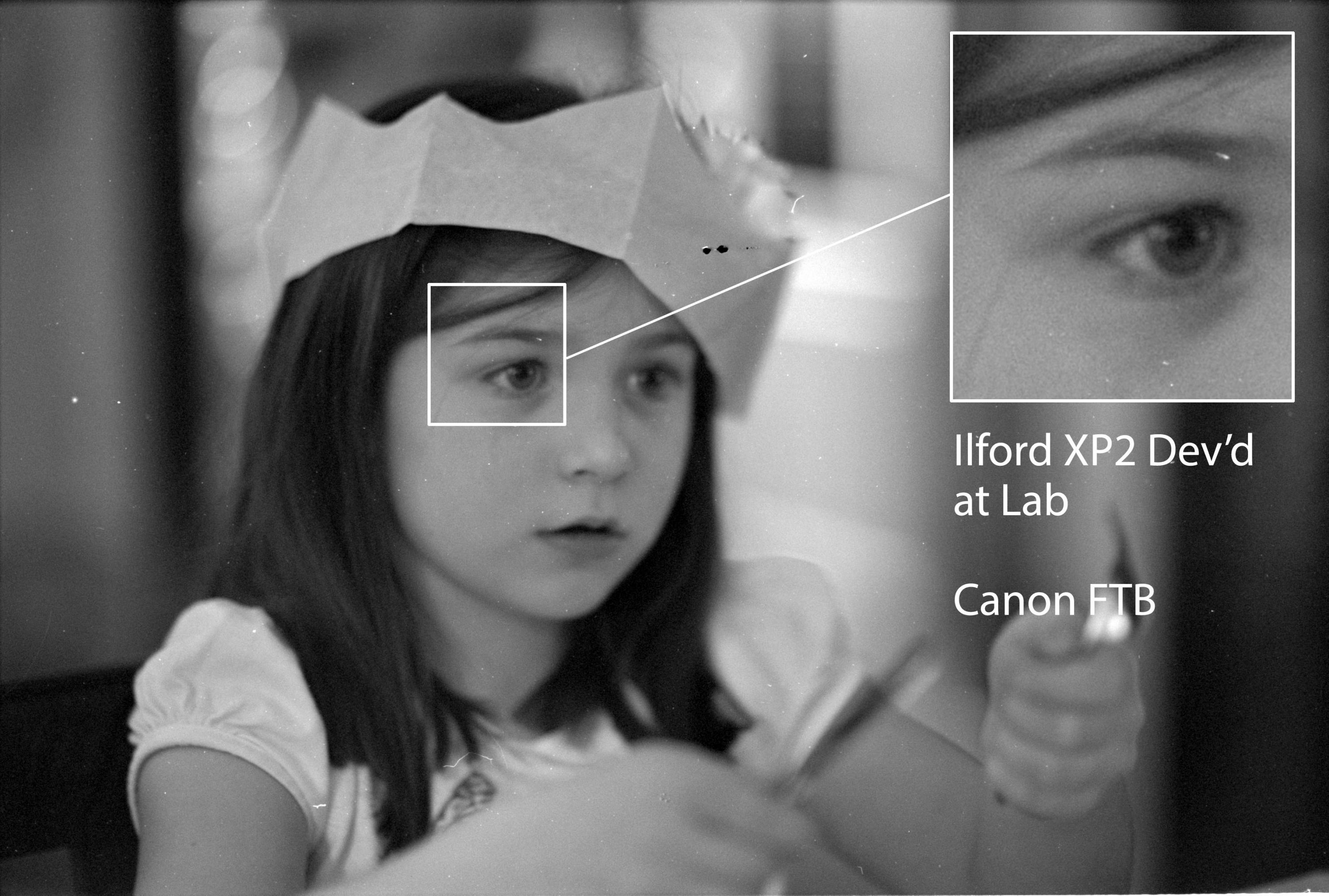

I took my first roll to a lab who promptly put scratches all over it and told me it was my crappy camera.
Upset with the attitude of the lab technician I decided to develop the next roll myself, well, how hard could it be?

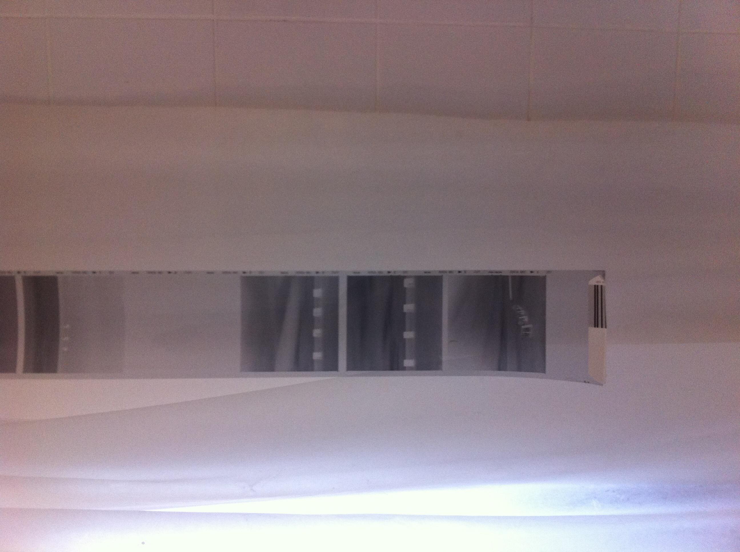

I got a dark bag, got an iPhone timer app, spool and patterson tank etc. Didi all the usual spooling of the film etc. and started developing.
Although my roll did not have scratches on it it did have a lot of residue on the glossy side and is for some reason magenta where the lab's is grey. Plus a stupid amount of grain compared to the labs version, though all of the shots look a little under exposed.
I have had a look at some other posts and it suggests the issue I may be having is either, temperature of developer, too much agitation, not enough agitation, over developing the film, shutter timings, bleach exhausted and some others I can't now remember.
The tetenal C41 kit I bought is apparently 3 bottles worth, Dev/Bleach/Fix and there is mixing of the Bleach and Fix(stabiliser)
I have now tried with 4 rolls of Ilford XP2 and different times of the day, while adhering to the 38 degrees, 3.15 minute developing time, the thermostat is new I have wet the film on two of the rolls to heat it up prior to developing, nothing seems to make a difference.
I haven't tried the 86 degrees longer time developing yet.
Any clues at what I am doing wrong?
I don't want to waste any more film but I also don't really want to use the lab again because paying for scratched film is not my bag either.
Thank you in advance at helping an idiot home film developer.
The Tetenal kit indeed gives you three processing liquids, but their correct description is quite different:
  • CD, i.e. Color developer: mixed from CD1, CD2 and CD3 parts and water
  • BLIX, i.e. bleach and fixer in one: mixed from BX1, BX2 parts and water
  • STAB, i.e. stabilizer: mixed from STAB part and water
Please confirm that you indeed mixed the liquids as listed here, not as you described it. If not, we may have found the problem right there ...
Different C41 developers are as a rule interchangeable so there should not be a great deal of difference. I see what you mean about the increased grain though. I am not and never have been a lover of XP, I always found the colour mask intrusive. How the lab managed to get rid of it (if that's what you mean) and get a grey background this may have something to do with the grain size, I just don't know. The magenta backing is there so it will be able to be printed on a standard lab printer.

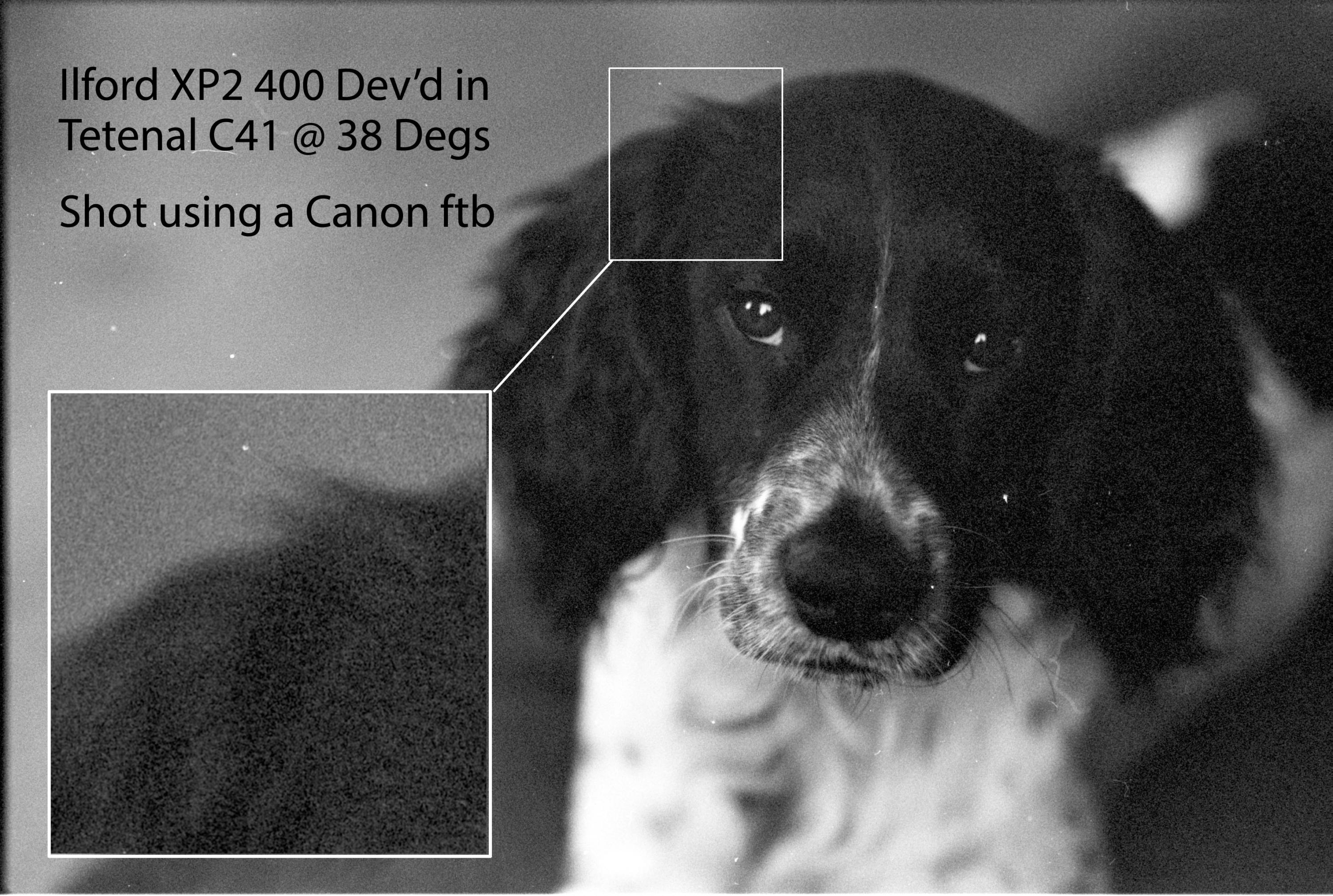

Regarding the OP's problems with grain and neg colour. Agitation is unlikely to be too high, as the film is expected to be developed in either a roller-transport processor or in a Jobo system with continuous agitation. Are you carefully controlling the temperatures of all the chemicals, not just the developer? A lower temperature for the bleach or fixer might lead to under bleaching/fixing (with either possibility leaving silver behind and potentially causing a dense and grainy appearance). Double check that the various component bottles were mixed correctly too of course.

Hi filmnumpty. If you conduct this simple experiment, you may be able to answer your own question. Simply repeat the whole process just as you did before, with the reel in the tank, but no film. Instead of chemicals, just use water at the correct temperature for each step. At each step, measure the temperature of the water that you pour from the processing tank. What I think you will find is that despite the temperature of your water bath, the actual process has been carried out at a lower temperature than expected and the result is an under developed and under bleached/fixed film.
The volume of chemicals you are using, plus the short process times, mean that it is very easy to run the process at a low temperature, especially if you are using a plastic tank. A prewash may help (some kits recommend this), but you may find that you can get good results by starting out at a higher temperature and running the process so that the average temperature correct. Experimentation is the key to getting this right.
You may find that the colour and graininess of your already processed films can be improved by bleaching, fixing and washing again, but that is just me guessing. No harm in trying though!

Hi. I shoved in the temp gauge into the patterson bottles while developing, bleaching and fixing. I attempted to get the temps at 38 for the dev and bleach, the fixing apparently is more liberal.
I think I may have found the source of my problems.
I have just tested the thermometer I bought and it is 1.8 degrees lower than it should be at boiling temp.
Tested in conjunction with a glass thermometer.
Plus I noticed the used bottles I bought from eBay also have crystals left in them from a previous chemical. I cleaned them out prior to making the Tetenal Mixture but I may not have clean everything out.
That coupled with the lower reading of hearing aid battery in FTB would make for underexposure in both the camera and the developing.
I will correct these to see if that makes a difference.

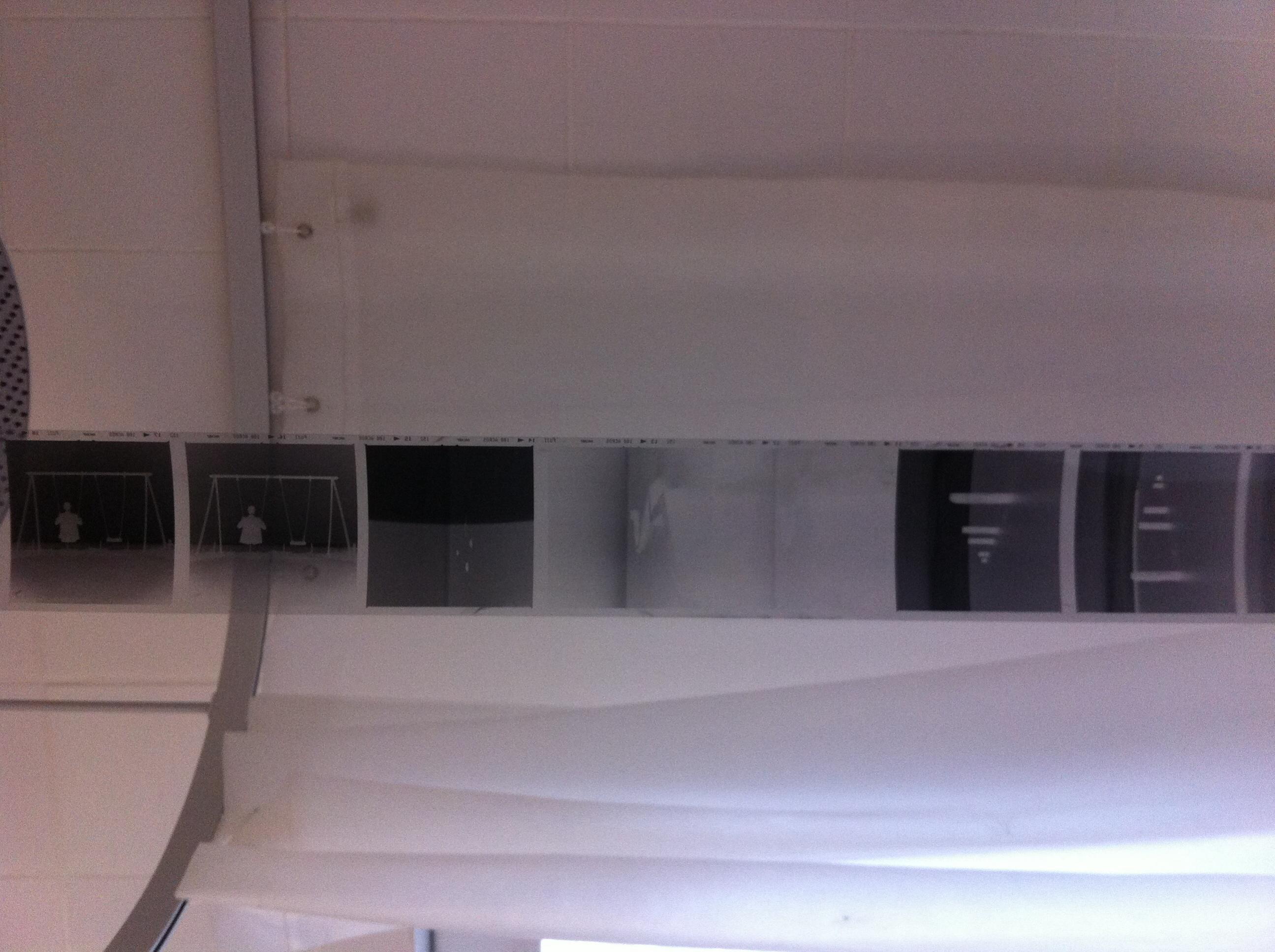

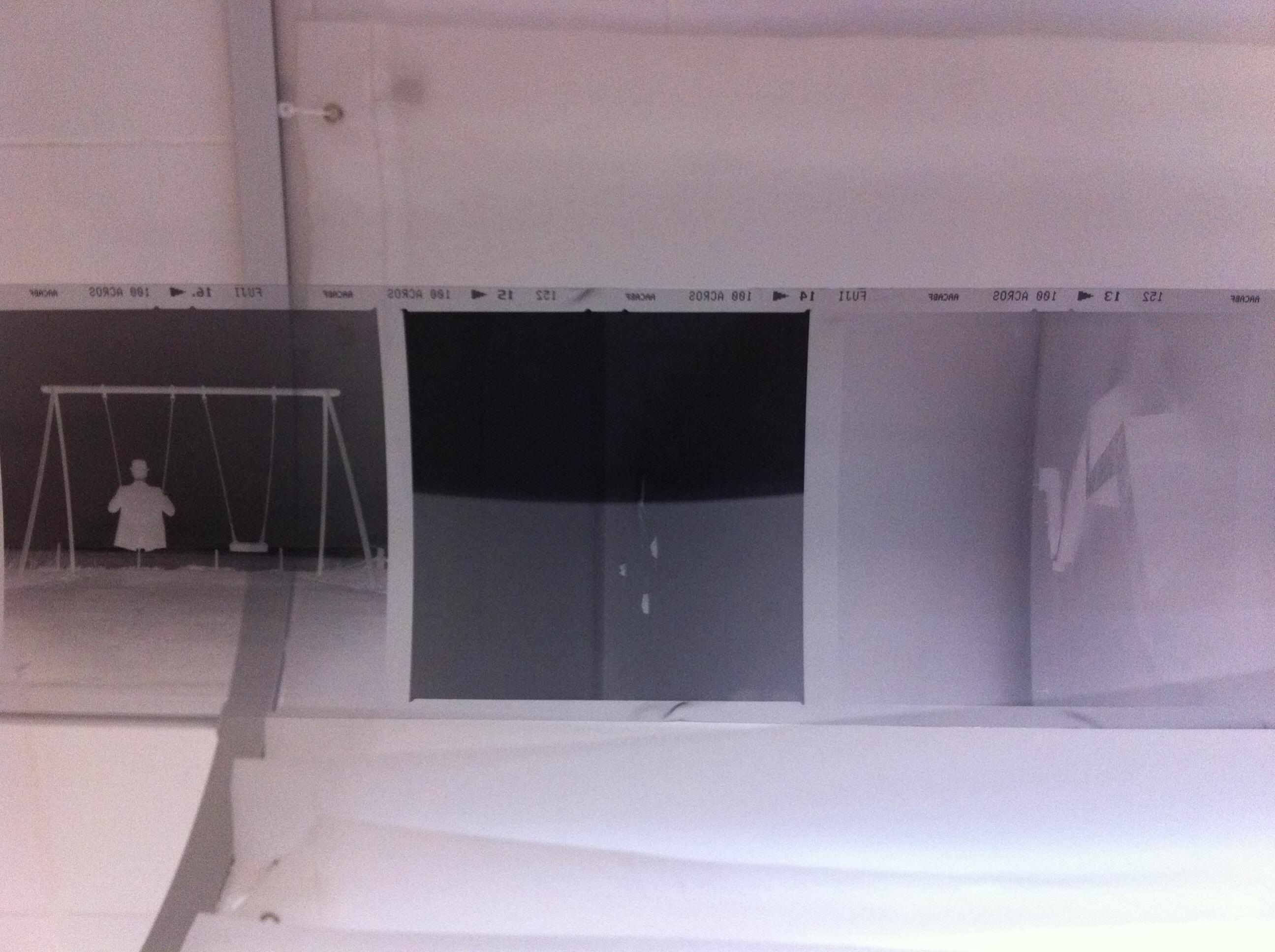

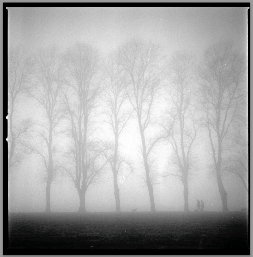

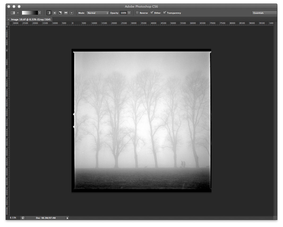

here is what the film looks like.
it is a lot grainier than I was expecting, the film itself feels really thin and some parts did not even develop. Plus the shots are soft too. I have an Epson 750 and have scanned in lab developed shot so I know it's not the scanner. Or the camera or lenses.
i'm doing something fundamentally wrong and it's really upsetting.

If the image on the negative is unfocussed, or blurred in other ways, it has nothing to do with the development - it is an "in camera" problem.
If by "soft" you mean that the contrast is low, that can be adjusted for in both exposure (including lighting) and development.
And the parts that aren't developed? That happens when the film isn't loaded correctly in the reel.

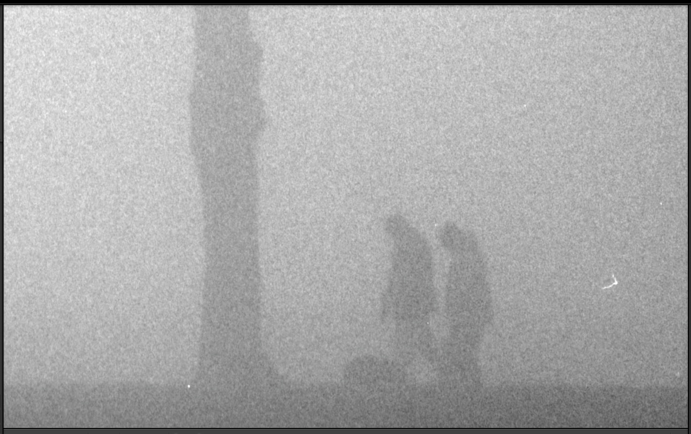

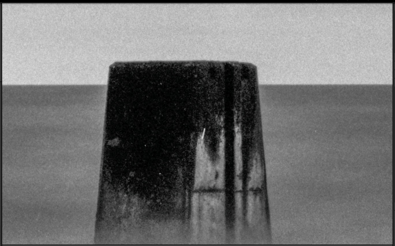

Here are some pics which may illustrate my problem.
It seems like I have no contrast in the shots. Developing issue or me just being the worst photographer/developer in history?

Well ...
The Top example looks like it was shot in the fog, which will generally be low in contrast.
And the second example is probably under-exposed.
Correctly developed negative film has a lot less contrast than the original scene, and the scanning/printing step restores the original contrast. This is a good thing, because it gives us plenty of dynamic range on the film, although the material can barely cover a density range of 2-3, but scanners really struggle with this low contrast and create lots of extra noise. And since most scanners make some attempt at auto contrast, you can not judge negative contrast from the scans unless you use the densitometer function of your scanner software.
