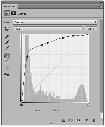

wonder if there's a better ('accurate') plugin for curves.. what I get after calibration is:
hmm.. dont know about that, like you say the curve shown in your previous post is quite aggressive.

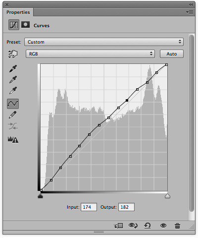

here's the first pass at a step wedge processed on the z3100. It's been a fairly typical curve.. both on an epson 7600 & the hp z3100 (not using QTR for the Epson).
It has always been a struggle to get really delicate high key and low key images... that curve making posterization really hard to avoid.
The first pass at the hpz3200 using the digital negative printer profile discussed here , gives me this curve
i am a *VERY* happy printer.
